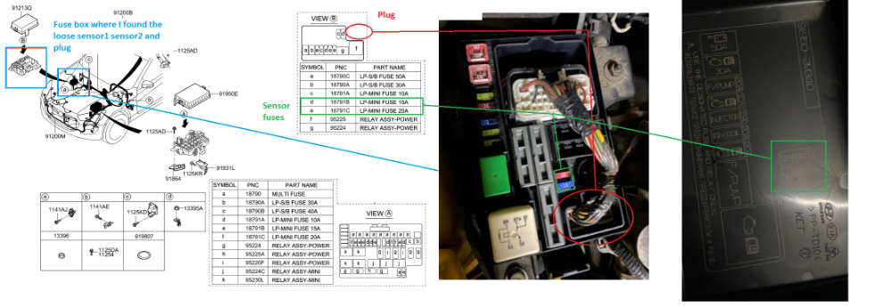

1 year 10 months ago - 1 year 10 months ago #67205 by christian300592
If the unplug it test isn’t fruitful, you may be having a power problem (think relay failing). I pulled a diagram on my laptop saved ready to upload here whenever I finish up here at this dealership but got a couple other cars to deal with. In the meantime, when it acts up and stalls don’t touch the key and just leave the key in the same position you try tapping on the relay that powers the PCM. If you don’t get 5v ref back use a test light at the relay and see if you have what you need there to make the relay work.
Do you have a scan tool that can read enhanced data? Does it become a no com, when it stalls out? (I would assume it’s a no com) Monitor the ignition switch if possible. I’ll be able to help better once I can dig in and upload the diagram (seems like a fairly simple circuit)
Just want to thank you! It's funny how someone from almost 5 years ago could finally help me fix my months and months long problem!
Bought a car on January. Come february it showed a P2138 code and for 2 months all I had to do was cycle the key and it would be fixed until it didn't. from then on until october, I would lose 5v on APS1 and have P2122 with P2138 sometimes, go into limp mode and engine cuts off at 2,500 RPM where it stutters until you upshift. getting to 6th gear I can just run it at 2,500 rpm max and 70mph max. so, I replaced the TB and the Accelerator Pedal because the sensors were built it. Nothing changed! Went to 6 shops and the dealership in the span of a few months. They checked mechanically and electrically and said that everything was how it should be. Until today while coming home I came across this post and tried to check the relays and fuse box. Turns out a plug was loose but was still making a connection somehow (and maybe the 2 sensor fuse as well) so I just pushed those down hard and viola! The plug went down significantly so I think that was it? problem fixed! almost sold my car at a significant discount! Thank you!!
2013 Hyundai Genesis Coupe 2.0T with P2122 P2138 Throttle/pedal Position Sensor/switch "D" Circuit Low
