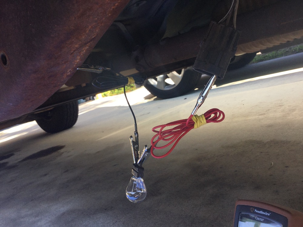

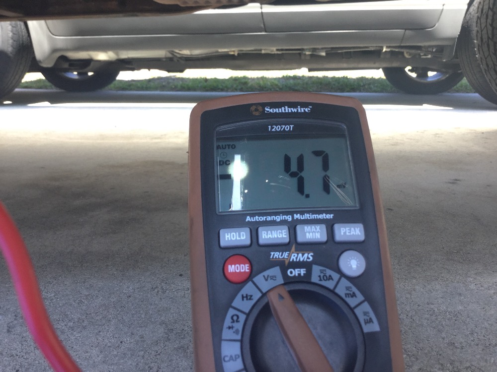

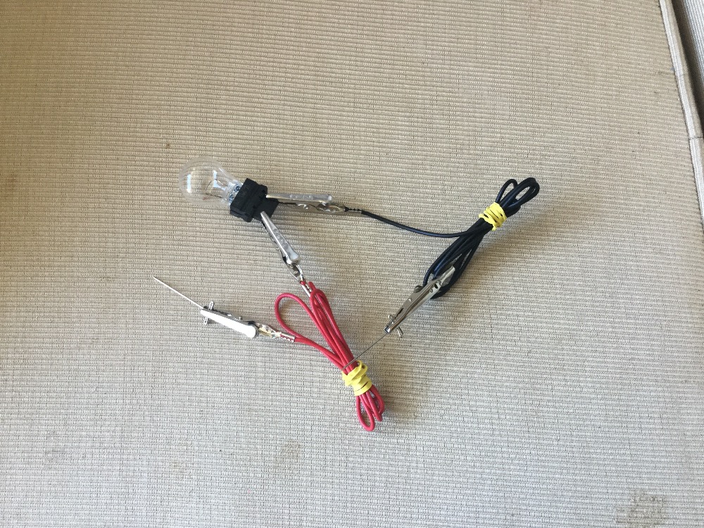

Alright made my little lightbulb rig , which is the first photo. I can get it to light up if I connect both ends to my dewalt battery
This is how I hooked it up, turned the key on, and attached one end to the Grey wire terminal and the other to a clean body panel. It didn’t light up.

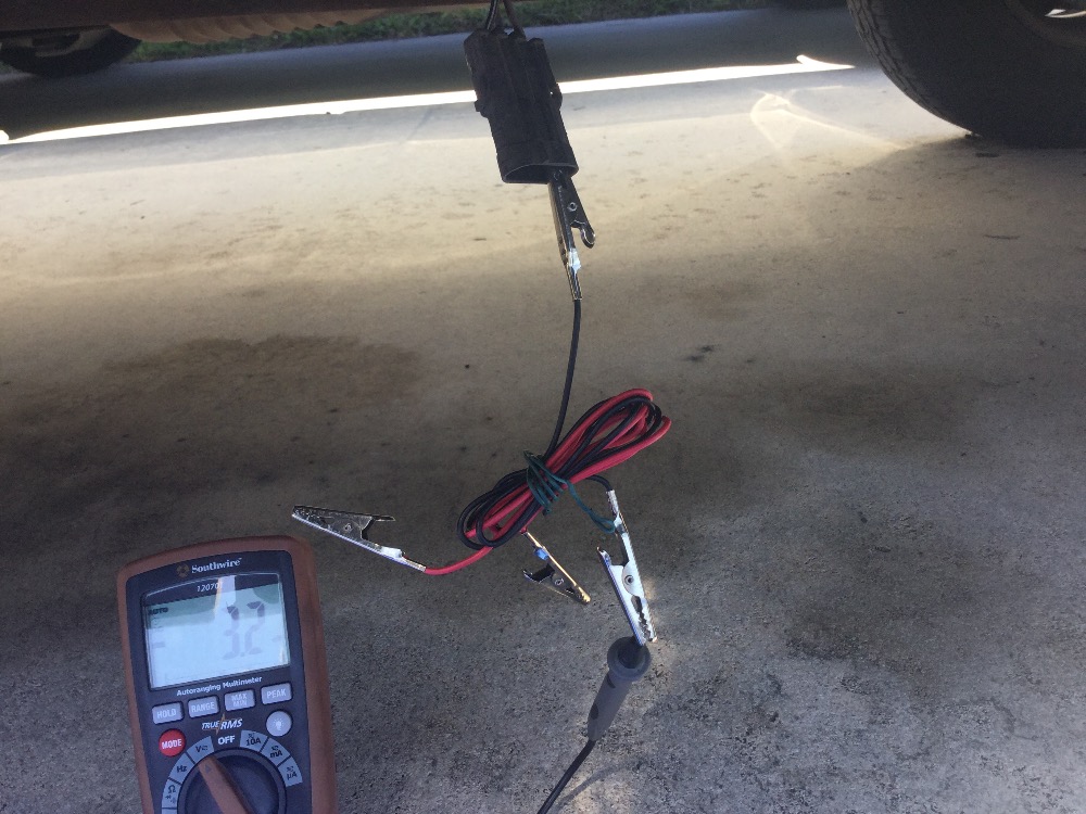

Then did the exact same with my multi meter and got this
Checked the battery with my meter and it’s got 12v. I’ll be here all day, weather is beautiful

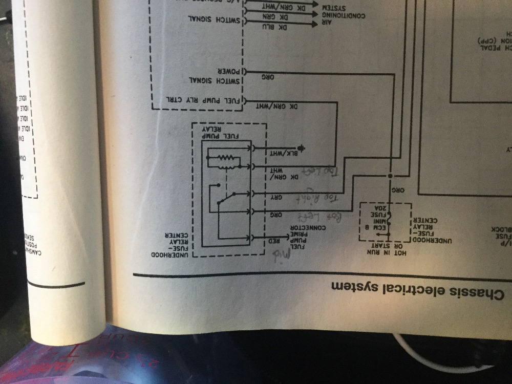

According to my Haynes Manuel, the grey wire is the power coming from the relay. I don’t think we are getting power back there. I’ve tried a ton of different grounds, and can’t get the bulb to light. It lights fine off my battery
Wait a min, the multi meter test I did was checking voltage... reading 0 meaning no drop, meaning either that wire isn’t getting power, or it’s grounded out. Right? I’ve been studying the premium videos every day!

So I just checked my relay, the bottom left (orange wire relay #87) gets power wth the key on
Shouldn’t the top left (dark green / white) wire get power as well since the ground is on the other side?
Or does it work like this
Orange is hot with key on, ready
Once I crank the engine, dark green white get power closing the switch, now orange flows through to grey down to the pump. That’s how it looks on here
I feel like I need to check that ground, black/white. Anyone know where it goes? Or how to check it

6 years 5 months ago - 6 years 5 months ago #39931 by Chad
Replied by Chad on topic 3rd Fuel Pump in a year?
stylingpat wrote: Or does it work like this
You got it. :) That is how it works.
The relay should send battery voltage down the grey wire to the pump. If you are only getting 3.2v-4.7v, at the fuel pump, then that is your problem.
Check voltage on the grey wire, at the relay. If you have battery voltage on the grey wire the relay, but only 3.2v-4.7v at the pump, you have a problem with the grey wire. If you have battery voltage on the Orange wire, at the relay, and only 3.2v-4.7v on the Grey wire, at the relay (when closed), then you have a problem with the relay.
If you can, try to use the same ground source for all of your voltage readings. A pair of jumper cables might help. (You only need to hook up the Negative, and use that as your ground.)

6 years 5 months ago #39959 by Hardtopdr2
Replied by Hardtopdr2 on topic 3rd Fuel Pump in a year?
The voltage was in millivolts on dvom. If the key is turned on he will need to look at the bulb / multimeter at that same instance key is turned otherwise pcm shuts it back off. Only other way to do it is jump the relay terminals for the fuel pump feed and test power and voltage drop
