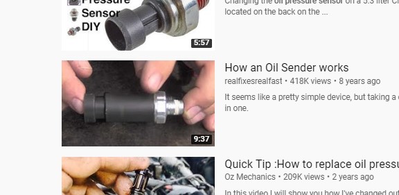

Oh and BTW the oil pressure sensor that ties into the fuel pump, I've replaced it a few years ago. I remember this thing. And my oil pressure reads normal and fine.
