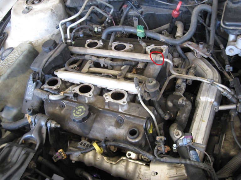

No fuel rail pressure was created by Donnyten
Getting 0 psi on the fuel rail Inlet. During reassembly I accidentally stripped the threads in the fuel Inlet pipe where the big bolt screws in. Would this big bolt not being screwed in all the way affect fuel rail pressure? The rail is getting fuel and there are no leaks. The gauge is reading 0 PSI. I know the gauge works because I tested fuel rail pressure before I redid the gaskets on my 3.1 GM 2000 Chevy Malibu. Needless to say the car isn't starting
How important is fuel pressure when starting the car? The fuel rail is clearly getting fuel yet I'm getting 0 psi.
Getting spark and compression so it's leading me to a fuel issue
I did change the crank position sensor because it broke off when doing my timing cover gasket. But I am getting an RPM signal so that lets me know that the ignition is doing its job on that front.
EDIT: let me also add that the inlet rail is secure, as I heard the O ring *pop* into place. So how could the retaining bolt affect pressure? The fuel rail bolt only screws in about 1/4 Ways in. After some brief research pressure seems to be critical in starting. So this seems to be my issue.
I anticipated either having to replace the fuel rail and fuel Inlet line due to a potential leak which doesn't exist or other problem (such as this one)

9 years 9 months ago - 9 years 9 months ago #5335 by Tyler
Replied by Tyler on topic No fuel rail pressure
Donnyten wrote: 0 psi. fuel comes out the valve. I'm going to rent another gauge from Autozone just to he sure though but last Checked psi was in spec. Prior to gasket changes
Pressurized fuel comes out of the valve? :huh: Then I think you're right to doubt your gauge. Let us know how the next gauge does?
Just to be clear, this is the fitting that got damaged, right?
Last edit: 9 years 9 months ago by Tyler.

9 years 9 months ago - 9 years 9 months ago #5336 by Donnyten
Replied by Donnyten on topic No fuel rail pressure
Yep. Gonna report back once I getta 'nother gauge. And yes. That fitting, and bolt, are more or less damaged right now. We're talkin' shredded aluminum damaged.
Screws in about 1/4 ways and stops. But line is 'in there'. If that makes any sense
Last edit: 9 years 9 months ago by Donnyten.
9 years 9 months ago - 9 years 9 months ago #5338 by Tyler
I gotcha! I figure there's gotta be SOME kind of connection there, otherwise we wouldn't see fuel at the other end of the rail.
The GM adapter in my pressure test kit is kinda janky - the little nipple in the adapter is bent, and occasionally won't depress the Schrader valve when installed. Possible that something similar happened?
I guess if you wanted to confirm a fuel delivery problem while you're waiting for AZ, you could add some carb clean to the intake? See if it at least fires.
