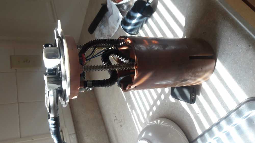

9 years 8 months ago #5416 by Tyler
Replied by Tyler on topic No fuel rail pressure
Kinda sounds like the impeller came loose of the pump motor... You could confirm this by dunking the pump in fuel and manually applying power and ground (in the correct polarity) to the pump. Carefully, of course. ;) Be fire safe, keep any arcing away from the fuel vapors.
If the motor spins but doesn't move any fuel, then it's pump time.

  • Donnyten
  • Donnyten's Avatar Topic Author
9 years 8 months ago - 9 years 8 months ago #5418 by Donnyten
Replied by Donnyten on topic No fuel rail pressure
Can a less flammable Source be used? Can I use water?
Also am I supposed to momentarily power the unit? ( not leaving power and ground connected for an extended Period Of time)
Last edit: 9 years 8 months ago by Donnyten.
9 years 8 months ago - 9 years 8 months ago #5420 by Tyler
Donnyten wrote: That was going to be my next course of action. Just waiting for some test wires to arrive in the mail today. I absolutely do not want to bench test this thing in close proximity with the battery. A little frightened honestly
Sweet! B) Good thinking, sir. I'm always nervous about working around fuel. Ended up making a switched jumper wire for stuff like this, trying to control sparks.
I was wondering about that as I was posting! I suppose you could? My concern was potentially causing the pump internals to rust. Plus, I'm not positive if the brushes and/or commutator are exposed to fuel or not.
Last edit: 9 years 8 months ago by Tyler.
9 years 8 months ago #5421 by Tyler
Donnyten wrote: Also am I supposed to momentarily power the unit? ( not leaving power and ground connected for an extended Period Of time)
Nah, you can run it all you want. That's pretty much what the car does with the engine running, anyway.

9 years 8 months ago #5521 by Noah
Replied by Noah on topic No fuel rail pressure
Here's a good free video that may help you out.
And this one is from a Pontiac Grand Am (the Chevy Malibu with Pontiac stickers). Albeit a 4 cylinder, but the testing will be very similar.
BTW: Love the fuel pump on the kitchen counter! I could see my wife ripping me a new one for that :P

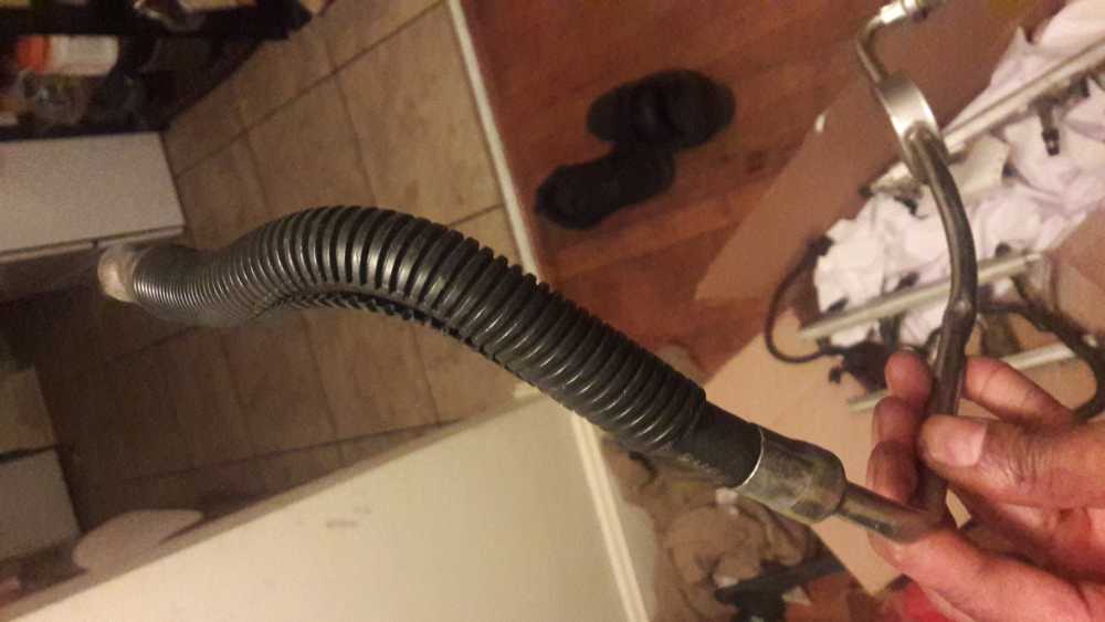

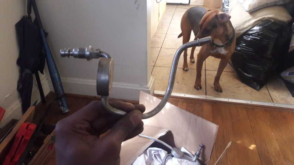

  • Donnyten
9 years 8 months ago - 9 years 8 months ago #5636 by Donnyten
It still read zero at the time of measuring when all was put back together but now I suppose part is due to the fuel rail not wanting to fully stay in all the way *fuel pouring from Inlet key on*
Ugh.... I can't find th s part anywhere. I got another rail now. Just need the pipe and I can't use the one from the 3.4 unless yall know any mechanic tricks. Or a trick to get the damn bolt off the newish rail.
New one
Old one
Unless the flex hose can come off the old one? Or can I just use some aftermarket part?
9 years 8 months ago #5654 by Noah
The flexible tube should come off at the quick connect union there.
I don't remember off the top of my head, (and can't quite tell from the pic) if that's the style where you just need to squeeze the tabs and poll the line off, or if you need a tool like this:
There's many styles of tools out there, I'd recommend buying a set with as many in it as you can get. Lisle makes a good set.

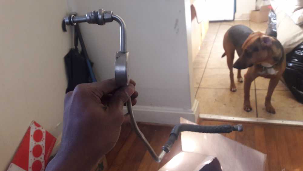

  • Donnyten
9 years 8 months ago - 9 years 8 months ago #5655 by Donnyten
Noah wrote: The flexible tube should come off at the quick connect union there.
That's exactly the tool I used to get it off from the car.
If you're talking about this part it doesn't look like you can get it off
9 years 8 months ago #5664 by Noah
Alright, I see now. I saw the little lip on the end of the new one where a line would clip on and thought the old one was not disassembled all the way. Those look like two very similar but very different parts. The over all dimension and shape is way off (not to mention the flexible hose doesn't appear to be removable from your original part).
