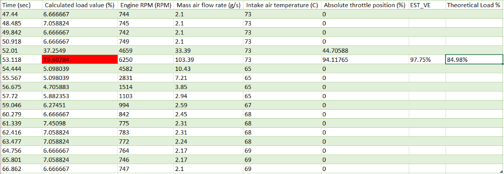

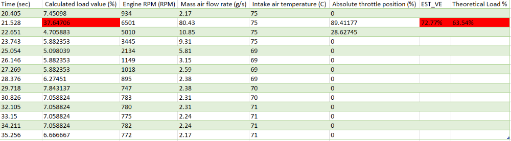

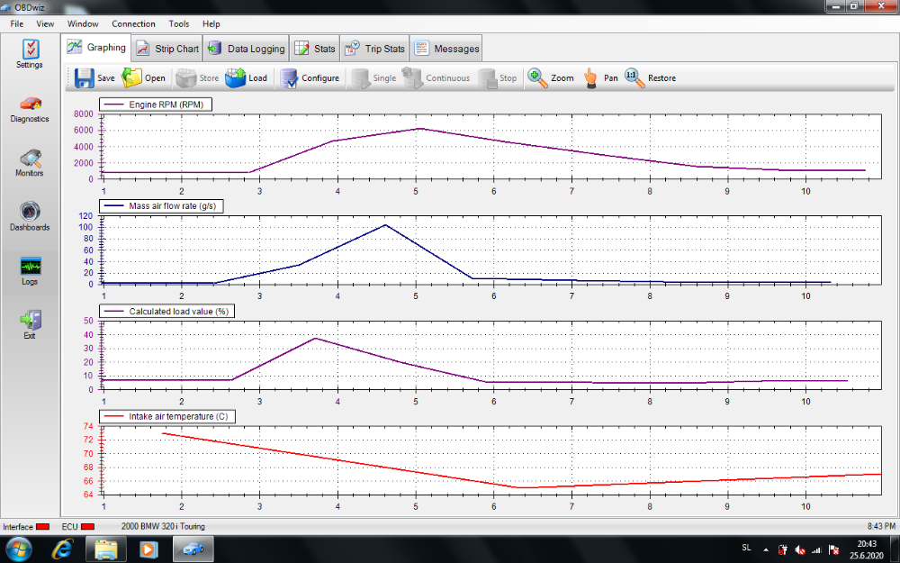

I'll try to do some pictures. The Scanmaster XL software I used for the test run doesn't have logging capabilities and it's not even possible to scroll back the graphs so what you see live is what you get. I should have recorder video of it but didn't think of that. I'm trying to find more suitable software. I tried ScanXL professional it looked very promising but for some reason it wouldn't plot the graphs or log data even though it has those functionalities. But it would show live data numbers in the graph window so it can read the PID's.
Today I was trying OBDwiz but it's so inaccurate it's of no use. I was trying to capture WOT snap data to throw them into a VE calculator.
The graphs aren't synchronized. See how how the MAF one is about 2s lagging behind the RPM one for example. There's no printed min or max values and no measuring tools to tell the peak numbers.
So I had to run background data logging. But it isn't synchronized with graphs. These certainly aren't the same peak numbers as pictured on the graphs.

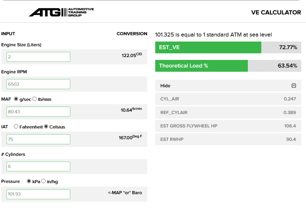

And as I put those logged numbers into VE calculator I get bad results.
And it's impossible to tell wether the graphed or the logged data is wrong but possibly both are. Could someone suggest Windows software that works with ELM327 USB cable and is exact at logging data, plotting graphs, has the ability to scroll graphs back and has some measuring tools or at least a cursor and that also displays min and max values in graph windows?
I also scoped a WOT snap test but I'm just starting to learn to use the scope and couldn't find a way to freeze the picture and make a screenshot. But the waveform shape looked exactly as it's supposed to. It had that initial spike and it hit a just above 4V max. voltage. So at least the scope shows my MAF being probably fine. At least if I relate it to the Paul's videos.

Maf sensor under reporting g/s (idle should read 3.5-5 g/s, 2500 rpm should read ~90g/s) which from the graph you put up that looks like it's under reporting.
Also in your VE chart you will want to check you numbers i believe the m52 is a 2.8 liter and the rpm in chart was 6501...
With VE being low you probably want to check compression cause that is pretty low.

My engine indeed is a 2.0l but those were never sold in the US. It has lower stroke and bore diameter than the 2.8l engine but every other part under the hood including all the intake parts and MAF. So my MAF should definitely read lower at idle than the 2.8l. I just can't say how much lower should it be. If it were directly proportional I guess it should read about 2.6 g/s but. That would indeed make the reading low. But I'm not sure about that. And new MF is a 400€ part so it's hard to decide for a new one without firm evidence.
And I'm taking those higher than idle measurements with a big grain of salt. I posted those images to show how inexact is the software I used. Graph shows about 100 g/s peak value while the log recorded only 80 g/s. And also the RPM graph was plotted 2s ahead of the airflow graph. I have more log screenshots. I could have posted this one as well:
This one has excellent VE, but calculated load is much worse. I think it's just the diagnostic software doesn't synchronize time frames accurately and makes VE calculations all over the place which makes it useless to gather VE data. So I have to find better software to be able to test the VE properly.
The other important thing to consider is I did the measurements with car standing still so that may have influenced air flow at higher than idle RPM significantly. There's a valve that changes length of intake runners on the intake manifold, both camshafts have variable timing controlled by the ECU and I believe at WOT even idle air control valve opens all the way to let more air in. It's very possible ECU doesn't activate some of those systems if the car isn't moving and I imagine that would have large impact on the airflow.

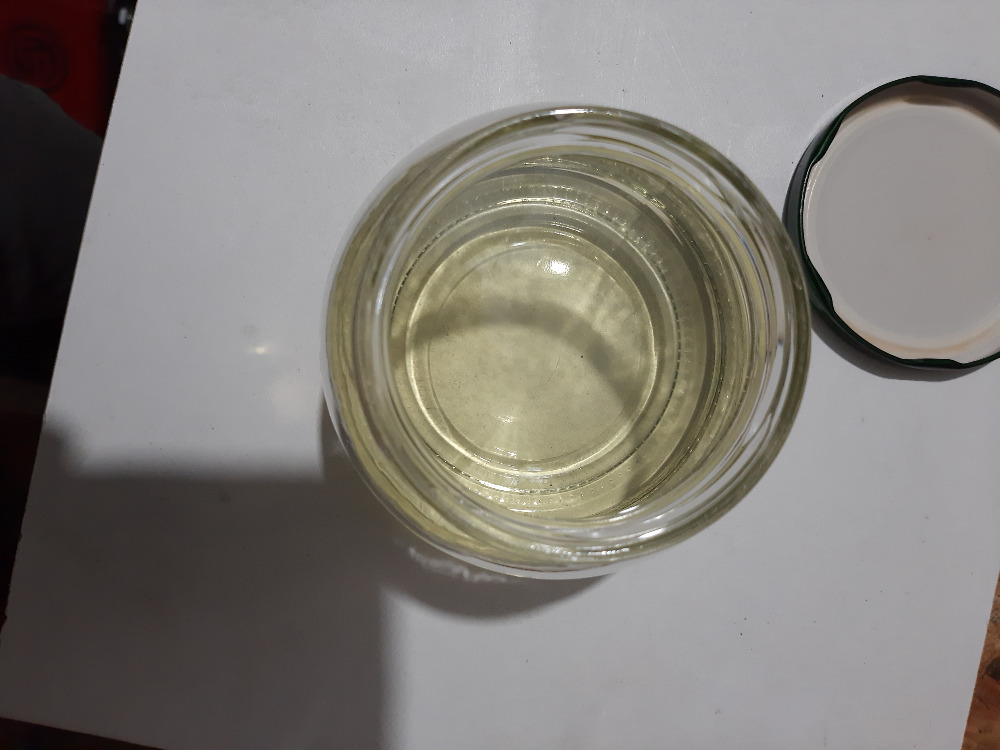

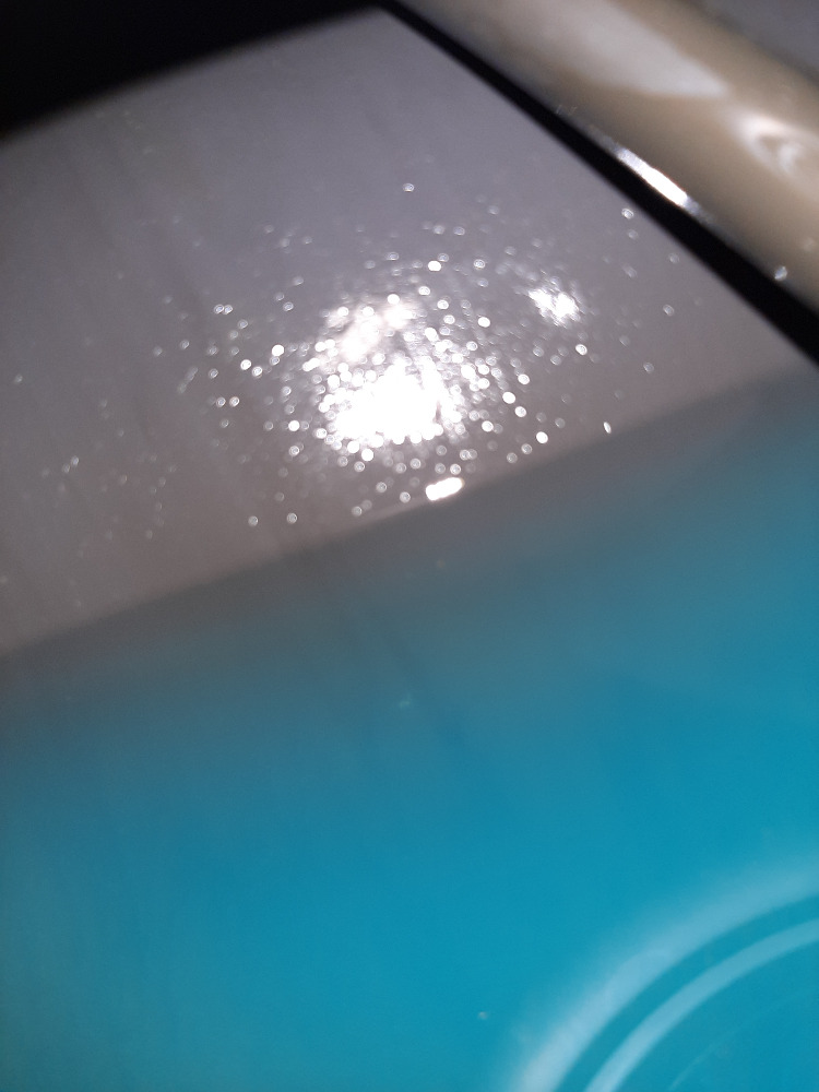

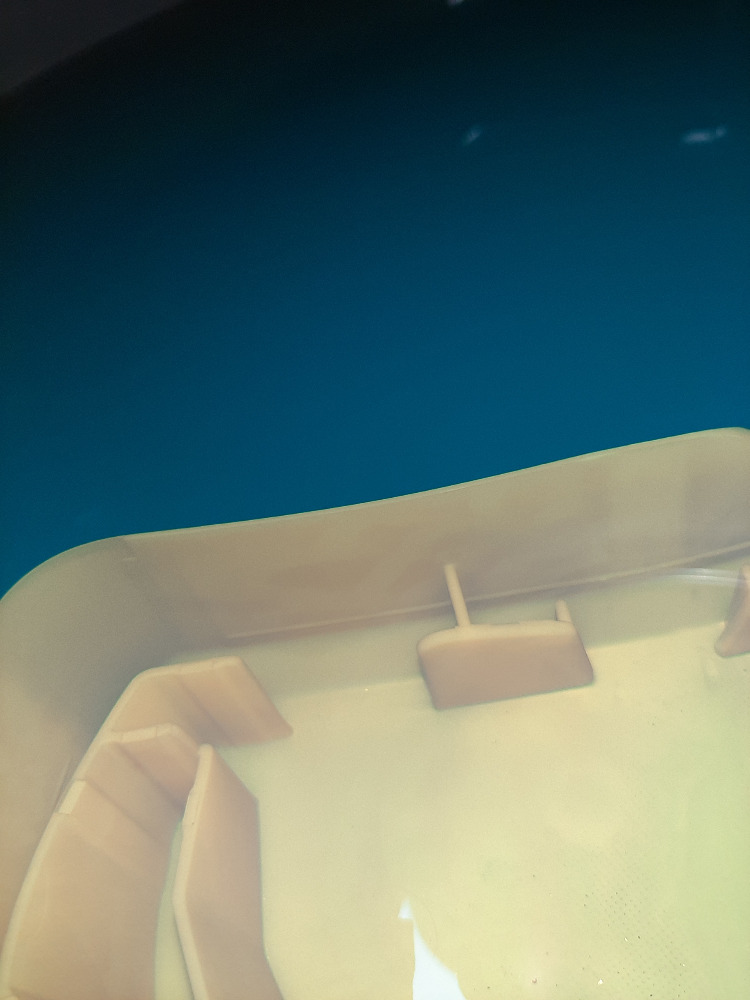

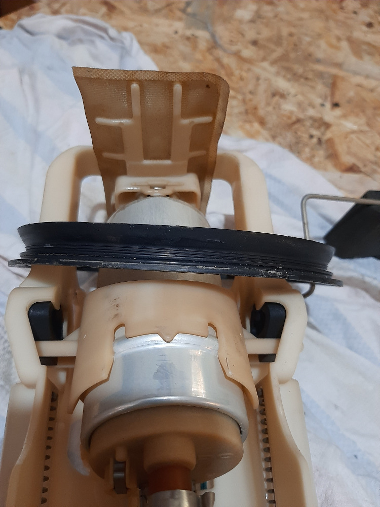

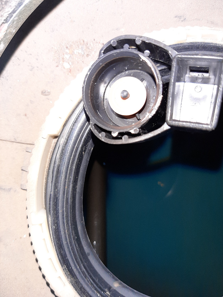

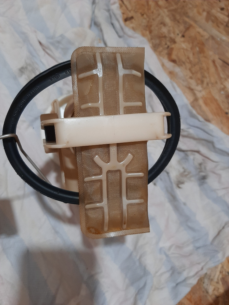

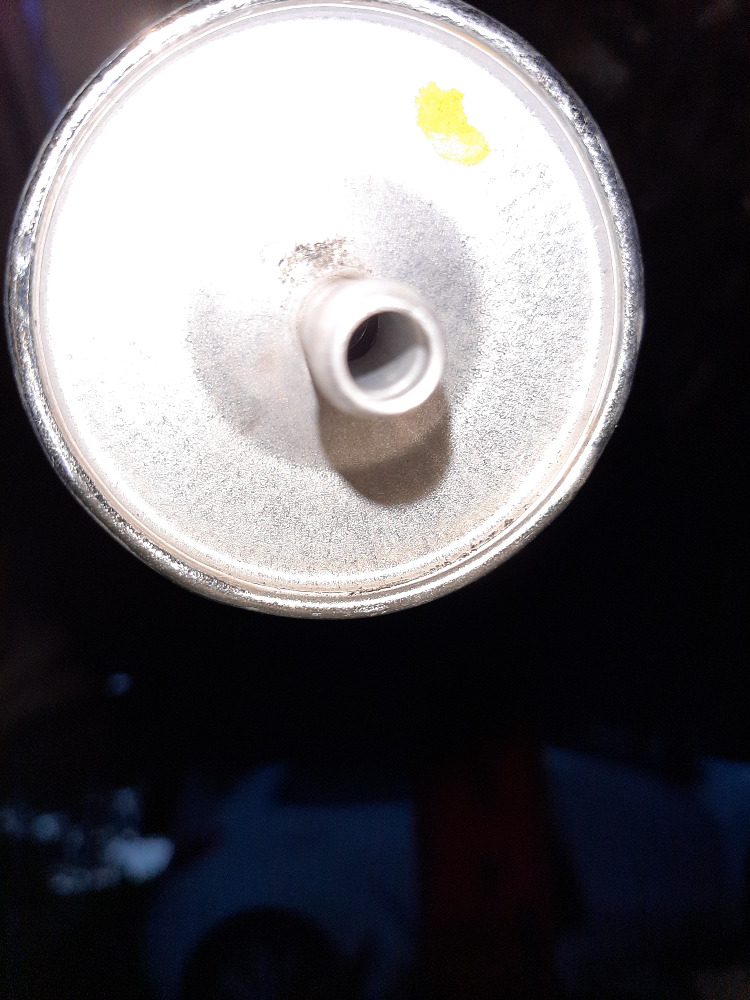

I pulled the fuel pump and fuel level sender unit to visually inspect the fuel tank. I haven't inspected many tanks before so I don't have much to compare it to. But it looks cleaner compared to what I've seen on my 1990 BMW 320i's as I once pulled the pump. And that car ran fine.
There's no signs of any brown varnish, gum slime or anything like that.
It can't bee seen well because it's impossible to make good photos of tank internals. There's a few small particles at the the bottom but I guess that would be normal for an old high mileage car, right?
It took some fuel samples from the bottom of the tank and let it set for a while. No particles were found settled at the bottom of the jar.
I also disconnected inlet hose to the fuel filter and drained the gas out. It was also clear without any particles. No signs of brown deposits in side the inlet nipple.
I seems fuel delivery system wasn't fouled by bad gas if it's clean up to the filter it can't be worse from the filter onwards.
Last edit: 6 years 4 months ago by szgonik. Reason: Adding more photos
6 years 4 months ago #40907 by Hardtopdr2
Ok well that rules out any problems back there. The only other thing I can think of is your tps sensor having dead spots/corrosion in the resistance grid. Which can be checked with a volt meter set to dc volts and back probed into signal wire and have someone slowly push the gas pedal down to the floor and let back up in the same fashion (literally fractions of an inch at a time) to see if it drops out. if at any point the voltage drops to 0.00 you have a dead spot. the voltage range should be .5 volts to 4.5 volts. Now i am unsure if your model has two tps sensors in one but check both if it has 2. If it's bad then replace it but also test the new sensor as well when installed. Other than that I am not sure without actually looking at car. I would say to make your own smoke machine or purchase one and actually smoke the systems to rule out that side.

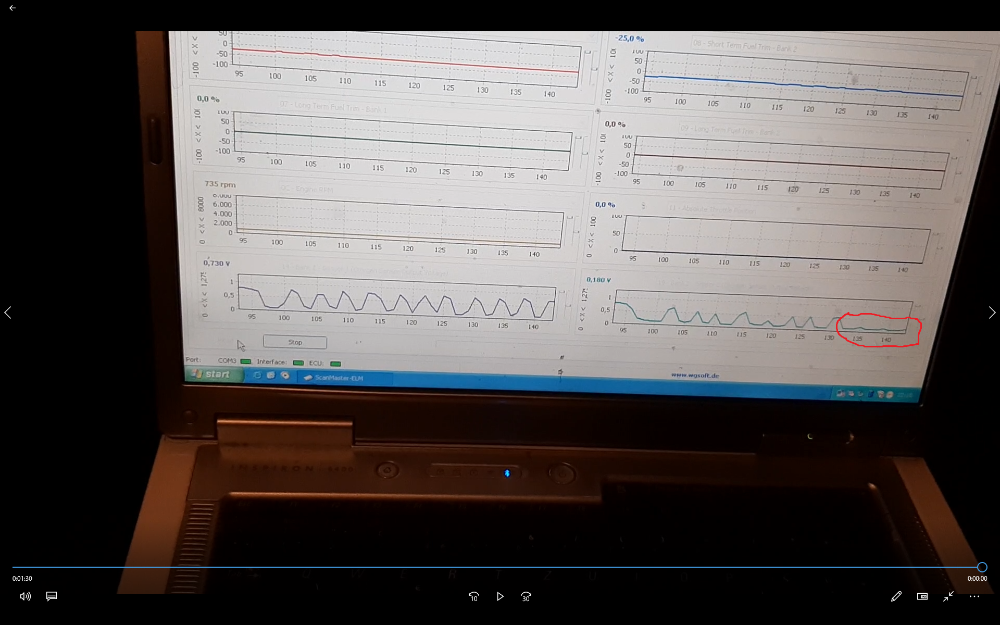

Next video shows some scan data on warm engine. Idle STFT are perfect and O2 sensors switching between rich and lean. It all seems fine. But notice as I raise the RPM just a bit (to about 1700 - 1800 RPM) both O2 sensors go full lean before they catch up. Next I do WOT and they go full lean again.
What I find strange in this video and subsequent videos is the throttle position graph shows only almost unnoticable reaction at frame 54 as it should go fully up. The other software I used had trouble graphing this PID too. But the values in log file did record changes in this value. Strange maybe for some reason generic OBD2 software can't interpret throttle position PID or it might really be a TPS issue as Hardtopdr2 suggested. I should definitely check what's going on with TPS.
Next video. Around frame 74 I switch to LPG. O2's go full rich and STFT's go full negative. O2's then start to switch between lean and rich STFT's are still way too negative. And between frames 130 and 135 bank2 O2 goes fully lean but ECU keeps leaning out the mixture on that bank with -24% STFT. I've never seen this happen with this O2 sensor so far. Oh my this reminds me more and more of that Scanner Danner Kia Rio video. Seems like scan data "behaves" inconsistently sometimes for no reason.

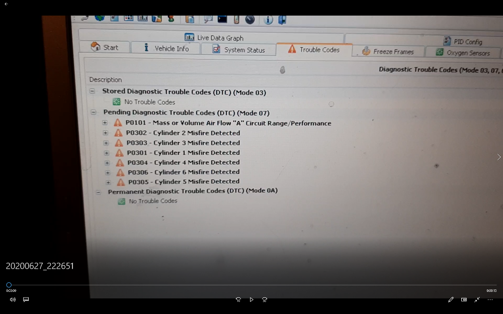

Reading the error codes after. Ignore the P0101 as it was caused by me unplugging the MAF. P0170 and P0173 aren't there because they won't appear while the car's standing still. They tend to appear after a few miles of driving. There' also no freeze frame data for the misfire codes as I guess freeze frames aren't stored while the codes are pending.

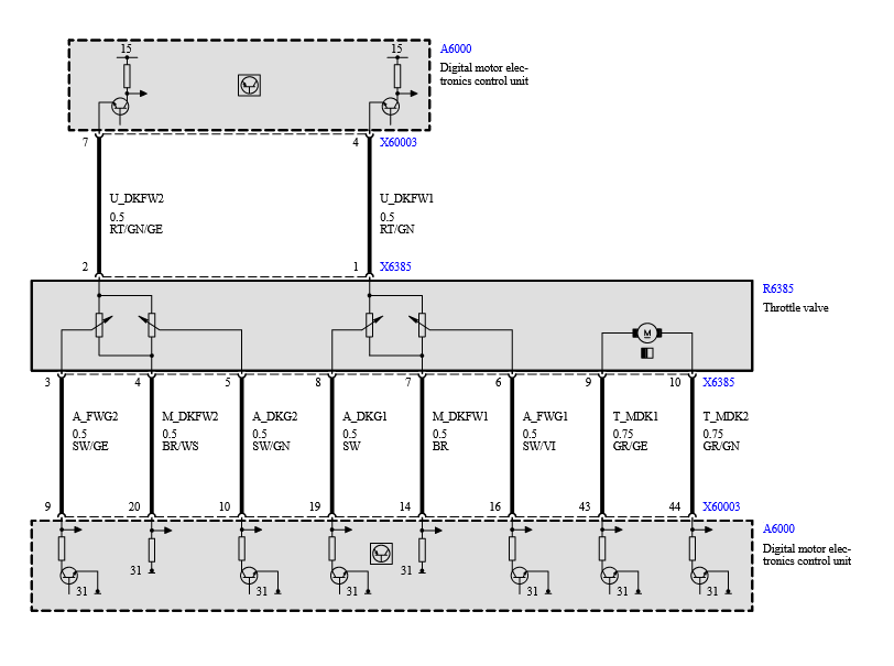

This BMW model has two switches. They're part of throttle body electronics. I guess they're those potentiometers I mentioned above that are turned by throttle cable.
2nd switch is supposed to be there for redundancy in case one of them fails. And it would make sense ECU compared those switches and throw a code if their values were off.
I also checked throttle plate and potentiometer angles with BMW specific software.
They're not completely synchronized which I'm not sure is normal behavior or not. But it confirms ECU can read throttle position values and it must be generic OBD2 I used in those videos I posted before that can't read that PID properly. And it also confirms there are no glitches while slowly depressing and releasing the pedal. According to BMW Technical documentation the throttle plate with pedal fully depressed should be at 80° - 84° angle. Mine is a bit low and it could be easily adjusted by turning the stop screw under the pedal. But I won't do it for now. As I don't want to introduce another variable into the troubleshooting process.

At the end of that video I posted above - live data running on LPG there's something funky happening too. Bank O2 goes fully lean. That sensor might be bad but what bothers me is STFT stays at -25%. Why wouldn't the ECU react with rich command as the sensor clearly reports lean. How much funkier can it get? Can someone find an explanation for this?

1. Disconnecting the MAF's supposed to make car running rich which could richen the lean conditions enough to mask the problem. I have to investigate further on this one by collecting some live data with MAF disconnected and comparing it to data with MAF connected.
2. O2 live data seems to be much better running on LPG which suggests it might steel be fuel delivery problem.
3. It seems very unlikely a MAF would go bad in a few months waiting to be reinstalled in the car. While I replaced complete exhaust and dropped the fuel tank. So it seems much more likely something would be wrong with those two. But I have no idea why. I've proved fuel pressure and volume are fine. I've checked the tank for varnish. And it's very unlikely to be the injectors. I can't detect any obvious exhaust leaks. Could minor exhaust leaks that don't produce any exhaust leak sounds and visible smoke be large enough to cause such bad lean conditions? I find this very unlikely too but don't have experience with that.
6 years 4 months ago #40940 by Hardtopdr2
Well your car should have a high pressure fuel pump mounted to engine where the fuel lines bolt up its possible that the rubber diaframs in the hpfp failed. That's the only other thing I have found via diagnose dans youtube channel.
  • szgonik
  • szgonik's Avatar Topic Author
6 years 4 months ago #40956 by szgonik
These engines don't have high pressure fuel pumps. Direct injection wasn't used on this generation 3-series gasoline engines.
6 years 4 months ago #40971 by Hardtopdr2
Ok was not sure it had it
