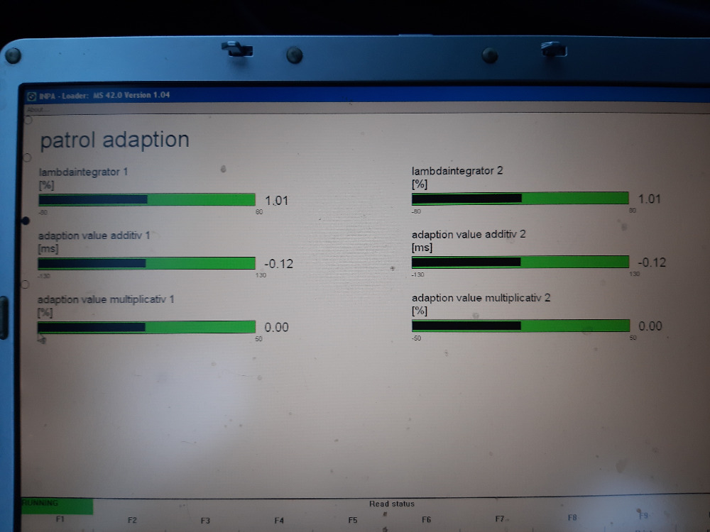

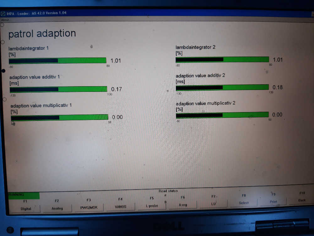

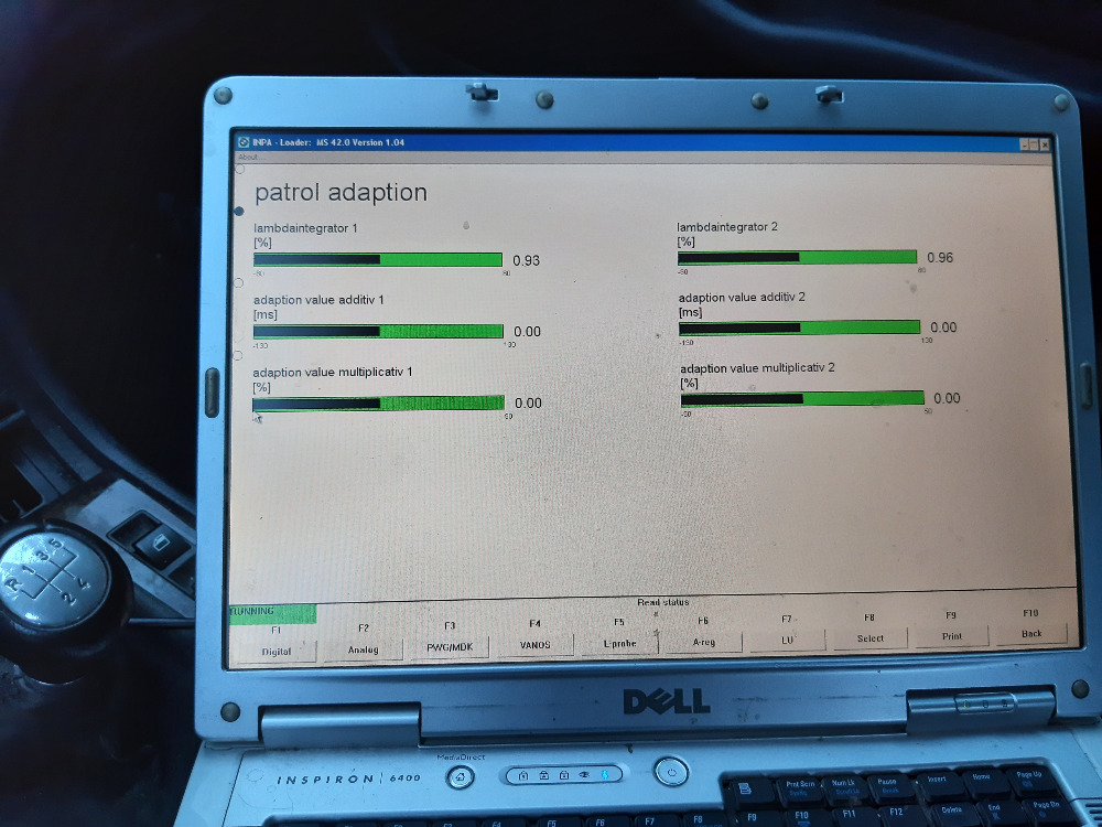

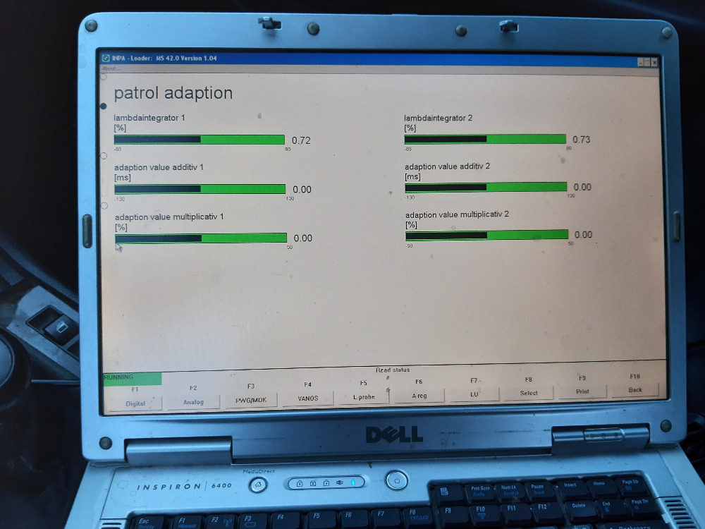

With new MAF it started cold without stalling. The startup was fine but not perfect. It took a few seconds to catch the proper idle RPM and I felt light shaking under my butt so there's probably still some minor misfire.
I tried the same tests as above with unpluging the MAF runing on gas and LPG. Idle trim values in INPA look better now the car idles fine and no error codes were thrown.
LPG with MAF connected. Values with old MAF were perfect with new MAF they're on the rich side. I think this might confirm that LPG might be calibrated too rich because at the point when they were calibrating it the MAF was already on it's way out.
LPG MAF disconnected. Slightly richer than before. So it seems it's normal for a substitute MAF value to richen the mixture by 20%+:
Gas MAF disconnected. Slightly richer than before too.
Gas MAF Reconnected. Values adapt to the lean side. But not nearly lean enough to throw a code and cause open loop.
The specs in DIS diagnostic software state good values are between -0.35ms and +0.35ms. So it's about halfway there. If I didn't have the diagnostic tools I'd call it a fix for sure but unfortunately I do and I'm not entirely happy with the numbers I see. I'd like to see them closer to 0 say less than +/-0.1ms.
The other thing there's strange is idle voltage of the new MAF's around 0.4V. Same as it was with the old one. But for some reason the car runs much better anyway. I guess it's not the voltage itself but maybe there was too much noise in the signal with the old MAF. I did scope the old MAF before though and couldn't see anything weird going on with the waveform. Maybe I'm just lacking experience to notice imperfections in the waverform.
I also didn't notice any obvious difference in all 4 O2 sensor behavior graphing them with OBD2 scanner. The upstream ones would still go fully lean on WOT and the downstream ones either mimic the upstream ones or show constant lean value.
I think the car might pass the emissions test now so I'll give it a try. Luckily it's easier to pass than in the US I think. They don't connect scan tool to check emission readiness monitors. Only CO content and lambda values are measured at the tail pipe while idling and at 2500 RPM AFAIK.
I'm not finished diagnosing this car yet but if I manage to pass emissions I'll be able to register it and drive it so LTFT will be able to adjust and I'll be able to collect much more meaningful data. If I fail I'll at least get some data on what's going on with exhaust gasses. But since MAF reading still seems too low I would suspect a hidden air leak somewhere. I guess I might need to get a hold of smoke machine afterall.
