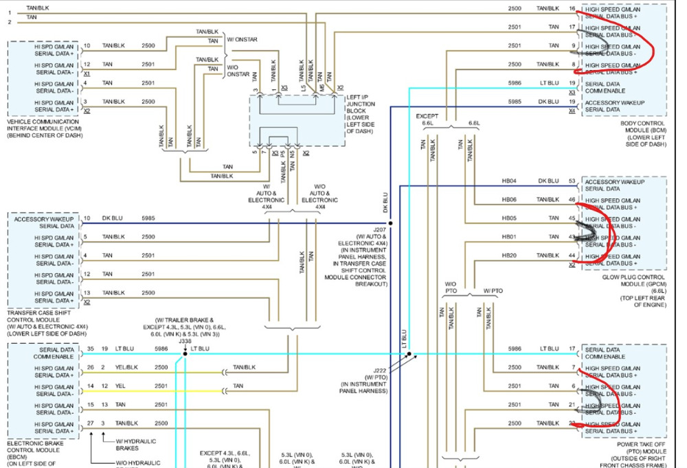

6 years 4 months ago #40978 by Cheryl
Replied by Cheryl on topic 2008 Chevy Silverado 1500 4.3 W/T
Have you checked voltage drop across pins 4 and 5 at the dlc? Connect red lead to pin 5 black to pin 4. You shouldn’t see any voltage besides 100 mv or so
6 years 4 months ago #40979 by Cheryl
I’m guessing abs module is the issue. Just because there common girl taking down the network. Only other thing is unplug one module at a time see if you get any change. But you’ll need to jump the data lines in the connector so you maintain 60 ohms.
6 years 4 months ago #40986 by Matt T
Replied by Matt T on topic 2008 Chevy Silverado 1500 4.3 W/T
Cheryl wrote: I’m guessing abs module is the issue. Just because there common girl taking down the network. Only other thing is unplug one module at a time see if you get any change. But you’ll need to jump the data lines in the connector so you maintain 60 ohms.
Jumping the data lines will drop the network down to 0 ohms which'll take the network down, and worst case smoke something.
You only need to jumper, with a 120 ohm resistor, when you unplug a module on the end of the network which has a built in termination resistor.
6 years 4 months ago #40987 by Cheryl
No jump the data lines coming in and going out of module. Eric o from south main auto has a video on YouTube
6 years 4 months ago #40988 by Matt T
Cheryl wrote: No jump the data lines coming in and going out of module. Eric o from south main auto has a video on YouTube
I'd like to see what he did, because dead short jumping can hi to can lo doesn't sound right. If you can't post a link to the video maybe post the title so I can find it.
6 years 4 months ago #40993 by Chad
Replied by Chad on topic 2008 Chevy Silverado 1500 4.3 W/T
Cheryl is NOT suggesting to short CAN+ to CAN-. But to maintain bus continuity, like this:
6 years 4 months ago #40995 by Matt T
Chad wrote: Cheryl is NOT suggesting to short CAN+ to CAN-. But to maintain bus continuity, like this:
Oh so the can bus runs thru' each module instead of just to it. Makes sense now. Well at least having to jump hi to hi and low to low makes sense. Having 4 potential network failure points on most of the modules makes no sense whatsoever...

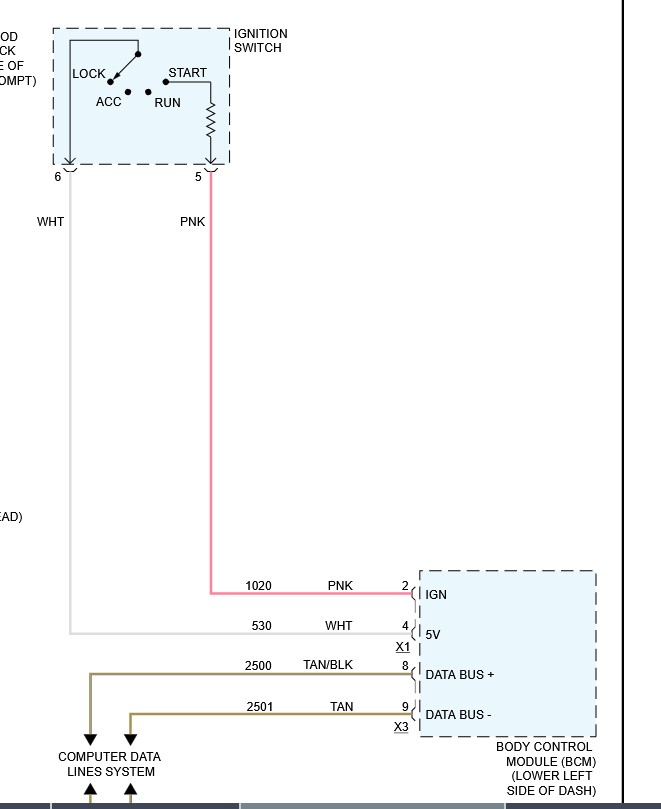

  • NuckingFutsKustoms
  • NuckingFutsKustoms's Avatar Topic Author
6 years 4 months ago #41055 by NuckingFutsKustoms
Replied by NuckingFutsKustoms on topic 2008 Chevy Silverado 1500 4.3 W/T
Ok Im back, here is where I am at. Have coms to ECM TCM and most of BCM. What I dont have coms to is my IPC , Radio, or Door locks from scanner, the locks work from the door switch though.
So I figured I would just start at what doesnt work and work on one thing at a time so I started at the Ignition switch, What I have there is 3.9 v on the white wire which If Im seeing it correctly is the 5v ref. and Im seeing 3.9v on the pink wire witch again if reading it correctly in my signal to IGN of BCM. thats in RUN postion btw, turn the key to start and I get 2.5v on white wire and 4.1v on pink. Now when I unplug the switch altogether I get 4.9v on white and 0 on pink. Since Im brain dead at this point in time that seemed weird to me so maybe just maybe it was my switch bad. I know they said they replaced it but how do I really know this. I just happen to have a new one there so changed it out right quick and still had the same thing. SO I guess its supposed to be like that??? Tommorow I suppose Ill do some origami stuff and fold my way up under the dash and back probe the BCM and see if I get the same things. Unless yall give me another direction that Im not seeing.
6 years 4 months ago - 6 years 4 months ago #41065 by Chad
:blink: Seems weird to me, too.
This is Copy & Pasted from Alldata:
Circuit Description (Key Start)
When the ignition switch is placed in the Start position, a discrete 12-volt signal is supplied to the body control module (BCM) notifying it that the ignition is in the Start position. The BCM then sends a message to the engine control module (ECM) notifying it that CRANK has been requested. The ECM verifies that the transmission is in Park or Neutral. If it is, the ECM then supplies 12 volts to the control circuit of the crank relay. When this occurs, battery positive voltage is supplied through the switch side of the crank relay to the S terminal of the starter solenoid.
Not much help.
