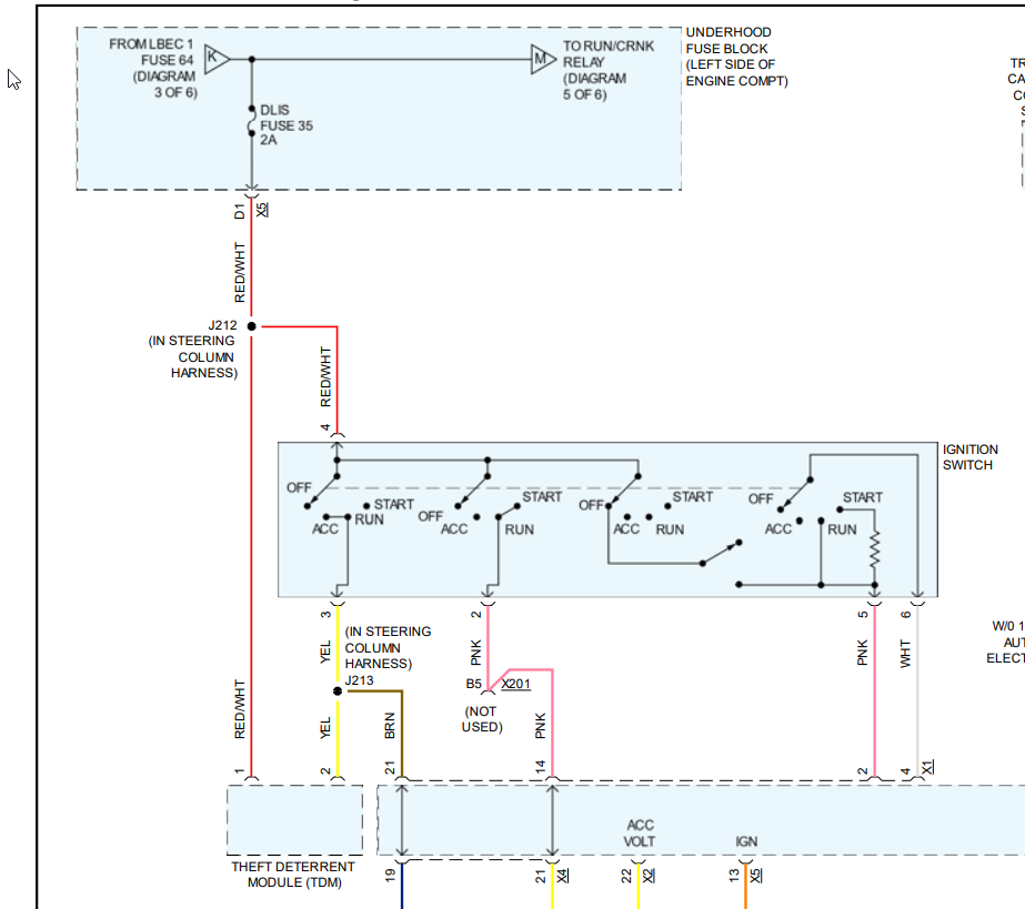

According to the schematic white is 5v reference and pink is switch position signal for start position. So with connector disconnected those readings look ok. But the low voltage in run/acc is on white concerning but there are two pinks in the diagram you posted so I would check which pink wire you checked to make sure you read the correct one. I would check voltage at the 2 amp fuse to see what you have for supply voltage after that.

Yeah the diagram shows 2 pinks but I only have one pink in my connector.

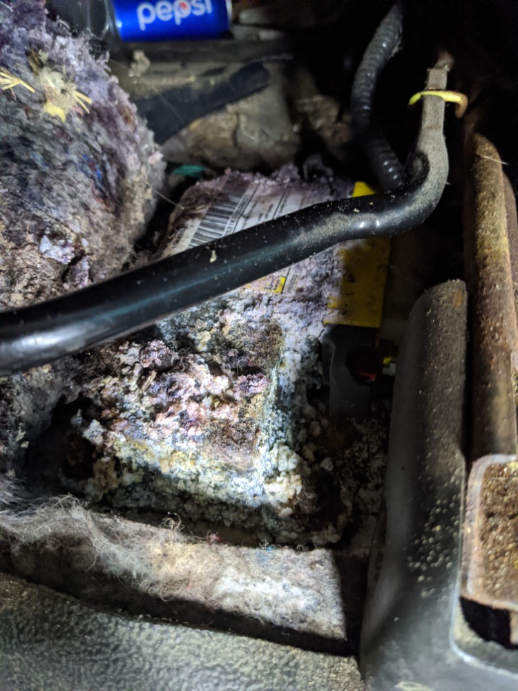

Ok I'm getting close so air bag module is a puff ball unplug it and everything comes back to life. Question now is will that module cause it not to run I have fuel and spark and compression . 60 psi cranking fuel pressure but I can only get it to fire off when I manually dump the injectors. No DTCs in the ecm or others o ly the PPS which isn't hooked up.

P0615 is starter relay circuit malfunction... meaning something in the starter circuit is not functioning as it should. Did you try starting it with the airbag module disconected? If yes and it did not crank recheck voltage at switch with the airbag module disconnected. When your done is it same readings as before? If its different did it go to 5v on white and pink?

The next part to test is voltage at each pin end of ignition pink and white wires. If 5v at both ends of white wire in run position (body control module conector and ignition switch conector side) then check pink wire at both ends for voltage in run position and crank position. if voltage is same at both ends of connector then check ignition signal wire that goes from bcm to pcm for voltage and resistance (just make sure ignition switch is off before doing resistance test.) .

I would like to thank everyone for their help on this matter ended up being the ECM for the No Start issue although the airbag module is still a poof ball under the seat. But I must say this has been a real learning curve for me and even though 90% of the things said here to me I didnt understand from the word go it was still a great learning experience.
