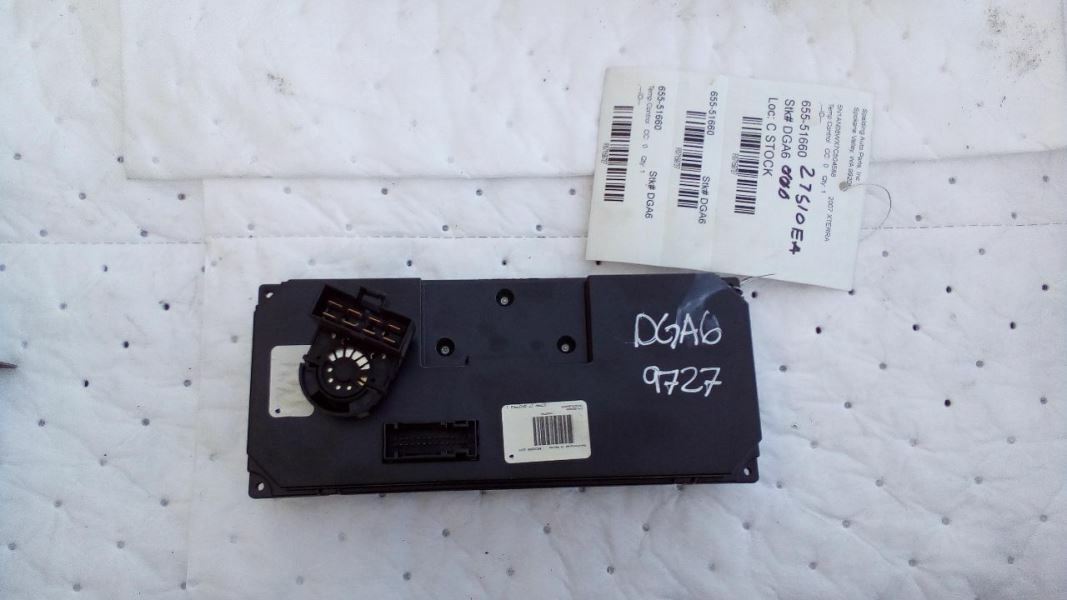

6 years 3 months ago #41298 by Matt T
forumjoe wrote: Hardtopdr2,
It is a light in the A/C button I would think an led, I will ty to trace it to the module if I can find the module and read the wire in the schematics. Thanks I will try.
Joe
Your HVAC controls are the module, and the blower control switch. Hopefully you'll see a picture of the back side of it I borrowed from ebay, The connector top left with the spade terminals is your blower switch. Since factory SI doesn't do a good job of explaining how the blower monitoring really works you need to backprobe the terminals on the FACs blower switch connector and see if they're all reading 0V to B-, or close to it, when the AC light is off but should be on.

  • forumjoe
  • forumjoe's Avatar Topic Author
6 years 3 months ago #41318 by forumjoe
Pretty cool use of ebay I must say. You are very clever.

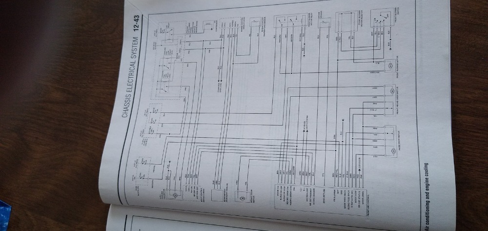

6 years 3 months ago #41355 by forumjoe
Hi Guys,
Just running through all your suggestions and looking at the A/C schematics in the Chilton manual and thought if I probe the blower motor connector with my LoadPro tool from Dan Sullivan and cycle through all the blower switch settings while observing the voltage changes it would only tell me if I have an open or a short to ground or resistance in the wiring but would not take into accounnt the A/C relay and signal wiring of that part of the system, right?
6 years 3 months ago #41365 by Hardtopdr2
Hey joe,
Can you get a closer pic of that wiring diagram? Not sure but it looks like it is ground side switched.
What i can tell is from the fuse it feeds into the relay then to the blower motor followed by the blower motor resistor then through the fan speed switch and finally to ground.
If that is the case check for voltage on the relay side of blower motor connection if you have power there and that voltage goes higher to (battery voltage) when it acts up then the switch assembly is the problem. If it drops to 0 when it acts up its a relay. To rule out a relay sway a good one from another circuit that you dont use like high beams or something and see if it still happens. From what i am seeing its relay or switch depending on the result.
