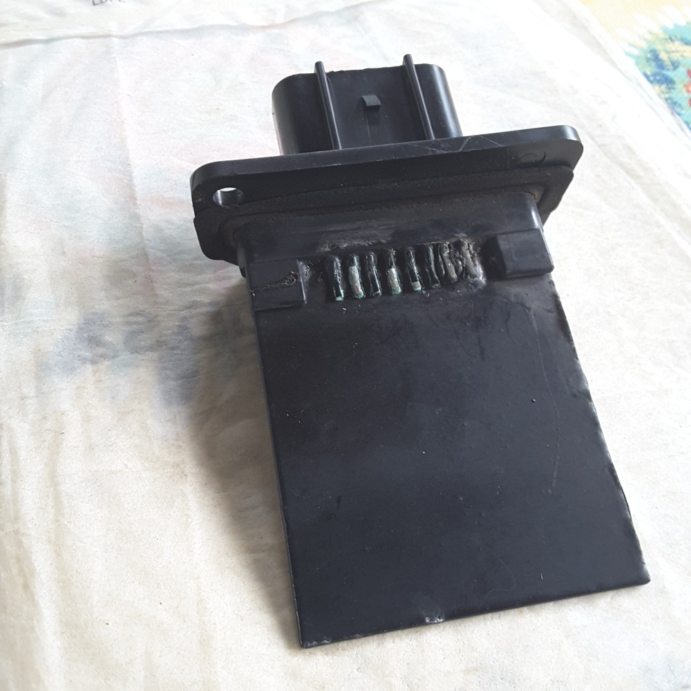

If it helps it was the resistor pack. I tested everything that I could, the fan control switch with my power probe as per Eric at SMA, I tested the fan circuit with my Load Pro per Dan Sullivan, I tested all the relevant fuses and relays. I back probed the motor while operating the fan and everything I checked tested out ok. I then pulled the resistor pack out and ohm tested the individual contacts with the common ground contact (the Blue Wire) and 2 out of 3 tested the same .001 ohms the red wire contact however tested .134 ohms this is the #1 setting on the fan switch which is also shared with what I believe is the signal input to the Fan Control Unit that tells the BCM if the fan is on or off so that it can then turn on the A/C.
I decided to purchase a new resistor pack from my local NAPA store as that is what Eric at SMA did for a Fan motor problem on a Nissan Frontier that he did a You Tube video on, if it is good enough for him than it is good enough for me.
I haven't tested the amp current draw on the motor but I might as I have read that a high current draw can harm the resistor pack.
Anyway, I installed the new resistor pack and all is working again so far, blower motor speeds are working and A/C button light is now working on all speeds seems OK but I will be watching for awhile.
I am attaching a pic of the old resistor pack that I took out so you can see what it looks like.
I hope this helps someone with that kind of a weird problem.
Are you sure about those resistance readings? :huh: Most meters I've seen can't measure down to .001, or even .134. Did you mean 1 ohm and 134 ohms? Because 134 ohms would be high enough to cause a voltage drop in a 12V circuit.

After changing scales on my DMM I get 1.9; 1.0; and 50 as ohm reads on the 200 scale of my DMM. The 50 ohm is for the red #1 setting lead.
