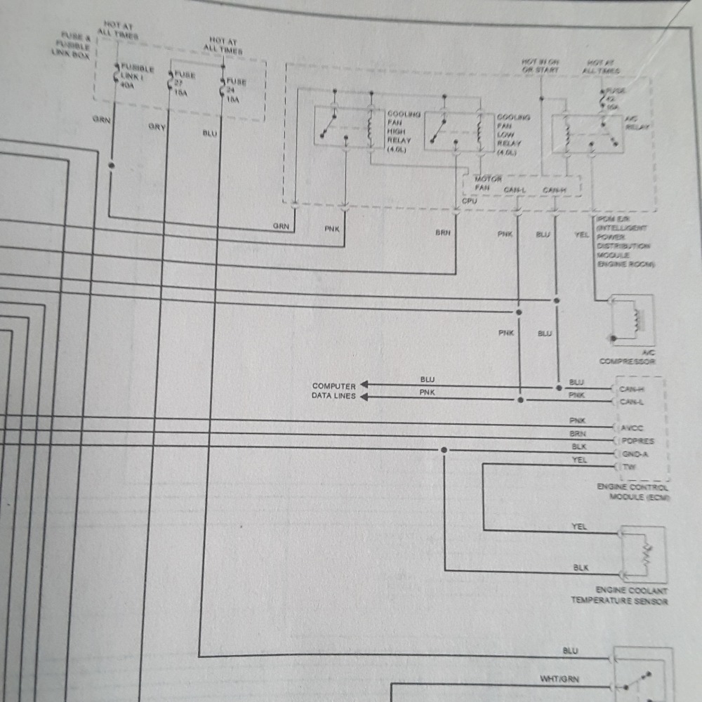

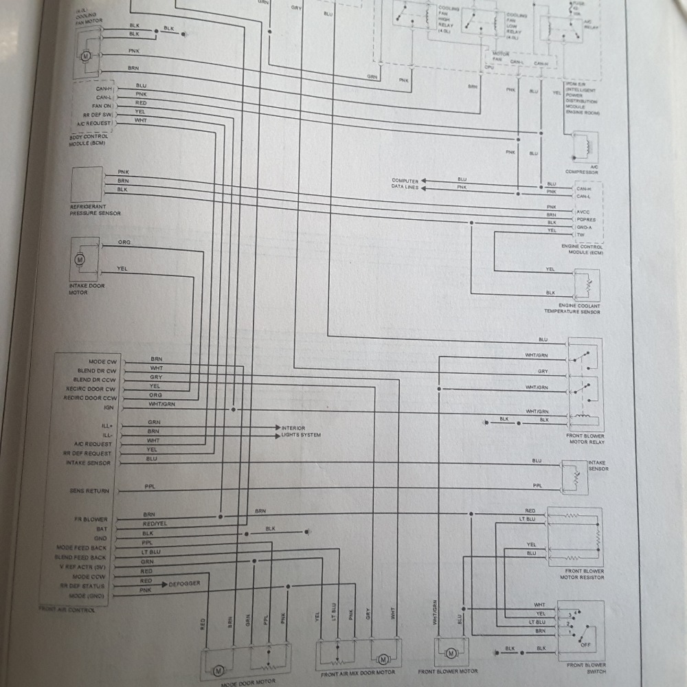

Thanks Hardtopdr2,
attached are two pics of the wiring diagram as requested. I see where you are going and I think I can test that by disconnecting the blower motor connector and reading the white/green terminal on a DVOM for voltage. I am having trouble locating the blower motor relay in the engine room, maybe it is located in the passenger room. Anyway thanks for keeping on with the diagnosis and I will try to do what you suggest, it is an intermittent issue though so I will have to wait til it won't work again to test, that shouldn't be long though. But the blower motor blows in all speed settings it is the A/C that stops working in speeds 2 and 3, the A/C button light does not come on or it flickers and will either go out and the compressor stops working or it will stay on and I have A/C working.
Thanks Again Htop
Joe

As I thought my ThinkDiag scan tool would not let me access the BCM I played around some more with it today and found that I could in fact access the BCM. Turns out when the A/C is out on #2 and#3 settings the BCM is seeing a fan switch off and an A/C switch off message however when the A/C switch flickers the A/C switch shows on momentarily and the fan blower switch shows off, when the A/C IS working on either #2 or #3 setting both the signals to the BCM show on ( A/C and fan blower switch). But the fan never goes off no matter what the BCM sees. What do you think?
Looking at the schematics it seems it could be the brown wire connection to the red wire in the Front Air Control wiring or the red wire in the BCM, somewhere there is a no fan signal being sent to the BCM even though the fan motor is actually blowing, it wouldn't be anything relating to the resistor pack would it?

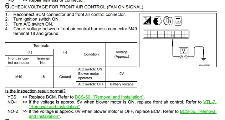

It appears that the FAC is turning off AC because it thinks the blower is off. The BCM blower input is grounded, for fan on, either by the fans #1 speed wire or by the FAC. The OEM SI shows both "options" but it really doesn't matter which is correct at this point. Though it's bugging me so I'd have to poke around with the DMM to confirm how it really works.
The FAC is probably also looking for 0V on the fan speed #1 leg to detect that the blower is on. You need to get on the back of the FAC and take voltage readings on that wire at the blower switch. You'll probably see some voltage, to ground, on that wire in the 2 and 3 speed positions which is making the FAC think the blower is off. Most likely caused by bad blower switch contacts though there are other less likely possibilities so take some measurements and report back.

I'm still with you. :silly: Great job getting the BCM data. Definitely makes me feel better that this FR BLOWER circuit is related.
Mostly trying to decide how this circuit is supposed to work... I feel like the key is in here?
It would seem to me that the BCM is providing a 5V signal on the FR BLOWER circuit, and is looking for the FAC (or the blower resistor/switch?) to pull it down to signal that the fan is on. But this whole chart makes no mention of the resistor or the switch. :angry:
6 years 3 months ago #41417 by Matt T
Tyler wrote: It would seem to me that the BCM is providing a 5V signal on the FR BLOWER circuit, and is looking for the FAC (or the blower resistor/switch?) to pull it down to signal that the fan is on. But this whole chart makes no mention of the resistor or the switch. :angry:
Yeah the SI sure is contradictory on this one. If the #1 speed leg and BCM blower input really are wired together it'll read battery voltage with the blower off not 0V or 5V.

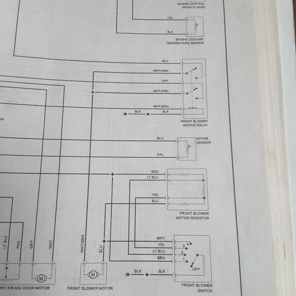

With the speed one setting intermitantly blowing/not blowing yes that could be the blower motor resistor. To test for that when it happens ohm the two wires that go in and out of the blower motor resistor for speed 1 with key off engine off. Best way to do it is to make a set of wires with sewing needles or tpins soldered to one end and shrink tubing / electrical tape wrapped covering the soldered ends of pins. Then with the other end a insulated female spade connector crimped on and sticking this end out of dash. Then when problem happens grab multimeter from glove box /center console and connect multimeter to it. Then turn car off key in off position and turn multimeter to ohms and take a reading. Speed 1 setting should be three times the ohms as speed three. So if you want to probe all the speed settings and mark each female end of the wire probes to what speed they are for that would make it possible to quickly test blower motor resistor when the glitch happens fairly quick.
  • forumjoe
  • forumjoe's Avatar Topic Author
6 years 3 months ago - 6 years 3 months ago #41756 by forumjoe
Hardtopdr2,
Thanks, I am not sure where to connect the wire for #1 setting. I think you are telling me to backprobe the #1 resistor pack wire to ground and read the ohms on the multimeter with the key in the off position, but based on the schematics I only see one wire going IN to the resistor for #1 fan switch setting. Am I missing something? You mention 2 wires for the #1 setting at the resistor. What don't I see?
Do you mean to back probe the red wire going in to the resistor and the blue wire going out to the fan motor, with T pins and take voltage readings there? As well as the other resistor wires and the blue wire to take voltage reads for all three resistor settings with the fan in each speed setting with the key in ON , engine either off or on.
Last edit: 6 years 3 months ago by forumjoe. Reason: additional commentary
6 years 3 months ago #41759 by Hardtopdr2
You will need to tap into the blue wire and red wire at blower motor resistor to ohm test the fan speed one setting of blower motor resister. If you wish you can ohm test all 3 wires to the red wire at the blower motor resistor when it glitches to see which resistor is going bad.
Ohm testing speed one will ohm all three resistors in resistor pack.
Ohm testing Speed 2 will ohm test two resistors in resistor pack
Ohm testing speed 3 will ohm test one resistor in resistor pack.
If one of the resistors is failing the ohm reading will say OL for out of limit meaning its open or it will read way higher than 3 times the reading of one resistor.
