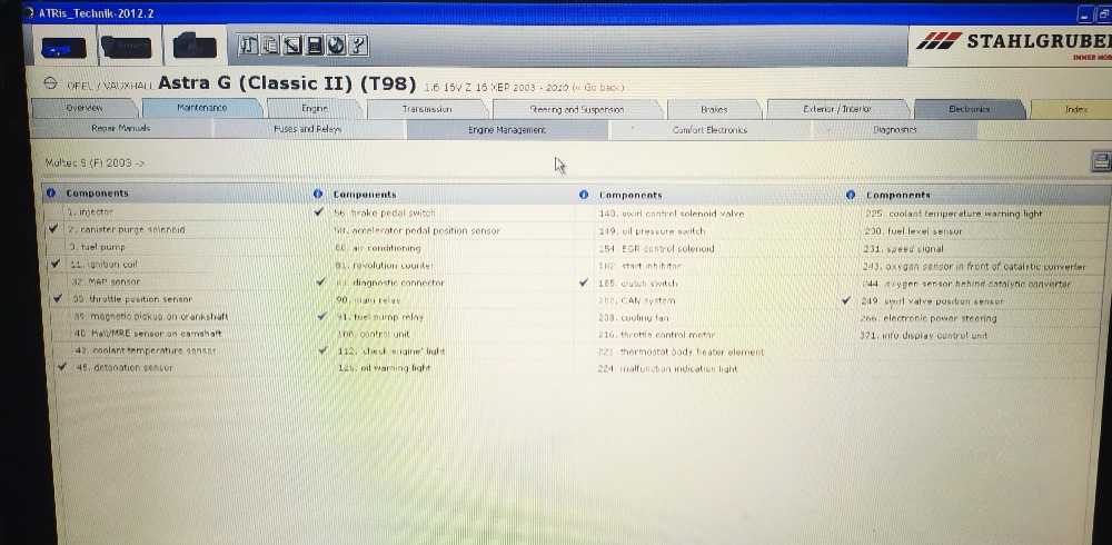

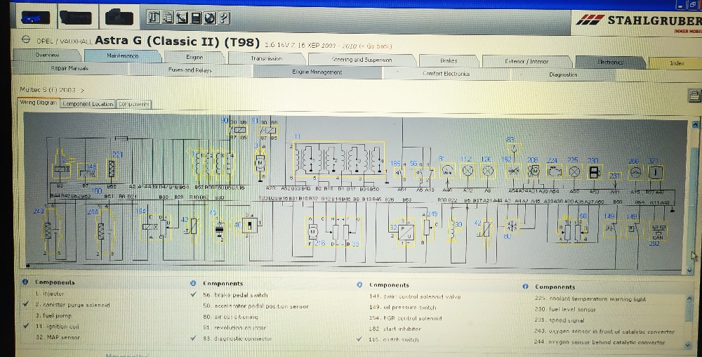

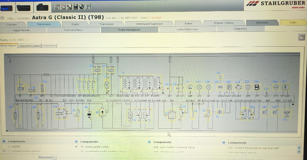

5 years 11 months ago #43089 by juergen.scholl
Replied by juergen.scholl on topic Opel fuel trims
You'll find the respective diagrams in Autodata as well as in VIVID/Stahlgruber...,probably in Tolerance too.
I attached some screenshots,hope this will help you out. If you need something more visible let me know.

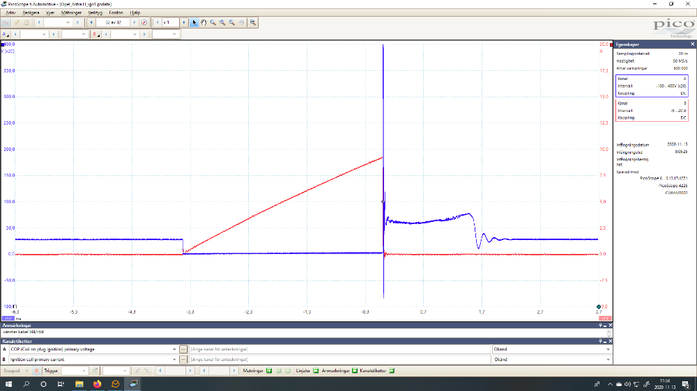

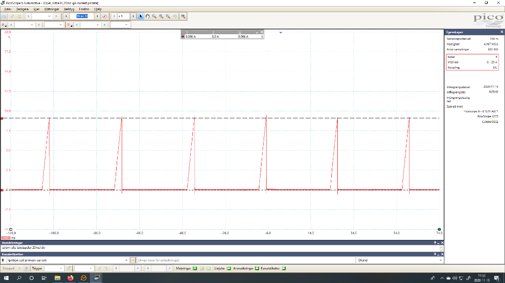

I did energize the EGR solenoid and the car stalled. Did scope the ignition but found nothing but I guess this fault is intermittent. I will look into this further Next test is the fuel injector current ramp relative compression

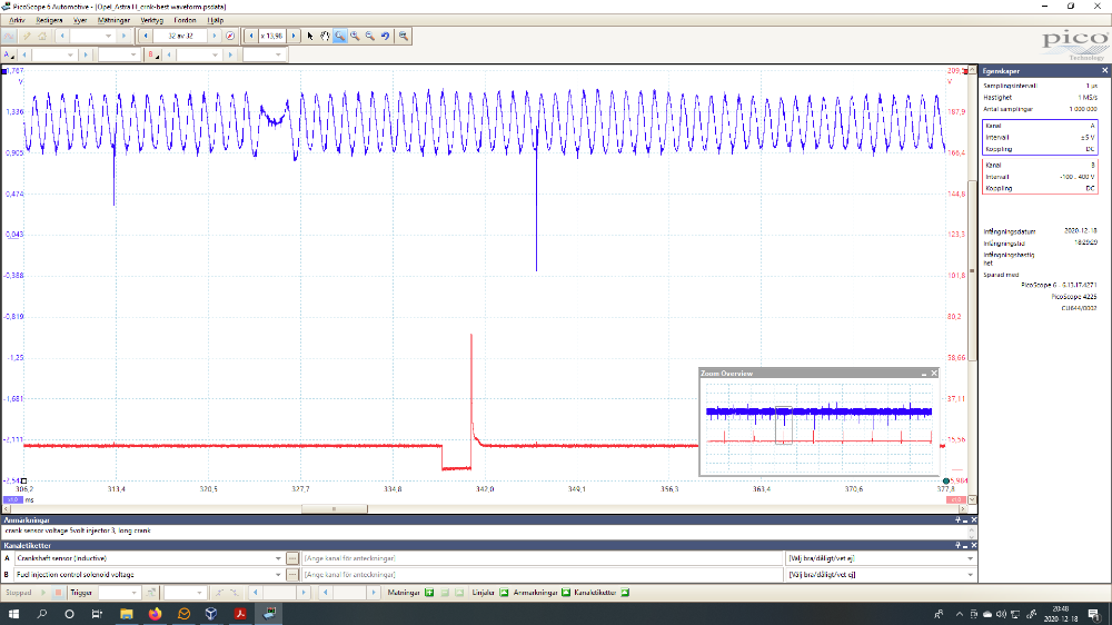

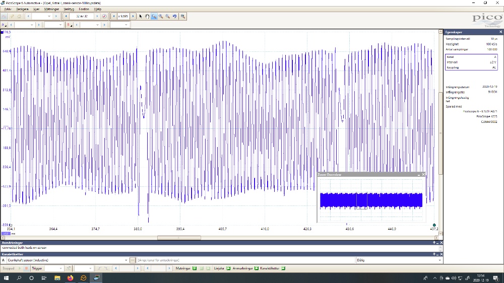

5 years 8 months ago - 5 years 8 months ago #45245 by spit64
Replied by spit64 on topic Opel fuel trims
I have now long crank time and the same problem as before but I scoped the crank sensor it is not looking good almost like the scannerDanner video where he grinds of the synch notch, did I connect the right way I am sure I did one lead to signal the other to the battery ground.
The red trace is an injector
Last edit: 5 years 8 months ago by spit64.

5 years 8 months ago - 5 years 8 months ago #45259 by spit64
Here is the gap in the tone wheel I think it makes sense with the scope picture except for low amplitude will oil on the sensor and the wheel make a difference. This time I had both leads on the sensor. Pico file below
