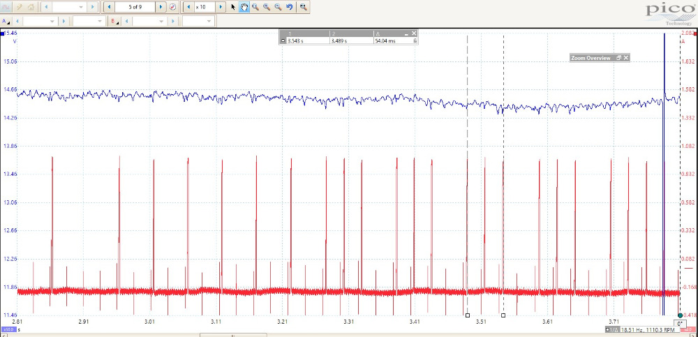

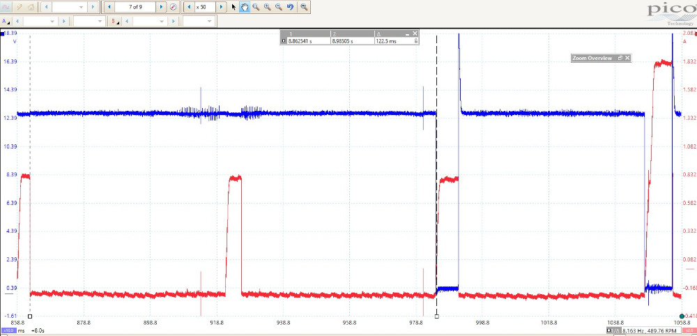

Replied by Matt T on topic Opel fuel trims
Wightscope wrote: I note also that about 4 crank revolutions before the event the voltage starts to drop from 14.2v down to 12.24v at the time of the out of turn firing, that could be a clue as it comes first.
It's not just voltage that is dropping. RPM is also getting pulled down. Almost 900 RPM when voltage starts falling on down to under 500 RPM right before the event. Then RPM flares up over 1,300 right after the event. Can also see the injector pulses getting fatter. If this did happen in gear it should've been very noticeable unless the clutch is spanked.....
Also found this after a fuel cut where #4 is the last injector to turn back on. Might be deliberate but there are other fuel cuts where it doesn't happen??

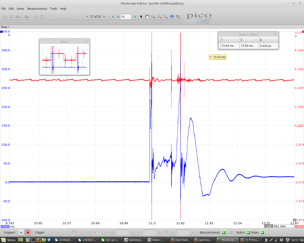

More Pico files I captured some data under misfire cyl 4 ignition and cam sensor, it is interesting one file big spikes on the cam signal from what I think is ignition could that cause the injector fire in the wrong moment, also when it misfires after restarting no problem strange. Too bad, it is not easy to move probes to injectors but I try tomorrow again scope injectors, I will do a battery test with Pick in the evening we have a snowstorm just now so it is a little difficult.

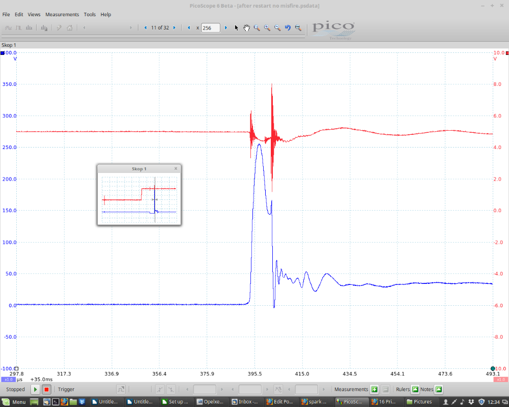

5 years 9 months ago - 5 years 9 months ago #46147 by Wightscope
Replied by Wightscope on topic Opel fuel trims
Crikey!
Well to state the obvious the primary or secondary voltage is leaking into the 5v ref, this is spiking the cam sensor - at some points off the +/-10v scale so no wonder the ECU is confused as to where it is.
There is also a 300-500mv ripple on the 5v ref at 30-180kHz, which I think is too high to be a solenoid or alternator.
You mentioned the cassette had been replaced - is it genuine and do you have the original. I am wondering if the actual problem was the CKP sensor that you replaced and this is an induced problem.
I notice that the primary spike is dropping from 350 to 250v which indicates a short and the cam sensor voltage spikes as the coil discharges across the plug. You can see when misfiring that the same but much smaller spikes happen in the 5v ref when the other plugs fire. Take a look at the plug in 4 as well, even when not misfiring I can see the spark escaping, maybe swap the plug over.
I don't know the arrangement of the engine but look for anywhere the 5v ref and primary/secondary are in close contact - ECU plug, a 5v wire clipped to the top of the coil pack for example. Is Cyl 4 next to the cam sensor by any chance? Also it maybe 5v to something only switched on at certain times

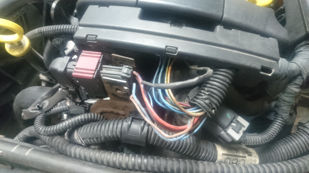

  • spit64
  • spit64's Avatar Topic Author

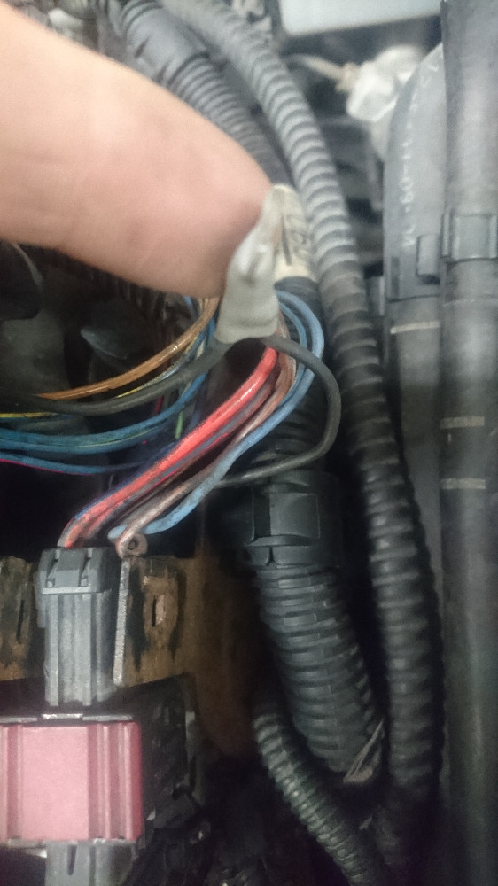

5 years 9 months ago #46154 by spit64
Replied by spit64 on topic Opel fuel trims
I don't know if it is the original coil pack but I doubt it because I guess that is no 1 item when people troubleshoot and repair they change it is easy.
It is an NGK coil pack and the owner bought an NGK coil pack but with the same problem I switched to the old one but I think the new one was never tested after a new crank sensor.
This is a picture of the ground wire to the coil pack the owner of the car or the dealership did this repair it was not a nice one and it did a loop around the other wires you never know if that could interfere with it is a picture before and after repair.
  • spit64

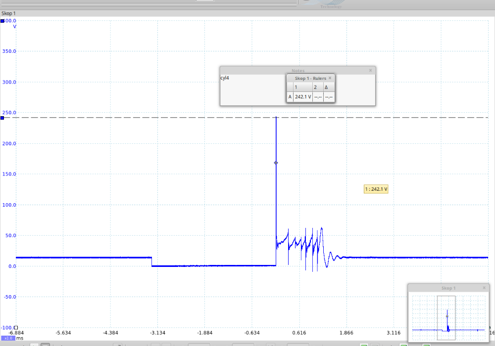

5 years 9 months ago - 5 years 9 months ago #46175 by spit64
Now the computer shot down the number four injector that's why the problem goes away when restarting the engine, there is no more double firing of the injector driving around for a great amount of time. I also have primary and secondary with ignition probe taken at startup in a warm garage.

5 years 9 months ago #46176 by Wightscope
Can't see much from the secondary, but it's the same as the primary anyway.
Pull the pack and take a look for carbon tracking on the plug or inside the boot.
Good idea to switch the pack back now you have fixed the crank sensor, if that does not fix it then maybe switch the plugs around and see if the problem moves.
That spark is going somewhere as you can see by the waveform. The leakage leaks into the 5v ref on the cam, confuses the ECU about where it is in the firing cycle causing the injector to fire twice.
At least that's the theory so far. Fix the spark leakage and you will have fixed it. Probably!
