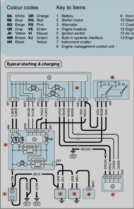

I have just purchased a wiring diagram from haynes hopefully this will help

10 years 3 months ago #638 by Tyler
Replied by Tyler on topic No crank
Awesome! We'll have a much easier time with a diagram available.
Any way you could take screenshots of the relevant diagrams and post them here?

So today I took the smaller wire off the solenoid and tested it, turn out that soon as I turn the ignition to the run position that wire is getting just under 12v but again when connected back on gets 0v I am not sure how this is happening as on the diagram if I remove fuse 8 and 13 it shouldn't get any power what's so ever but some how it is
  • mark.rumball
  • mark.rumball's Avatar Topic Author
10 years 3 months ago #645 by mark.rumball
Replied by mark.rumball on topic No crank
Tyler wrote: Awesome! We'll have a much easier time with a diagram available.
I am having trouble trying to upload the screenshot onto here as I am getting a message saying that the file size is too big, and if I put in the link it would require a log in, is there any other way I could get them to you?

10 years 3 months ago #655 by Tyler
Sigh, still not working :unsure: I don't think you're doing anything wrong, Mark. Maybe just e-mail me the pictures, and I'll see what I can do? wrenchturnyou@gmail.com

10 years 3 months ago #659 by Tyler
Don't thank me too soon, I realized I gave you the wrong address :oops: Try wrenchturnsyou@gmail.com. Man I suck at this tonight!
