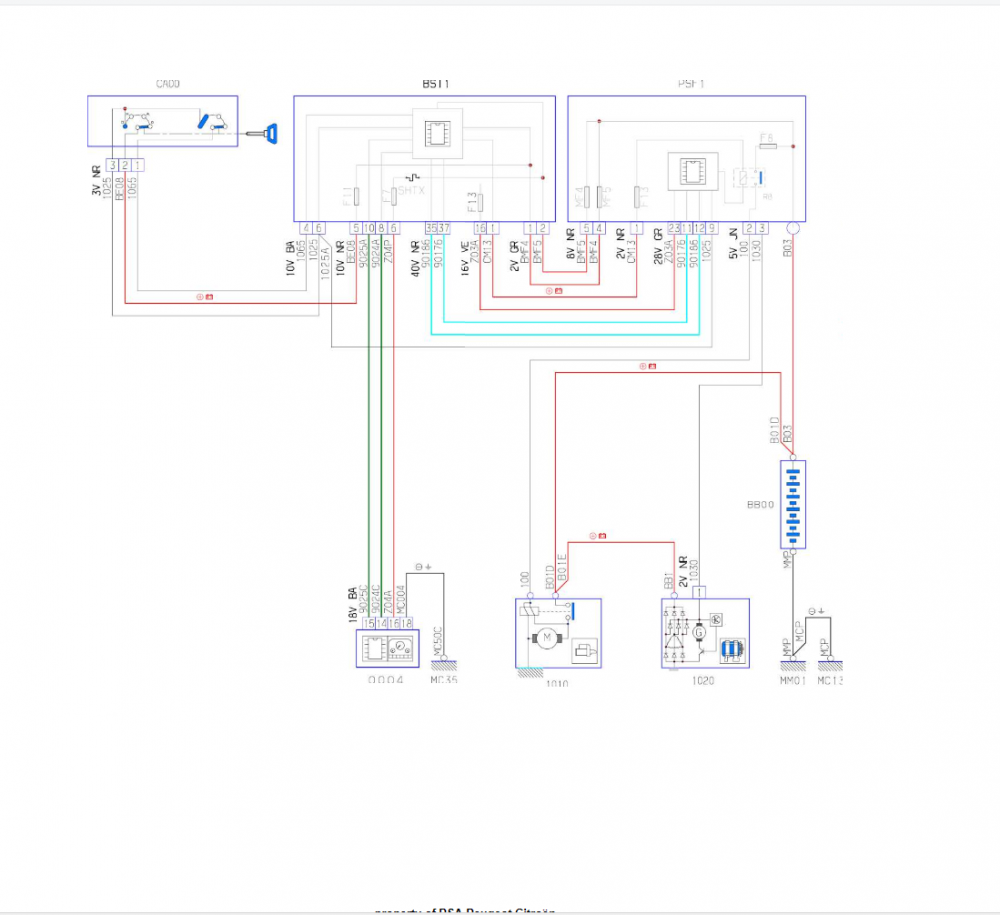

I can have a look on Carweb for a wiring diagram for you if you post or PM your reg & VIN
Also you can register on the peugeot website as an independent operator for info.
Once registers you can buy all the info you need public.servicebox.peugeot.com/pages/index.jsp
Added a generic 207 DV4 starter diagram for you.
PSF1 - Engine fusebox
BSI1 - BSI
1010 - Starter
1020 - Alternator
0004 - Instruments
HTH
Doc...

I wouldn't worry about F13 at the moment.
Is the voltage at pin 2 enough to light a test lamp connected to GND with F8 removed?
When key is turned to start measure the voltage at Pin 2 back-probed (F8 fitted)
As a double check, if you have an inductive Amp clamp then test for current flow on 100 - Pin 2 on cranking.
207 have issues with the loom running from engine fuse box, it is well worth giving the wires a good tug and visual inspection as you may have a short to power back feeding up the loom.
Hope this helps (HTH)
Doc...
PS, double check your engine GND and body GND - there should be two separate body GND points just behind the L/H headlamp, they are normally covered in grey sealer but water gets underneath the sealer and corrodes the grounds.

I like where Doc is going with this. Having 11V on pin 2 with fuse #8 out is screaming 'resistive short' to me. The voltage going to zero with the solenoid wire connected reinforces this. Looking at the pin numbers for the connector at PSF1, I see pins 4 and 5 getting fused battery power at all times. Wondering about corrosion between those pins and pin 2.
Mark, didn't you say you had this same symptom with both this fuse box and the old fuse box? If that's the case, then I'd say you don't need a fuse box at the moment. We may get there later, but I'd like to hear the results of Doc's suggested testing first.

I don't think a scanner is going to help you here Mark unless there are circuit faults stored for engine bay components that run through the same loom.
remove the connector in the fusebox and look carefully for any signs of corrosion or water ingress in the connectors.
Then reconnect the connector.
Put your voltmeter on battery ground and measure voltage on pin 2 (backprobed) with someone holding the key in the start position.
As they are doing this run your hand down the loom and stress the loom, paying attention to anywhere the loom contacts metal, or as Paul says is exposed to heat or vibration.
I am sure you are going to find a wiring fault in that loom.
