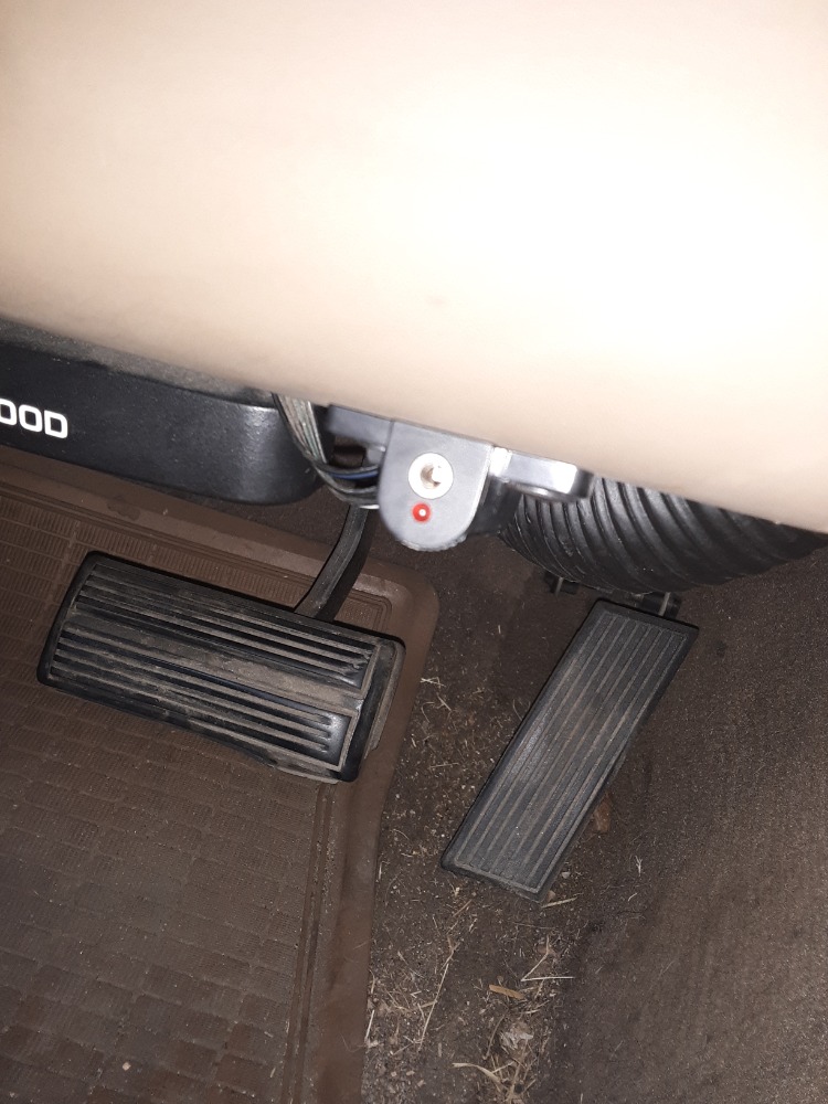

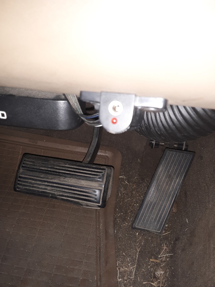

Not in the dashboard lights, but there is what looks like an auxiliary port, headphone port, with a red light that sits just under and to the right of steering wheel. I'm not sure if that is stock or aftermarket. That light flashes all the time. I read somewhere that the blinking led is also a button.

This thing. Not sure if it's aftermarket or not. Flashes even after I've used the keyless entry fob to unlock the doors.

No idea what that is. I would follow the wires and see if it was tapped into the dlc or obd port if so that might be the issue but i kinda doubt it.

Globeville wrote: This thing. Not sure if it's aftermarket or not. Flashes even after I've used the keyless entry fob to unlock the doors.
That thing looks like it might be an aftermarket immobilizer that requires something plugged into it.

What the heck, f@#$, is this thing! No crank, no start.

Just follow the wires going from it to under the dash. 2 wires from immobilizer will be connected to the start signal wire. Just get pics of what the wires connect to and we can walk you through removing it.

Like mentioned before, follow the wires, see where it goes. If there's a black box like for a remote start or alarm, unplug it.
