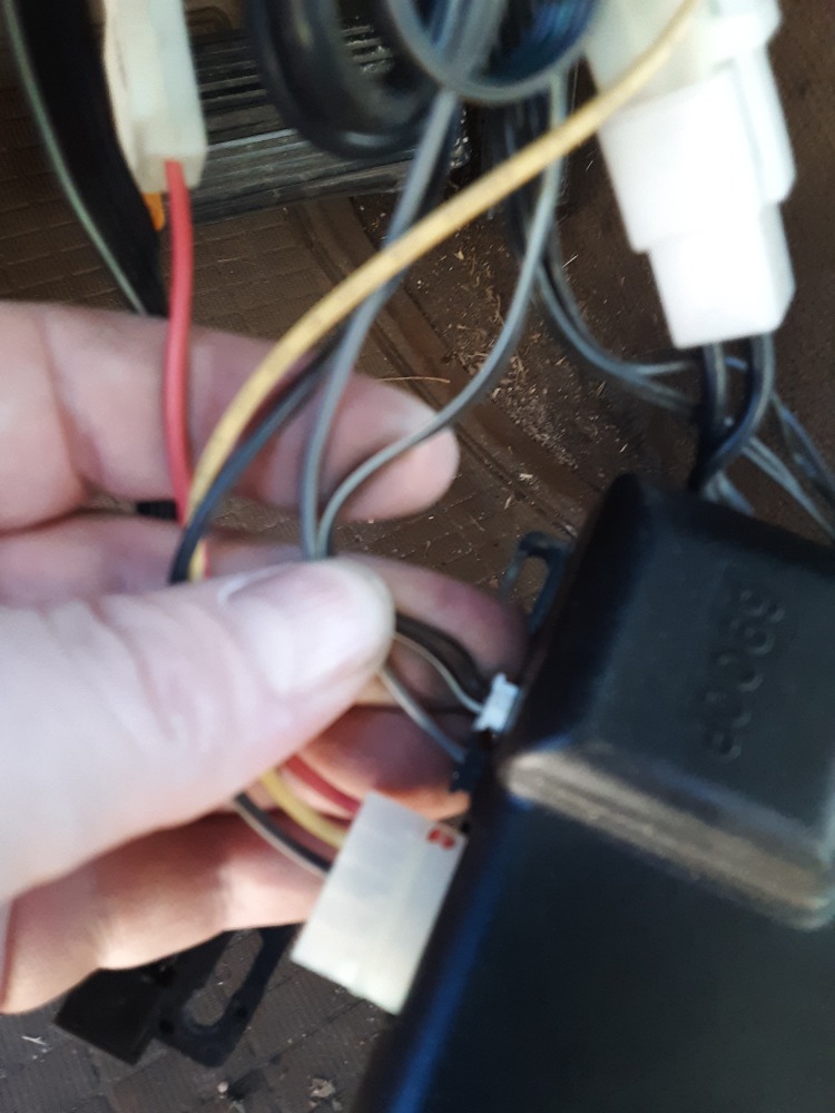

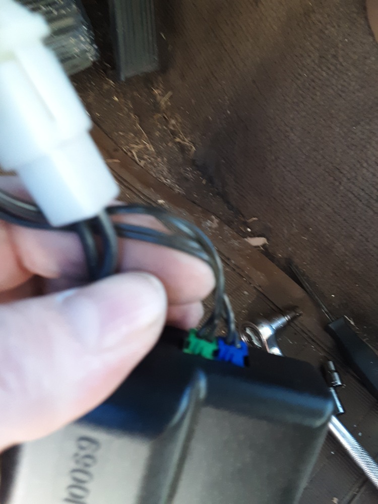

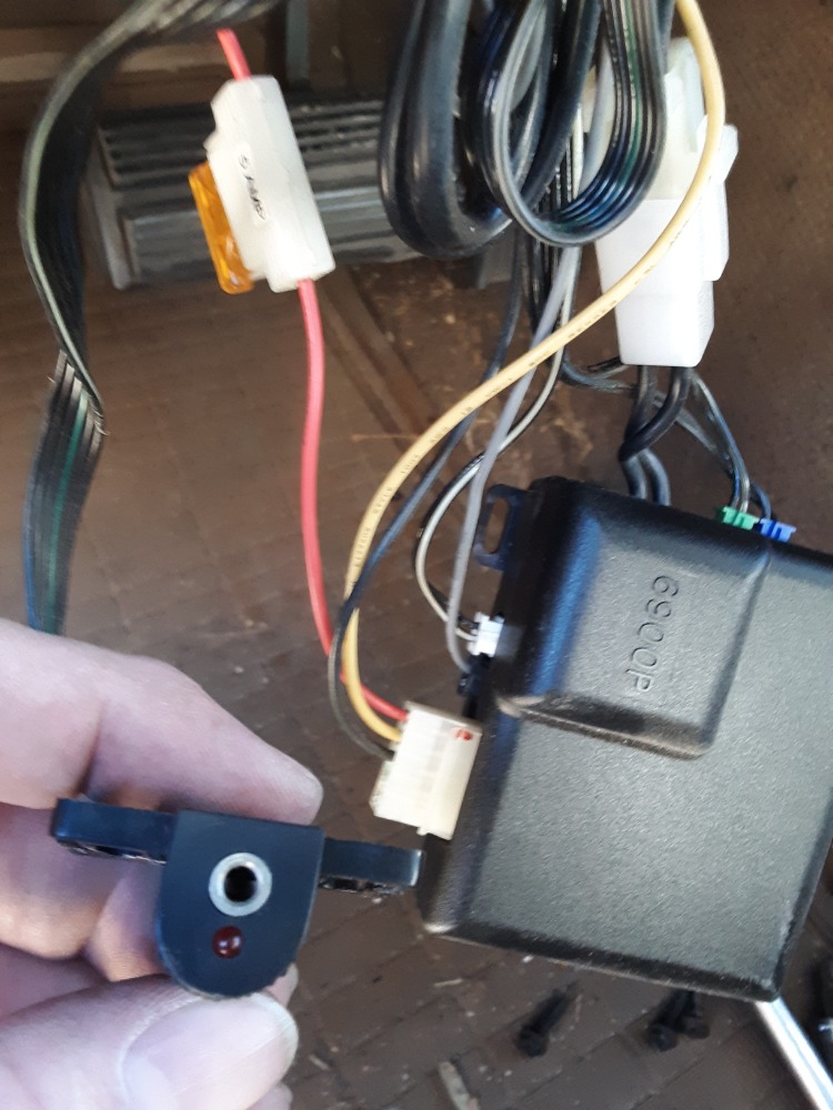

This is what is in there. How do I get rid of it? I tried to video the whole set up. I might have to take more pictures on all the connections.

5 years 10 months ago #44996 by Hardtopdr2
Replied by Hardtopdr2 on topic 99 Durango
Follow each wire up under dash around steering column one wire from column will go to two of the wires from alarm that will be the start signal wire from ignition switch. Reconnect that same colored wire back together and do this to remove the rest of wires. Then it should start.

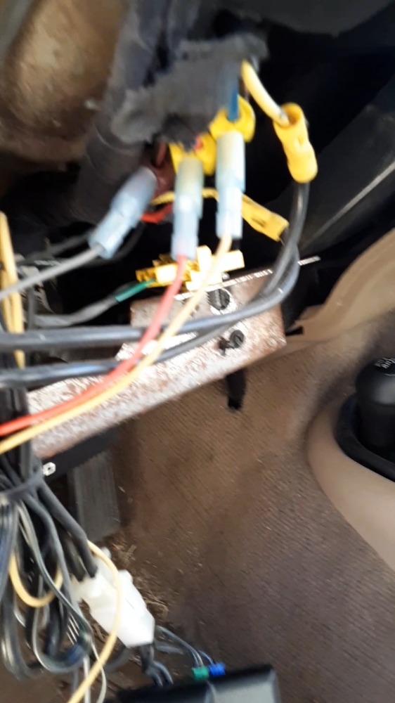

Just the one wire? Not all that are soft or hard wired to that device? Do you want better pictures? The more I looked at similar stuff online I realized that my pictures are horrible. Nothing showing the steering column or how those wires are spliced or where they go.

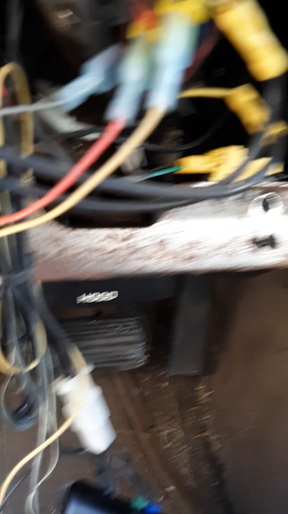

Just the one wire? Not all that are soft or hard wired to that device? Do you want better pictures? The more I looked at similar stuff online I realized that my pictures are horrible. Nothing showing the steering column or how those wires are spliced or where they go. Here's a couple screenshots from the video I took but can't attach here.
5 years 10 months ago #45006 by Noah
Replied by Noah on topic 99 Durango
I've always just unplugged the box when I suspect one. Generally the ignition wires are T'd into and not relocated so removing the box doesn't leave you with an open circuit

5 years 10 months ago #45008 by Globeville
Replied by Globeville on topic 99 Durango
I tried unplugging it and no start.
5 years 10 months ago #45010 by Matt T
Replied by Matt T on topic 99 Durango
It looks like they've cut the yellow wire and are running it thru' the box on the two black wires. If those are the black wires that land on a connector close to the box unplug it and jump the two terminals together on the vehicle side plug.

By jump do you mean bypass? If so, how do I make that permanent!?

It started when I jumped the vehicle side terminal! What's next! Can I splice the black wires together and call it done? The two black wires coming from the vehicle side terminal.

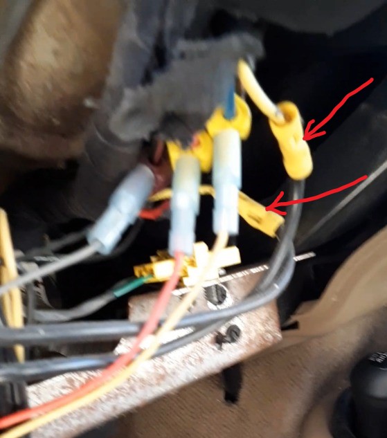

5 years 10 months ago #45322 by Globeville
5 years 10 months ago #45328 by Hardtopdr2
Just buy some butt crimp connectors and wire crimps then cut one of the two black wires on the yellow wire side of butt connector. then cut tye other black wire with some black wire left on it and using a butt connector reconnect the two yellow wires together. That should be the only wire used that is interupted with antitheft. Then cut free remaining wires going to antitheft and seal up with electrical tape so no bare exposed wire is exposed.

5 years 9 months ago #45799 by Globeville
Fucking thing is fixed!! Thank you to Hardtopdr2, Noah, Matt T, Tyler and ScannerDanner!!!
