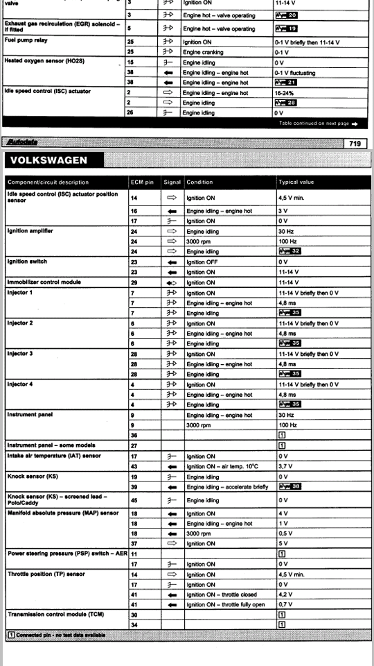

When i tested the output wire, key on engine off i get just a little under 5v. I thought that was my problem.
I searched for data on this vehicle and i found autodata info on the mp9 ecu.
The data states, key on engine off i should get 4v on the map output wire.
I did test the harness as i mentioned but everything seems to be ok hence i asked if there is any other method that i can use in testing the harness (im not so educated in electronics and wirng so u will have to give me an indepth expl lol)
The ecu is mounted placed in the raintray (under front wipers) ecu is aluminium and corroded quite bad im assuming water seeped in and probably shorted something out.
I am failing on this vehicle and i will try any tests suggested

9 years 8 months ago #5988 by Ash03
Number 18 is the map sensor output
