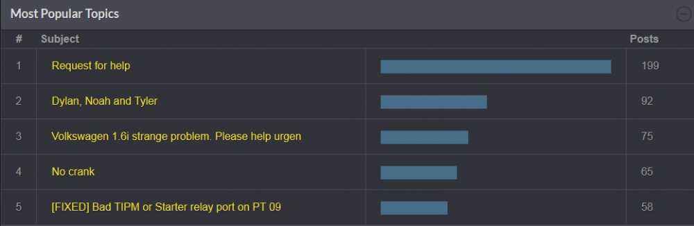

9 years 8 months ago #6494 by Tyler
I hate to interrupt you guys! Just wanted to point out how you've been climbing the statistics board:
  • Ash03
  • Ash03's Avatar Topic Author
9 years 8 months ago #6508 by Ash03
Lol is that a good or bad thing?
Sent from my SM-G531H using Tapatalk
9 years 8 months ago #6510 by Ben
Lol bad if you look at it as it's taken 8 pages to fix this thing! You get the bugs worked out of it yet?
9 years 8 months ago #6511 by Noah
Hey, if it was easy everyone would be a diagnostic tech.
I think it's a good thing for what it's worth. It shows determination, kudos to Ben for his continued support!
