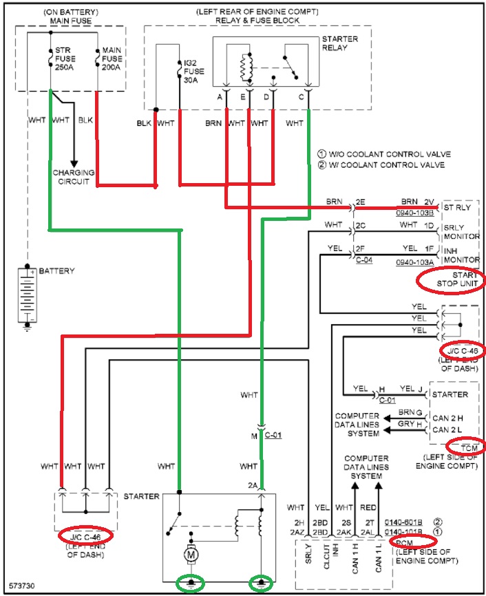

5 years 9 months ago #46060 by RJMARRA
Replied by RJMARRA on topic 2018 Mazda CX-5: no crank, no start
I have attached a diagram of your starting system. I have traced in green the "known good circuit" because you said you jumped the relay meaning the output side should be ok. I've made some red traces where your problem could lie, as well as circled some components in red which apparently all "talk" on the input side of the circuit.
If I were you I would start by taking voltage measurements at the relay on all pins. maybe you can narrow it down to one wire and and that will point us in a closer direction.
Probably wouldn't hurt to double check the 3 fuses listed in this diagram too. I know you have already checked them but in case you missed one or somehow one has blown since you last checked them by accident through one of your other tests.
Let us know.

RJMARRA wrote: I have attached a diagram of your starting system. I have traced in green the "known good circuit" because you said you jumped the relay meaning the output side should be ok. I've made some red traces where your problem could lie, as well as circled some components in red which apparently all "talk" on the input side of the circuit.
Let us know.
Thank you very much for that!! I was just looking at the diagram that Chad shared. I will take measurements and post back.

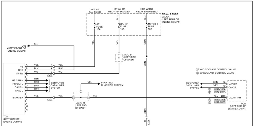

5 years 9 months ago #46076 by Matt T
Replied by Matt T on topic 2018 Mazda CX-5: no crank, no start
vallis wrote: Can I safely assume the network is good?
Network wiring appears to be OK but you haven't ruled out a network problem. There is probably something wrong with your Forscan set up or the vehicle network. Only reason I say probably is I'm not sure how Forscan will react if it can't read the VIN from the PCM.

5 years 9 months ago #46090 by Matt T
vallis wrote: The software does connect to the ELM327 adapter, I wonder if it is defective. I get "Connection to adapter has been established" with a green check mark, followed by an in-line and a pop-up error saying "Unable to connect to the vehicle. Please make sure the ignition key is ON and try again".
Did a little digging. It appears V.2 Forscan needs to grab the VIN from the PCM before it'll communicate with any other modules. And there doesn't appear to be any way to manually enter the VIN.
You could try uninstalling V.2 and installing V.1 to see if it finds anything.

5 years 9 months ago - 5 years 9 months ago #46093 by RJMARRA
Looking back to the starting system diagram it looks like the TCM talks on that network. Check the Powers and Grounds on it to make sure it's "awake". In the diagram attached, on the top 3 wires you should have:
( A ) +B : Battery Voltage at all times
( B ) GND: 0v or ground at all times
( C ) IG SW: Battery voltage with the key on
Can you confirm all 3 of those volatges?

  • vallis
  • vallis's Avatar Topic Author
5 years 9 months ago #46096 by vallis
Replied by vallis on topic 2018 Mazda CX-5: no crank, no start
- Power from the main fuse (200A) through IG2 fuse 30A is good. There is constant power to Pin D of the starter relay.
- There is constant power from the main starter fuse at the positive battery terminal to the starter.
- If I understood the diagram correctly, the Start Stop Unit sends power to Pin A of the starter relay, and the PCM grounds Pin E. I checked both pins with the test light by attaching one end to the + and the other to Pin E, but it did not light up. So this must mean there is no ground at the Pin. I did it the other way around for Pin A, no power when I push the start button.
With the ignition on, I supplied ground to Pin E and power to A, respectively, and it only cranked (I used a test light for Pin E as a ground medium to avoid cooking the PCM in case something goes wrong).
Does the power have to come directly from the Push button unit? Would it make a difference if I supplied power at the push button?
Any thoughts?

5 years 9 months ago #46100 by RJMARRA
vallis wrote: - - If I understood the diagram correctly, the Start Stop Unit sends power to Pin A of the starter relay, and the PCM grounds Pin E. I checked both pins with the test light by attaching one end to the + and the other to Pin E, but it did not light up. So this must mean there is no ground at the Pin. I did it the other way around for Pin A, no power when I push the start button.
Pin A is wired to the start/stop unit and pin E goes to a connector the goes to both the start stop and the PCM. It does not specify if which is power and which is ground, you will have to determine that with your test light. One will be power and one will be ground. If that isn't the case we just narrowed down your problem
