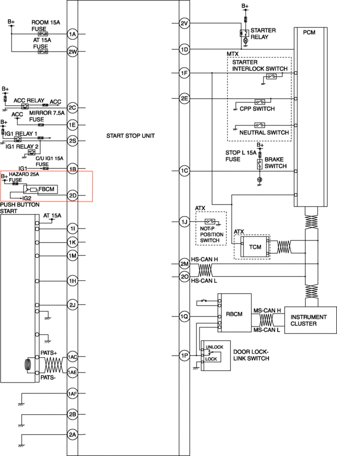

5 years 9 months ago #46315 by vallis
Replied by vallis on topic 2018 Mazda CX-5: no crank, no start
I took a step back to start diagnosing the ignition issue and noticed several things that are not working are associated with the ignition not being fully ON.
- The shifter is stuck in park
- No turn signals
- No door chime
- No OBD2 communication
etc.
Push button was tested per service manual. It's in a good working order. I suspected the issue would be related to the BCM. I pulled the wiring diagram and upon measuring voltage, the wire going from the Start Stop Unit (pink) to the BCM has no power when I push the start button. Please see attached diagram. I checked continuity/resistance of the wire, and found no open circuit. So this leaves me with the Start Stop Unit, described here: www.mcx5.org/start_stop_unit-1320.html , www.mcx5.org/start_stop_unit_removal_installation-1324.html .
I will be checking for voltage as shown in page 2 of the diagram. Is there anything you can think of that would cause the ignition to not be fully ON?

5 years 9 months ago #46322 by RJMARRA
Replied by RJMARRA on topic 2018 Mazda CX-5: no crank, no start
yes, where ever you found that diagram (assuming its accurate) verify all of those measurements!

5 years 9 months ago - 5 years 9 months ago #46338 by vallis
RJMARRA wrote: yes, where ever you found that diagram (assuming its accurate) verify all of those measurements!
In the diagram that I attached, the pink wire goes from the BCM to the Start Stop unit, not the other way around. That wire should have power when the ignition is on, but it's dead. Please see attachment to this post. The power comes from the battery through Hazard fuse 25A, enters the BCM, then outputs to Start Stop unit at pin 2D. This matches the pink wire in previous diagram. So, the start and stop unit does not receive power and it's not the only thing as some other accessories aren't working. I don't know if this confirms that the BCM is bad but it appears to be the case.
Back to IG2, the previous diagram shows IG2 RLY, but I can't find it anywhere, only IG2 fuse. Is it built in the Start Stop unit? Would you happen to have the front BCM diagram? The one I have isn't as detailed.
Thank you!!

5 years 9 months ago #46339 by Matt T
Replied by Matt T on topic 2018 Mazda CX-5: no crank, no start
vallis wrote: In the diagram that I attached, the pink wire goes from the BCM to the Start Stop unit, not the other way around. That wire should have power when the ignition is on, but it's dead. Please see attachment to this post. The power comes from the battery through Hazard fuse 25A, enters the BCM, then outputs to Start Stop unit at pin 2D. This matches the pink wire in previous diagram. So, the start and stop unit does not receive power and it's not the only thing as some other accessories aren't working. I don't know if this confirms that the BCM is bad but it appears to be the case.
IG2 "Relay" is solid state inside the FBCM if that diagram you posted is accurate. It switches the feed from the Hazard fuse to the IG2 circuit. The pink wire is the control for it. Can't tell from the diagram which of the two modules applies control voltage to that wire or what that voltage should be. And without a scan tool you don't even know whether the vehicle is attempting to turn IG2 on.
You need to find a way to scan the vehicle to move forward with diagnosing this.

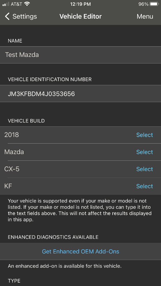

vallis wrote: I have been trying to scan it but no success.
Do you know anybody with a pro level scan tool? Or even a bluetooth dongle might work with an app that'll scan all modules and let you manually enter the VIN. I've connected to a Nissan with a dead PCM with my MX+.

I don't know anyone who has scan tools. I have Forscan with activated license that is supposed to work, but I will have to try a different scanner.
Is this the one that you have? www.amazon.com/OBDLink-Bluetooth-Profess...&s=automotive&sr=1-2
5 years 9 months ago #46433 by Matt T
vallis wrote: Is this the one that you have?
Yeah that's it. I pulled a VIN from ebay and it ID'd it as a 2018 Mazda. Had to manually select CX-5 and the KF option from pull downs. Shows enhanced diag available which should cover all modules on both the HS and MS CAN networks. That'll be codes and PIDs only. Their software doesn't include bi-directional controls or service functions.
Couple things before you pull the trigger on one. First the enhanced OEM stuff is only available for free in the phone apps. Their windows program is OBD-II only, but I think you can maybe pay to get some OE stuff in it.
Second I ain't saying it will communicate with your vehicle with the PCM offline. Just that it might.

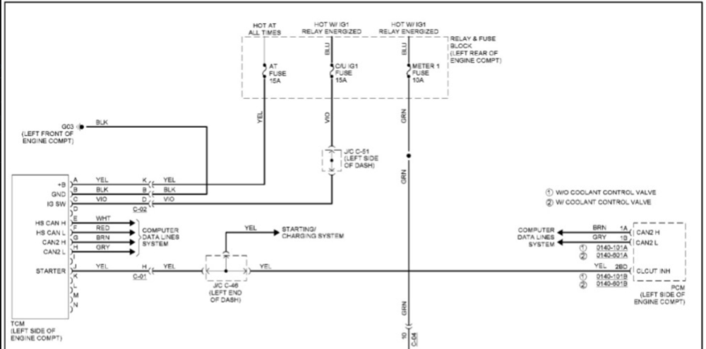

Back with an update. I started disconnecting the modules and noticed something unusual. In the video below, as soon as I unplug the TCM (built into the control valve body), many of the accessories returned to normal, including the dash board chime, turn signals, and climate fan. The buzzing you hear in the beginning of the video is the throttle body. The fan noise is the interior fan kicking in as soon as the TCM is unplugged. I set it to high so I can hear it. Same behavior with the Electric Parking Brake module. I did not unplug all modules (I plan to) but it's not the case with the PCM.
As I was unplugging and replugging both modules, at one point the interior fan was still on with the TCM plugged in, I trying cranking it and it and started up. this time it did not die, but there was no communication. I turned it off and on about 5 times and it continued to start right up. But, when I disconnected the battery, the issue came back.
@RJMARRA, I measured voltage at the TCM pins per the diagram you shared (re-attached) and I have constant power at A, Ground at B and power at C when ignition is on.
Could there be a short in the data lines?

5 years 9 months ago #46512 by RJMARRA
It is possible to have a short in the data lines, you can ohm test them. You must disconnect both sides of the line so it is not connected to anything. Take an ohm meter to both ends of the same wire which should be easy if both sides are unplugged and the wire is isolated. then after you get that reading do the same test but connect to one end of the wire (both sides still unplugged) and the other side to ground. if you have a reading there is a short to ground. you want to see OL
