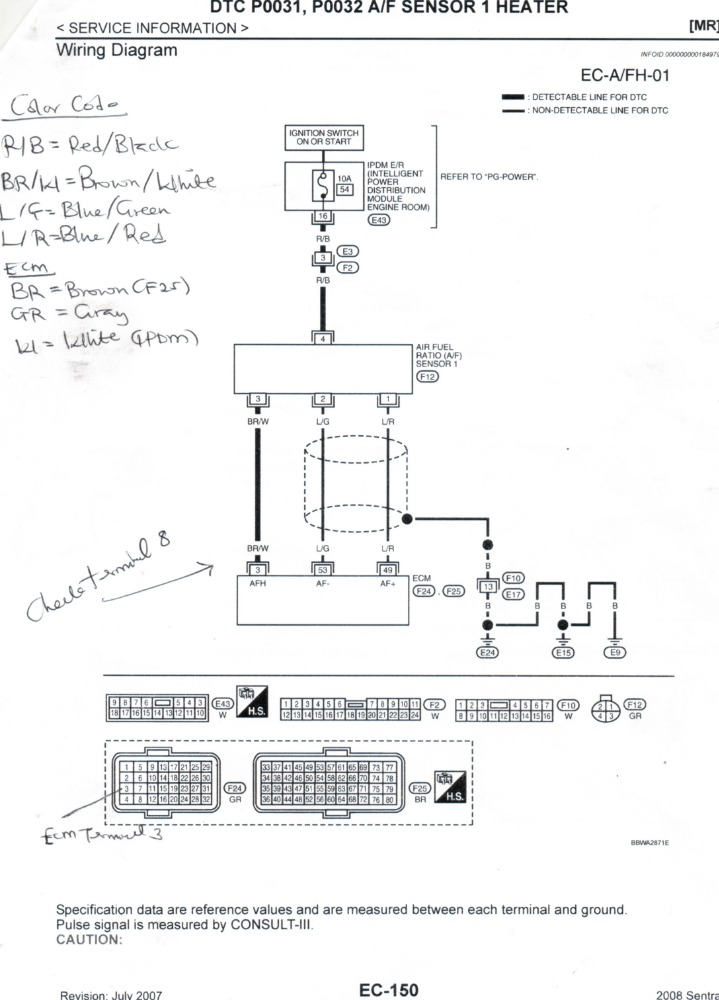

Sure, wiring diagram attached

Sure, i unplugged the 02 harness and KOEO the signal wire is 12 volts (Have checked for short power and ground cant see any), wire is not melted or whatsoever.
The sensor or harness plug pins is not rusted, sprayed electrical cleaners to them already.
Which one is the ground wire?
Can you help with the FSM/Wiring diagram i have attached to direct me?

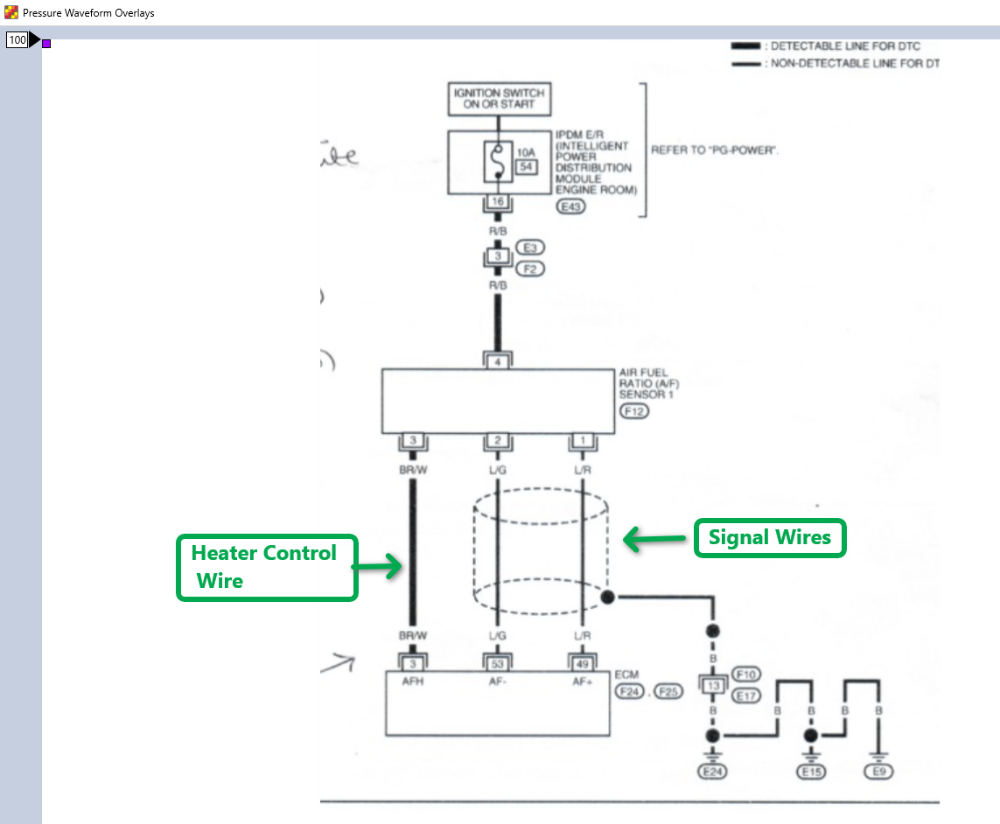

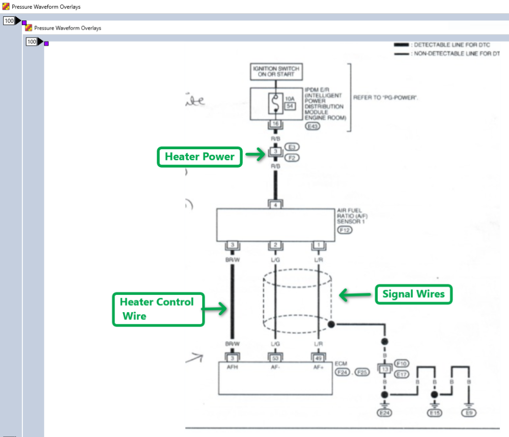

The Brn/Wht wire is the heater control. If you are measuring 12v on the Br/w wire, with the sensor disconnected, it is possible that you are seeing a bias voltage. To test this, take an incandescent test-light, connected to ground, and touch the heater control (Br/w) wire with the test-light probe. If it is a bias voltage the test light will NOT light, and the voltage will drop to near zero. If the heater control wire is shorted to power, the test-light will illuminate.

The test recommended by Chad is KOEO with the sensor unplugged. If you try it plugged in the heater will pass more than enough current to illuminate a test light.
Mariowinax1 wrote: What's the name of the wire coming from the IPDM to ECM/ PCM terminal 3; that has constant 12v.
If you mean the red and brown wire from IPDM to the AFR terminal 4 t's the power feed for the heater. 12V is good for that wire. If it's a power feed from the IPDM direct to the ECM I wouldn't worry about that for now.
Voltage readings you took on the blue signal wires also appear to be correct, and shouldn't have anything to do with a heater code according to SI.

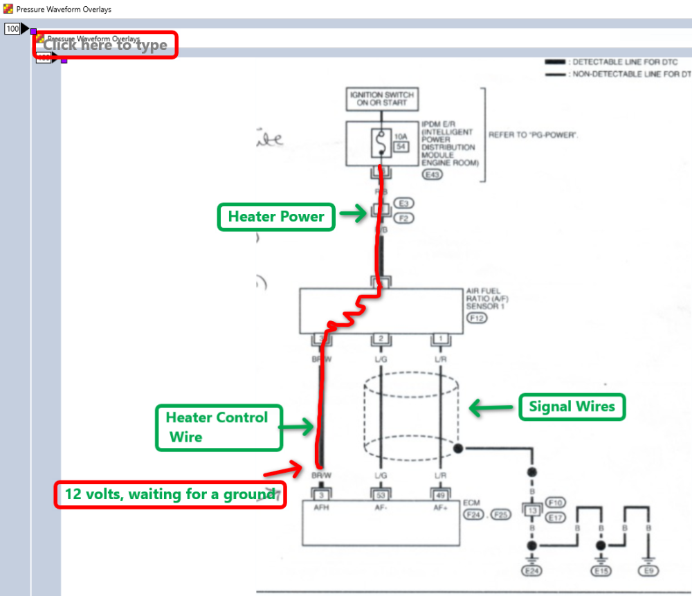

5 years 8 months ago - 5 years 8 months ago #46873 by Chad
Replied by Chad on topic Re:Help Help P0032
This is done at KOEO or engine running ?...Should I connect the 02 sensor to the harness while doing this and backprobe it.
KOEO, sensor connector disconnected.
I don't see a wire going from the IPDM to ECM Pin 3. The only wire coming from the IPDM is the Heater Power.

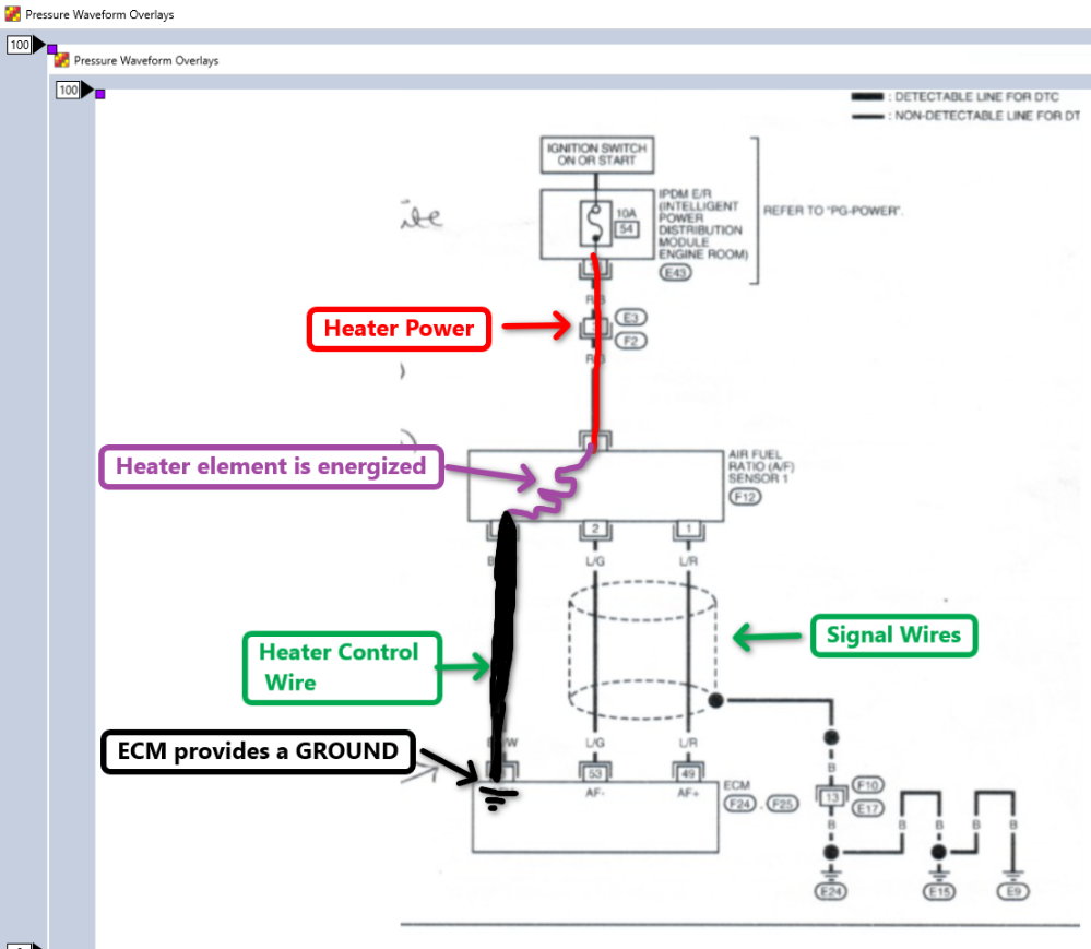

ECM Pin 3 is the BR/W Heater Control wire. If the sensor is disconnect, it may have a 12 volt bias. Test for this with a test-light, as I have described.
If the sensor is CONNECTED, and the ECM has NOT energized the heater circuit, KOEO you will read the 12v, from the Heater Power, coming THROUGH the heater element, waiting for a ground from the ECM.
When the ECM energizes the Heater circuit, it applies a GROUND to the Heater control wire.

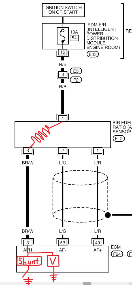

According to SI it ain't that simple. Looks to be PWM control so you'll never measure 0V on the control wire. Also sounds like there is a shunt inside the ECM with voltage sensing upstream of it. That sensed voltage being too high is what pops the P0032. If the control wire isn't shorted to power ECM grounds would be the next thing to go after. After that are the replacement AFRs OEM or aftermarket?
