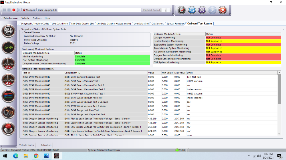

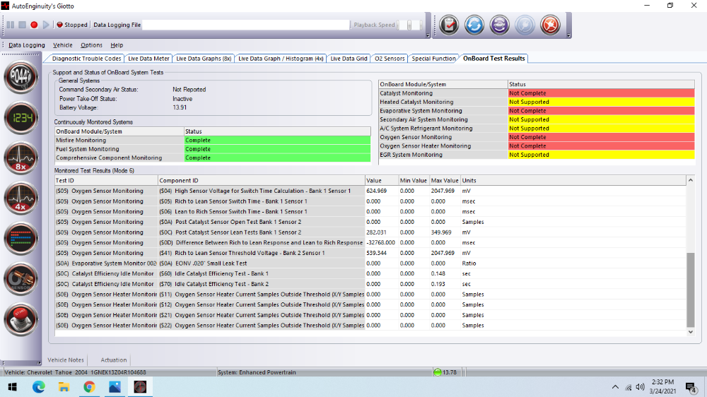

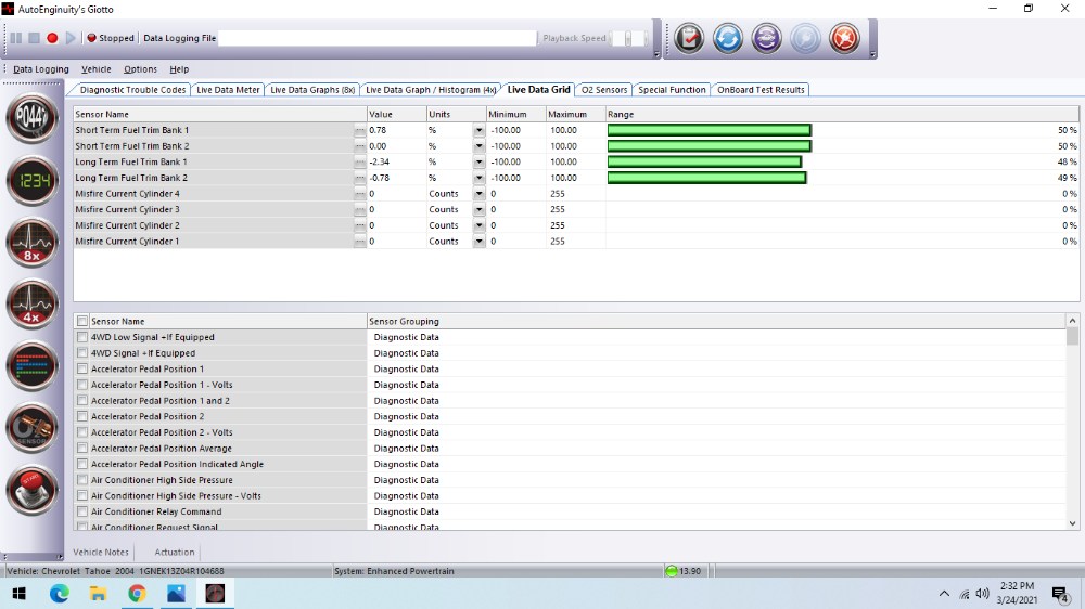

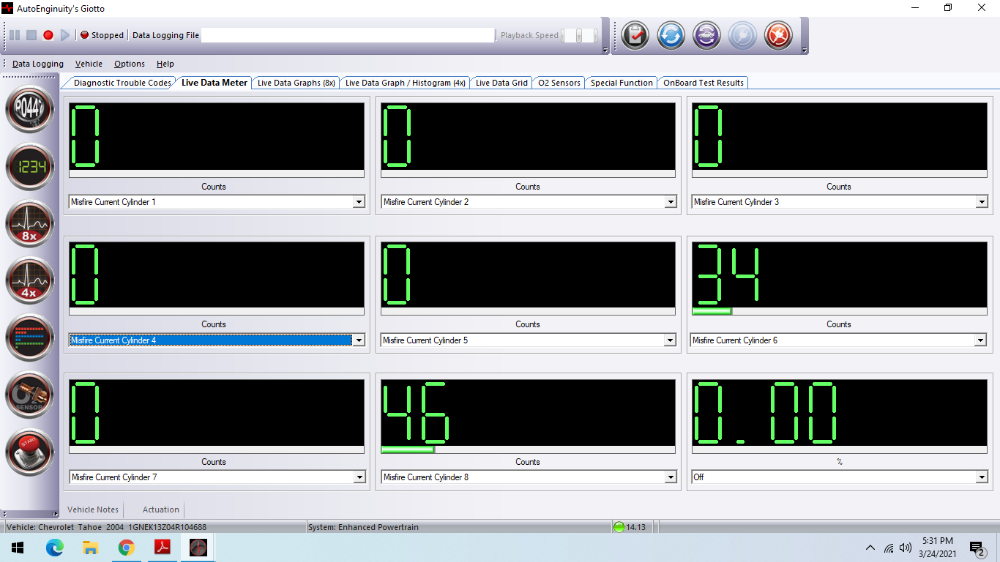

2004 Tahoe z71 z flex fuel. Cant seem to be able to copy and paste all info here but have added screen shots.
P0300 is only code.
Tested all the usual stuff again would post results but copy and paste not working.

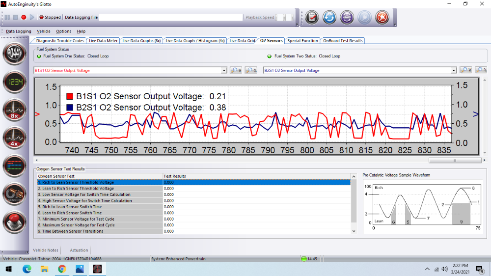

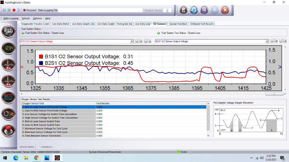

  • welj31
  • welj31's Avatar Topic Author
5 years 7 months ago #47704 by welj31
Replied by welj31 on topic Problem child

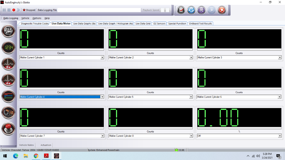

Screen shots after warmed up

5 years 7 months ago #47707 by Tyler
Replied by Tyler on topic Problem child
Thanks for the screenshots! Much appreciated.

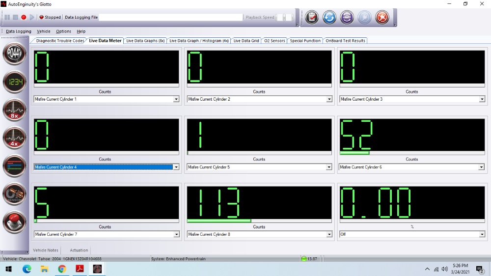

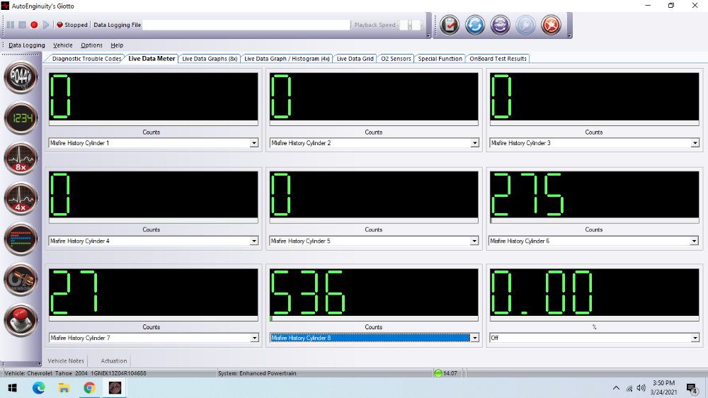

Do any of the Misfire History Cylinder __ PIDs show counts? They should since the P0300 is stored.
Speaking of, when does the Freeze Frame data say the code set? Idle, WOT, cruise? Cold, hot?

5 years 7 months ago #47708 by welj31
yes you can feel the mis fires less so after warm but still present. no scope

Tyler wrote: Thanks for the screenshots! Much appreciated.
i am not sure how to get to FF data but here is count

5 years 7 months ago #47714 by Tyler
Were there any history miss counts on cylinder #7 or #8? If not, it sure looks like #5 is the main offender. Does the #5 Current counter tick up at idle, or while driving?
5 years 7 months ago #47716 by welj31
Just swapped coils around again and misfire remains in 8/6.

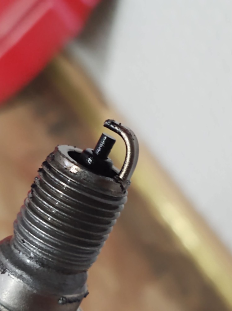

5 years 7 months ago #47717 by welj31
welj31 wrote: Just swapped coils around again and misfire remains in 8/6.
this is #8 plug
5 years 7 months ago - 5 years 7 months ago #47718 by Tyler
Sorry, I was misreading Giotto. :blush: So the miss counts are on #6 and #8.
Watch the Current miss counts to see under what conditions they tick up.
EDIT: Never mind. That plug sure looks like a dead misfire.
Are you able to do a relative compression test? Or, do you know what to listen for when doing a clear flood crank?

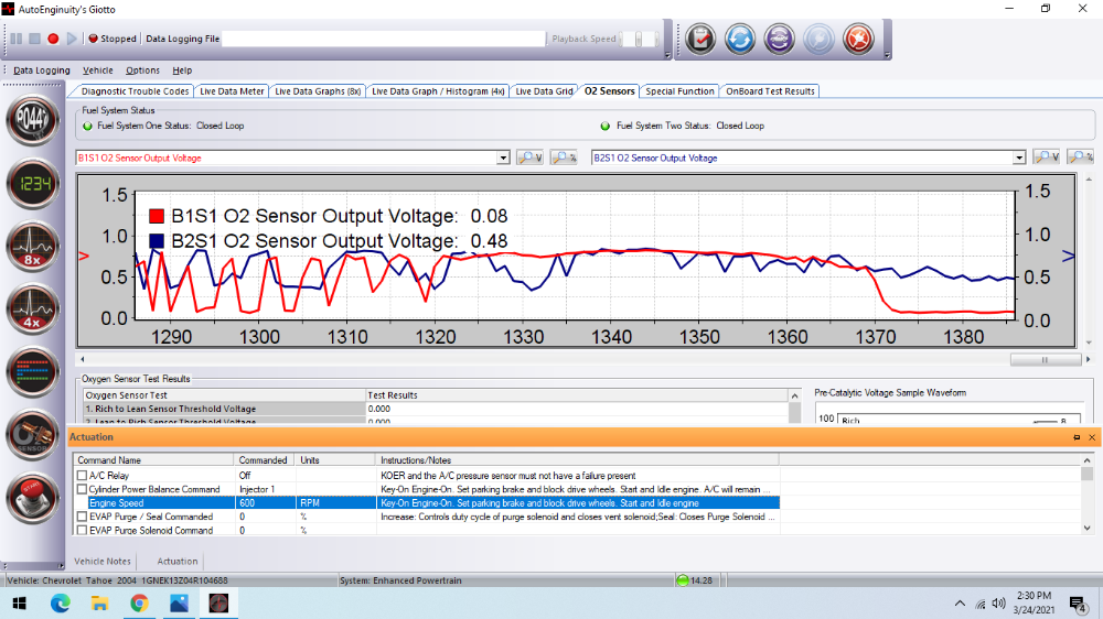

  • welj31
5 years 7 months ago #47722 by welj31

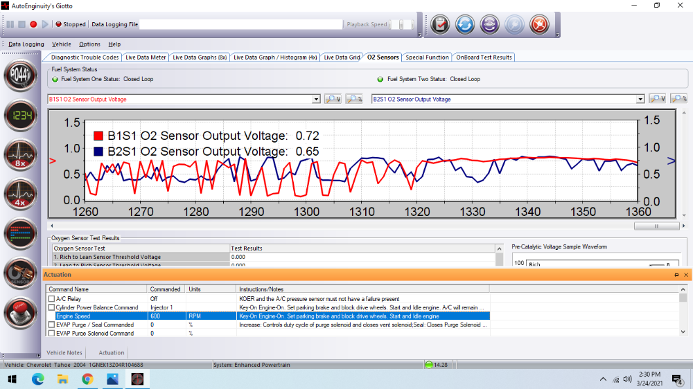

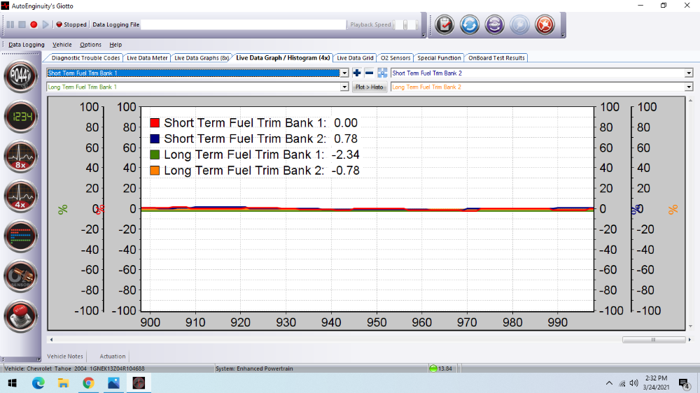

will do thanks for the help
pic one is at 600 rpm
pic two is at 1000 rpm
pic three is at 1500 rpm

just swapped plug around its good

That #8 plug looks pretty wet. Is it oil or fuel?
  • welj31
5 years 7 months ago #47726 by welj31
it is wet but i cant tell what it it. smells odd not like fuel or coolant

  • welj31
5 years 7 months ago - 5 years 7 months ago #47729 by welj31
i swapped plug 8 with plug 2. no scanner says misfire is in cylinder 1/6 WTH? will try the flood crank now.......cranks normal no odd ups or downs

5 years 7 months ago #47730 by VegasJAK
Replied by VegasJAK on topic Problem child
Hmmm. Has to be oil then. Compression on #8 looks Ok, but if oil is in the cylinder you will get a high compression rate as a posed to a dry cylinder. Does the pressure bleed off?
Put your thumb over plug hole and crank. Can you tell now if oil or ?
