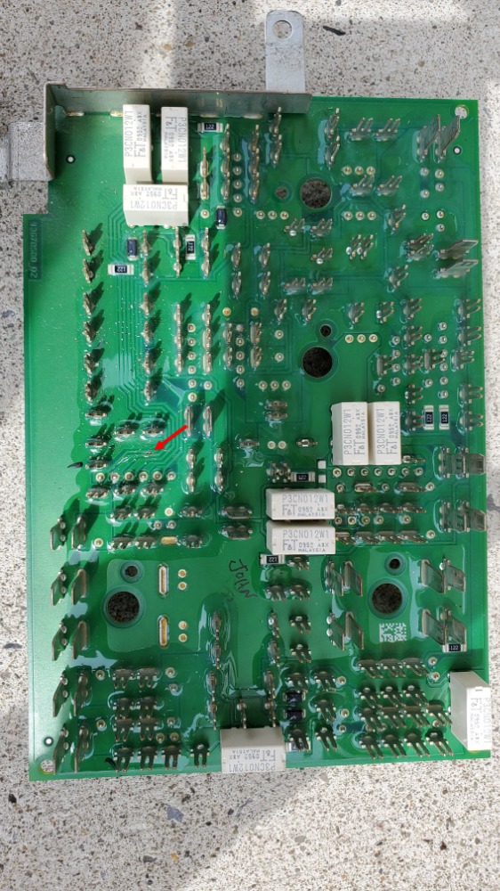

I took apart the fuse box and I can see a burnt trace on the circuit board. I purchased a used 2010 equinox fuse box on eBay put it in and got crazy instrument lights etc found out it must be programmed. I am in the process of checking out how to get it programmed. This eBay fuse box also had a broken 80 amp fuse connection that was broken I contacted the seller and he told me to keep the fuse box and he will refund my $43.00 dollars, and so I kept the fuse box with all the fuses and relays, and the seller did refund my money. Nice
Here are the tests I ran so far
Sunday 06_27_2021 using the power probe 3
I put the bad fuse box circuit board, with the "burnt trace" in the eBay fuse box housing case, with no 80A fuse because the fuse connectors are broken off on this eBay fuse box case. I then removed the starter relay and with the key in the on position, I jumped the starter relay base terminal 30 to terminal 87. The car started and kept running with instrument lights on and no check engine light. I then turned the key to the off position and then turned the key to the start position and I have no instrument lights and the check engine light is on.

Conclusion
I have a 10.2v voltage drop on terminal 85, which is the positive control side to the starter relay coil, with the key in the start position, I have no instrument lights and the check engine light is on.
So please advise should I put in a programmed circuit board into the fusebox, or should I check other sensors first, or what?

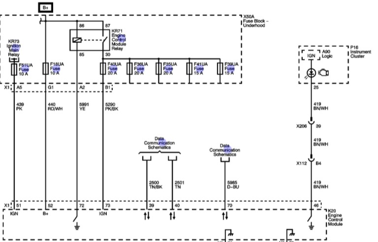

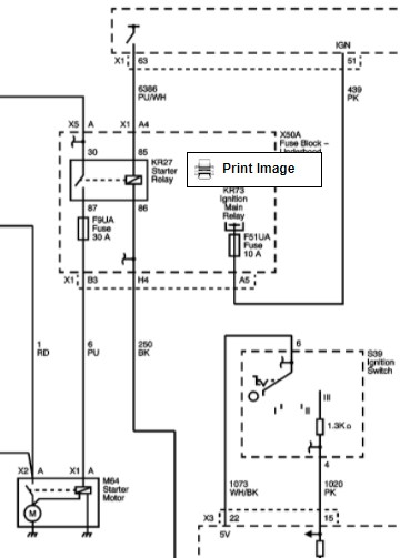

5 years 4 months ago #49657 by Tyler
Here's a snip of the OE diagram, for everyone following along:

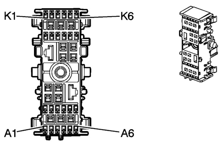

I'd stay with the positive side of the starter relay for now. Install your relay jumper WITHOUT the relay and check terminal 85 with an incandescent test light connected to B- with the key in crank. Does it light? If yes, swap a different relay in and retest.
If no, unclip the fuse box from its carrier and flip it over (if possible). Connector X1, terminal A4:
Again, test light to B-, see if A4 lights up. If yes, there's high resistance between terminal A4 and terminal 85 in the fuse box. If no, we're headed towards the ECM. You can use your PP3 for these tests, but an incandescent test light really would be better. B)
No offense meant, but are you positive that the X50A Underhood Fuse Box has to be programmed? Because I looked it up in the Control Module Reference - X50A isn't on it. :unsure:

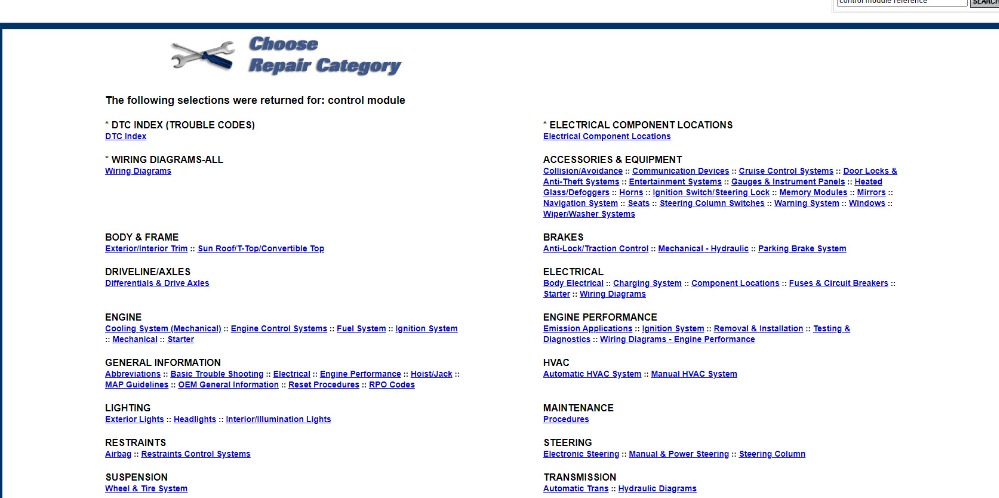

I have Mitchelle1 with a 1-year subscription. Can you tell me how to find the "Control Module Reference - X50A" in Mitchell1. in regards to how to determine if programming is necessary, I find navigating in Mitxhell1 is not really easy for a novice.

Search Mitchell1 for Control Module Reference. It's the document you refer to if you're performing a module replacement, or considering one. If it requires programming, what relearns/resets are required, like that. If the part you're replacing isn't on it, you're good to go. There are also entries on there that say, '_______ module doesn't require programming'.

I searched Control Module Reference on Mitchelle1, this is what my choices are. Can you tell me which one to choose? Please see attachment     Thanks

5 years 4 months ago #49671 by Tyler
The easiest way to find Control Module Reference may be to pick an engine DTC and look up the diagnostic procedure. The document we want will usually be linked after the procedure suggests a module replacement.
The test light test tells us that the relay and fuse box are good (enough). In fact, it proves out just about everything BUT the PCM.
The next move is to recheck voltage at the same violet/white wire at the PCM. I'll find the connector in a bit.

5 years 4 months ago #49677 by Matt T
Search for P1682 in Mitchell. Hopefully that'll tell you what Ign circuit #2 is and provide a link to the wiring diagrams for it. Look for anything related to the fuse block on those diagrams.
There is an Ign circuit from the fuse block to the PCM shown on the wiring diagram Tyler posted. That might be a good place to start since you already have access to the back of the fuse block.

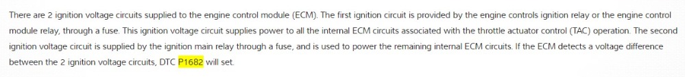

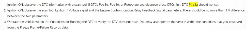

5 years 4 months ago #49678 by Tyler
We're not quite ready to call a PCM yet. :silly: There's still a few more boxes to tick.
Matt T is right, the other two codes could be tied in. Do those codes reset if you clear them and attempt to start the car with everything connected?
P1682 has some pretty specific detection logic:
The circuits in question show up on several diagrams, but this was the only one that showed both:
As long as you're at the fuse box, it's easy enough to check fuse #40 and #51 for power on both sides of the fuse, key on. Use the test light, not the PP3. ;) I really don't think you'll see a problem? Because as you said, the engine runs well otherwise. But hey, it's easy enough.
What kind of scan tool do you have available? If it'll read OEM data, you can also check the associated PIDs in the ECM scan data to get a quick idea:

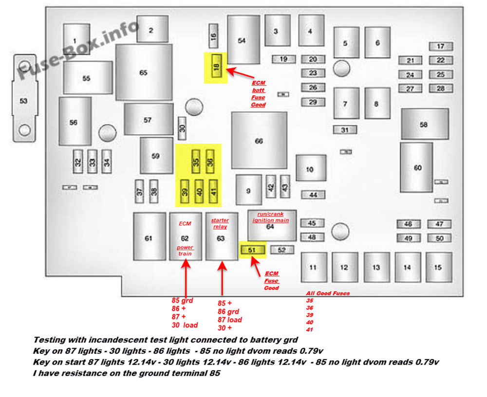

5 years 4 months ago - 5 years 4 months ago #49681 by Wightscope
I'm not Matt or Tyler
Does P0615 starter relay control circuit come back when cleared as I would think that will set any time you remove the relay
With 12v on 86 there would have been 12v at the ECM driver output (and the bias voltage resistor/diode) but no current assuming transistor was open, if there was any (shorted) current voltage would drop to 0 across the relay coil.
Does the line from 86 go directly to ground? The dwg helpfully posted by Tyler has that section cut off.
I am thinking to look at what else is shared on that ground, neither a test light or relay coil has much of a draw so the high current might have fried the ground and anything beefier is going to be struggling - perhaps something linked to the codes, or the ECU...
Last edit: 5 years 4 months ago by Wightscope.

Did more testing and this is what I have so far. This is results from relay 62 ECM relay/ Power Train Relay.
Last edit: 5 years 4 months ago by stspringer.
5 years 4 months ago - 5 years 4 months ago #49711 by Wightscope
Edit - which relay are you testing with your results in black
