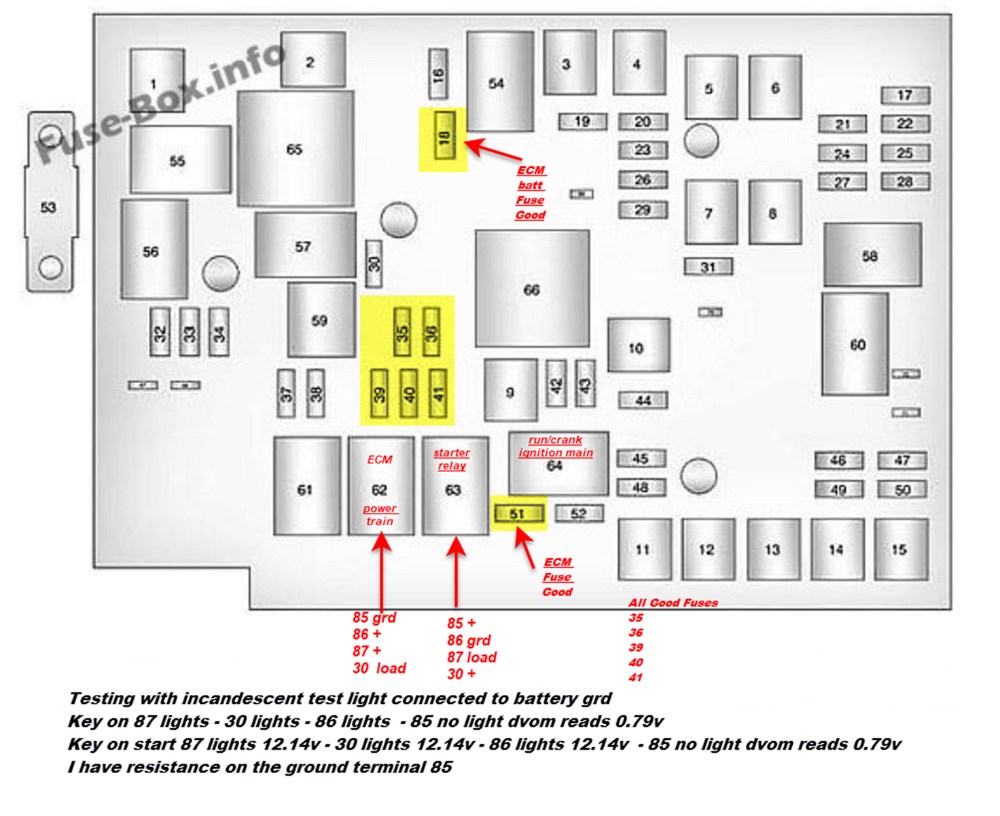

2010 chevey equinox 2.4 L, no crank, no start, U0100 P0615 P1682
- stspringer
- Posts: 17
- Thank you received: 2
5 years 4 months ago - 5 years 4 months ago #49717
by stspringer
Replied by stspringer on topic 2010 chevey equinox 2.4 L, no crank, no start, U0100 P0615 P1682
I was testing relay 62 the ECM /Power train relay. I am trying to upload a larger photo

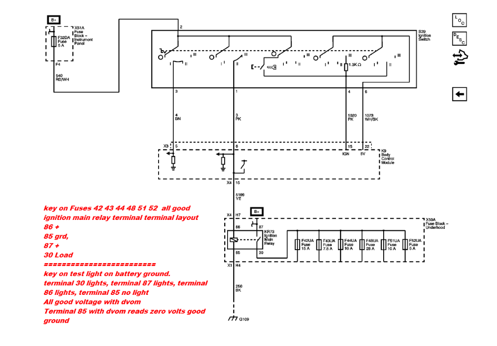

5 years 4 months ago - 5 years 4 months ago #49720
by stspringer
My tests on the ignition main relay #64 Please see attachment photo
Last edit: 5 years 4 months ago by stspringer.

- Wightscope
- Posts: 132
- Thank you received: 30
5 years 4 months ago #49798
by Wightscope
Replied by Wightscope on topic 2010 chevey equinox 2.4 L, no crank, no start, U0100 P0615 P1682
go back to the starter relay and test voltage from Batt -ve to term 86 -whilst cranking with relay in.
If you have anything much more than 0v you have a bad earth.
