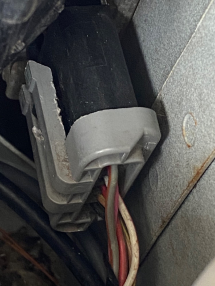

Can you take a picture of your ICM and post here? Also, explain what you mean by "the top wire"

I don’t have access to a scope but I will take pictures of the module with the connector. I think the top wire that I was testing was brown or tan. I read that the color of the module matters? I have a black one. Thanks for your help!!

Ok. I'll await the photo(s)

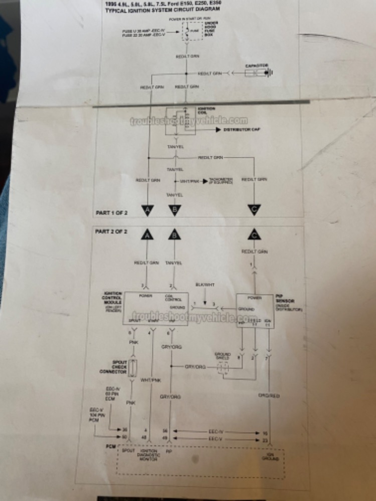

I tested the wires going to the module again. I have power, I have a ground, and I have a pip signal from the distributor. So I unplugged the module and the coil stopped sparking with the key in the run position. So I have inspected the harness and I can’t find anything obvious so if I plug the module back in and unplug the computer would that tell me anything? Something is shorted and I don’t know how to find it. Thanks

Power on pin 3, ground on pin 1. I tested the coil control on pin 2 with the test light and it flickered just like at the coil with koeo and koec so the circuit there is good. I tested the pip on pin 6 with my volt meter and the voltage was all over which I would think the icm is getting a pip signal from the distributor. I’m not sure how to test the power and ground with a load?

David117... I have a different pinout for your icm. Pin1 gry/o is pip from pcm, pin2 pink is spout from pcm, pin3 is wht/p 12v from pcm, pin4 is red/lg 12v from fuse panel for hot in start/run, pin5 is tan/v to coil and pin6 blk/w is ground to distributor.
In any event, I believe you're getting false signals from the pcm to the icm as you're getting pulsing spark in KOEO position as well as no fuel pump signal. I just hate calling a bad pcm and I'm not now, just pointing you in that direction. PCM sends icm signal to pulse based on inputs from sensors. If engine not cranking should not have pulsing spark at coil.

Ok, for giggles, pull the SPOUT connector. If you STILL have a pip signal KOEO than your problem has to be upstream from there. Can you grab a junk yard distributor and play swap-tonics?

I checked your pins with mine and they are the same just numbered different. My wiring diagram starts at the bottom of the plug with black being #1 and the top being #6. If I started at the top with #1 it would match what you have if I’m looking at it right.
4 years 7 months ago #54877 by washer
Replied by washer on topic 96 ford e350 with a 460 no start
This is why I suggested he remove the SPOUT. If I remember correctly, with that removed, there's not signal from the ECM to the ICM

I disconnected the spout connector and the coil started firing as it should. I gave it a shot of starting fluid and she started. Fuel pump still won’t run without jumping it. Does this mean I need a new computer?
