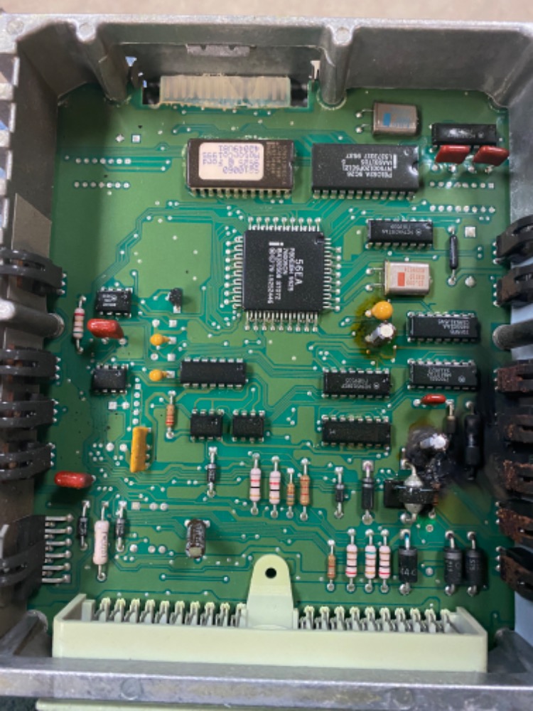

4 years 7 months ago #54978 by David117
Replied by David117 on topic 96 ford e350 with a 460 no start
I pulled the computer and opened it up and there’s no doubt it has some fried circuits. My question is how do I determine what fried it? I don’t want to install a new computer just to fry it too!! Please advise!! Thanks!!

4 years 7 months ago #54981 by David117
Look at all of the rust and corrosion on the right side. I would have thought the computer would be sealed to prevent the moisture from getting in?

4 years 7 months ago #54982 by David117
Where would be the best place to get a new computer? Oreillys said they can get one for a 200.00 dollars that’s plug and play or should I try to find one in a salvage yard?
