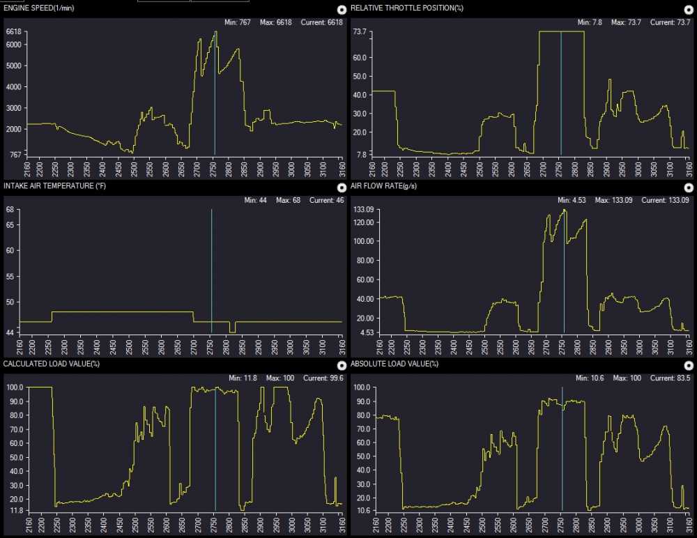

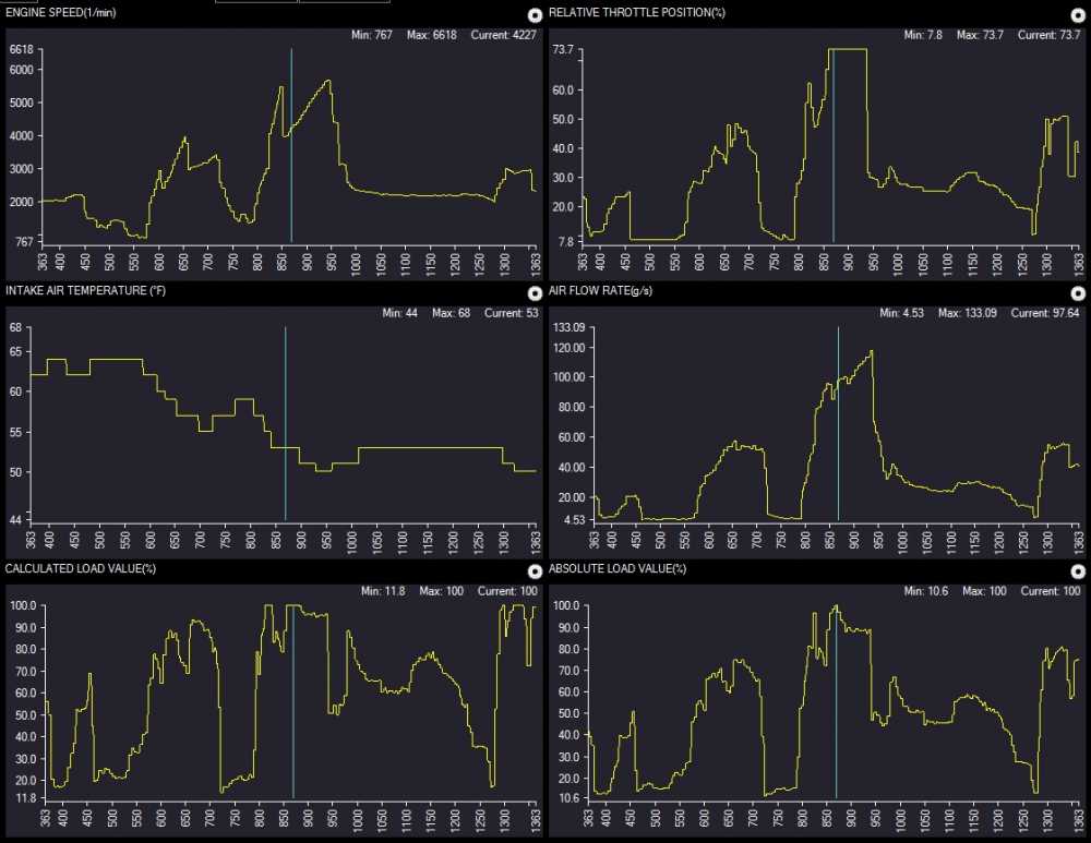

Had a chance to play with these PIDs on a '12 Equinox, 2.4L.
www.scanshare.io/share/5nqWnZxps0umg8srqy7IKw#0,1,2,3,4,5,6,7

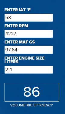

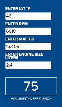

First thing I noticed was the Absolute Load reading of 100% at one point... That's an impressive volumetric efficiency! Actually, I think that's impossible on a piston engine... :huh:
And what does the volumetric efficiency calculator have to say about that?
86% VE is pretty good, but it's definitely not the 100% reading Absolute Load was telling us. :unsure: OK, maybe that was a fluke, let's look for the highest airflow rate instead.
This says our VE is still a healthy 83%. Calculator says...
Nope. Still doesn't match. :angry: I could live with a percent or two off, but not like this.
First experiment with Absolute Load, and I'm not impressed. I didn't have the opportunity to install any problems into this Equinox, but I'll be looking for the next opportunity.

Replied by Dylan on topic Calculated Load vs. Absolute Load
Agree :)
This a cool subject. I'm interested and learning. So can we actually state that Absolute Load equals the percentage of volumetric efficiency? When looking at the scan data and the VE calculator results, not really :unsure:
I wonder what's missing here.

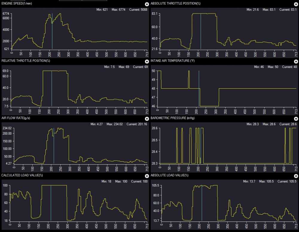

Round two! Got some more data off an '11 Enclave while test driving.
www.scanshare.io/share/iOuZpe1gy0KvSqqqbOnoqw#0,1,2,3,4,5,6,7
Yep, that's a reading of 105.5% Absolute Load. This thing ain't boosted, so that number is pretty optimistic. :lol: For giggles, I found the highest airflow rate and put the numbers into our VE calculator:
Pretty impressive, actually! :ohmy: I almost never see VE higher than 90%. Makes me wonder if this sensor data isn't accurate in some way...

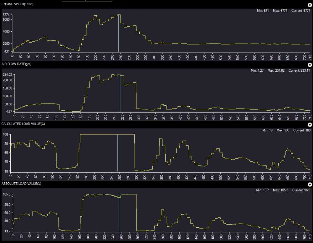

I have been mulling this one over I would think comparing the differences between the graphs of calculated load and absolute load on a test drive could be useful.
Sorry, ScanShare let me down on this one. I set the graphs up in ShopStream a bit differently, check it out:
The part of that SAE document where it said that Calculated Load corresponds to engine vacuum seems to make sense, as I'd expect a vacuum gauge on the manifold to read zero while at WOT (this engine does have a MAP sensor, but I couldn't find it on the Global list :blink:). However, a plugged exhaust will also zero a vacuum gauge, so... :unsure:
I think I'm better off sticking to whatever Load PID the OEM data gives me. :lol:

Ended up taking a class that helped answer some questions that came up in this thread.
1.) The 105% absolute load value I saw on the Enclave is perfectly normal. I'm told this is a product of VVT, and not unusual at all. Some have observed 110% on other engines at WOT. :cool:
2.) The OTC volumetric efficiency calculator is incorrect. :angry: I'll be comparing it to other brands of calculators in the near future, but for now I'm taking off the Service Info thread. This is why I got all kinds of wacky readings earlier... There IS a software issue, just not on the vehicle side! :blush:

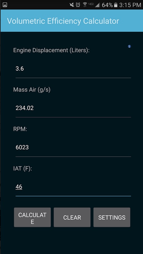

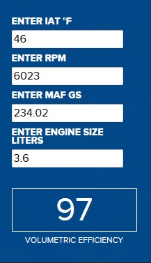

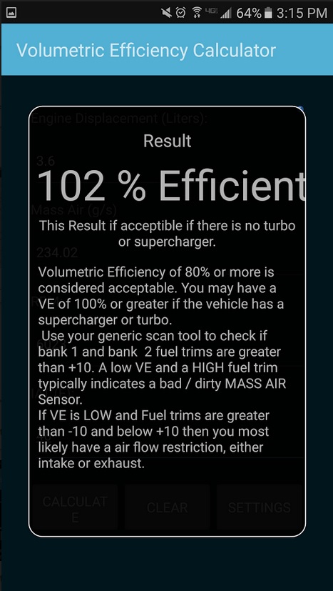

So like I said earlier, I had an instructor inform me that the OTC calculator is NOT accurate. :angry: I believe him, but I wanted to see for myself.
Last go-round with the OTC VE calculator, I came up with this on a '11 Enclave:
That's not a bad reading, by any means. But what happens when I put it into another calculator? I found VE Calculator on the Android Play Store for free. Same values:
Different result:
This is closer to the 105% value we saw from the Absolute Load PID in Global OBD. The 5% difference didn't matter in this case, but what if you had a genuine low power complaint? That difference might end up leading you down the wrong path...
And here I was thinking that VE was a standardized calculation, and not open to interpretation. :lol:

What's that app? I've been disappointed with the play store offerings of VE calculators...

Noah wrote: What's that app? I've been disappointed with the play store offerings of VE calculators...
I found it under VE Calculator. Maybe it'd be fun to take several for a spin? See how much variance there is out there.

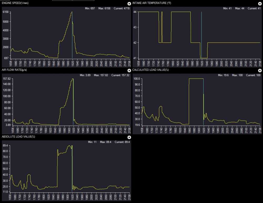

Decided to play a bit more with Absolute Load, this time on an '08 Escape. 3.0L engine, no VVT.
89% at the peak. This kinda makes sense compared to the '11 Enclave I tested earlier, which is supposed to use it's VVT at WOT to improve VE.
Still trying to build a baseline for what this PID should be doing on different engines. Maybe 80 - 90% for non-VVT engines, 90 - 105% for VVT?
