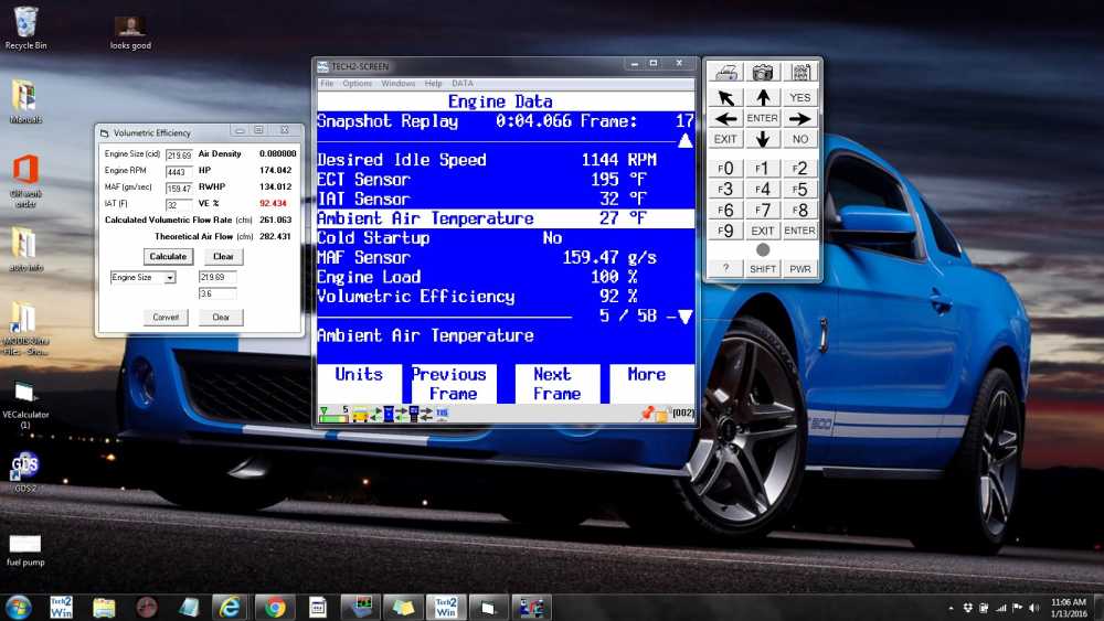

Sorry about the delay but here is the screenshot. I don't remember what vehicle it was but 92.434% on the calculator and 92% on the scan data.

Sweet! :cheer: That's what I was looking at the other day on another GM, didn't have time to really play with it.
I wonder if they're actually taking the Absolute Load PID from Global and renaming it Volumetric Efficiency in Enhanced data? :huh:

Thanks! Karma bump for you.
I'm also using Tech2 and I haven't noticed this PID... I'll keep it in mind that's for sure. Your VE calculator is from Windows store? Just asking cause we're talking about calculators since Tyler revealed that the one from OTC is crap and so we're on the hunt for a good one :lol:
Good question :S

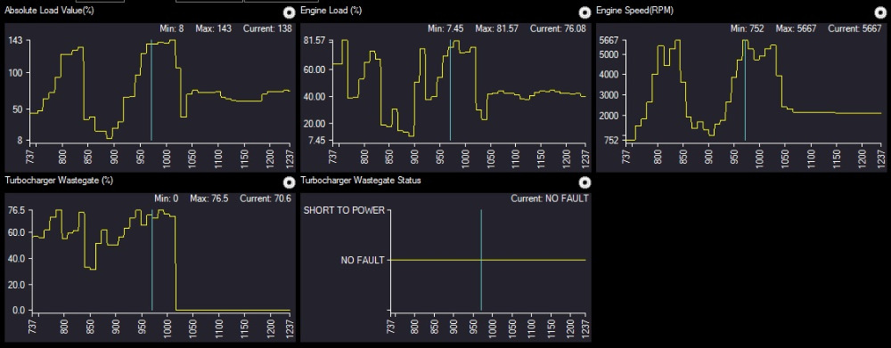

I also learned at Vision that Absolute Load is very useful for forced induction diagnostics, particularly on newer Ford EcoBoost engines. I'm told that a peak Absolute Load of 150-175% is typical on Ecoboost platforms. I ran into a '13 Edge with a turbocharger issue recently that became much more obvious once I started looking at Absolute Load.
This one had a wastegate problem that prevented maximum boost, and resulted in a DTC.

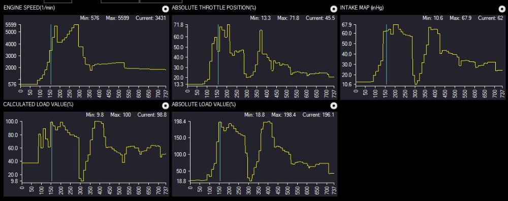

This shot is off a 'chipped' 3.5L F-150. Almost hit 200% Absolute Load. :ohmy:

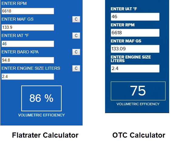

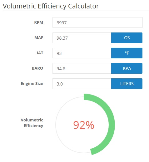

Hi Tyler
It looks like you are using the OTC calculator. It is not just broken, but it does not include BARO.
Here is a side by side comparison of one of your values. I added the baro from your capture on ScanShare
The ScanShare calculator code came from the Flatrater site.

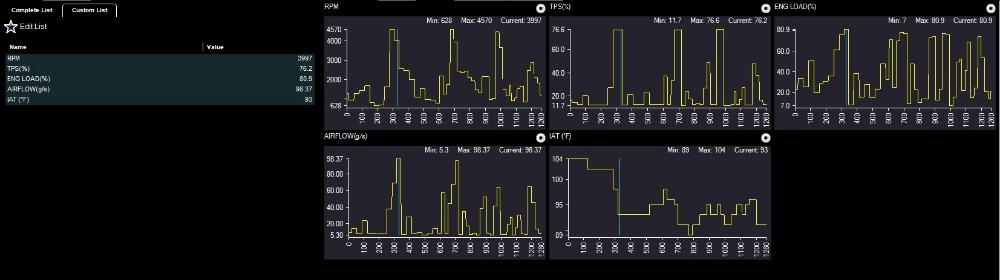

Not trying to be argumentative, but would you mind checking my understanding? I had a Lexus that I believe was a good example of a measurement error causing a low VE calculation.
'99 ES 300, 3.0L, dirty MAF numbers:

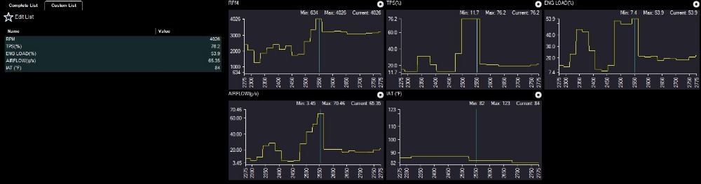

And after cleaning:
In this situation, both Load and VE showed low values. With the VE test alone, I'm not sure how a distinction could be made between a measurement or breathing problem. Not unless the upstream sensors are considered. Or, was that your point? :silly:
