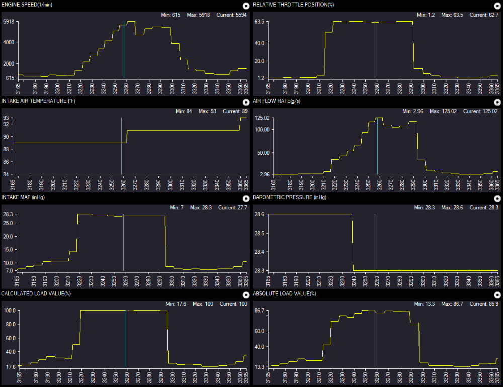

I'm going to start out by apologizing for how thrown together this will be. Hectic morning and a lot on my plate :-)
Yes, that was what I had in mind. I think you're already doing the same thing, I'm just suggesting it can be easier. Perhaps I even misunderstood you. Sorry if that is the case :-)
Perhaps this will help someone else, so I'll continue. As I'm sure you know, many technicians struggle with trim codes and power complaints. I think it mostly comes down to exposure, they just don't see enough problems to get good at it.
I can't read your data (too small), but let me describe how I would deal with what I assume was going on.
I'm guessing you had a P0171/P0174 and perhaps a lack of power. I would setup for a data capture and take a short drive. Idle in park, idle in drive, light load, moderate load, and WOT.
I would then reset the trim and do it again. Many systems use LTFT as a modifier in power enrichment mode and by resetting trim, I get a better idea of how healthy the MAF is.
Something fun to think about - how do we get LTFT corrections for an area of operation that disables trim learn? Sorry, just had to throw that in.
Back at the shop I'd take a look at the data. The best way to explain what I do with the data is with an example, but here are some thoughts.
Whether we use load or VE, there is a pretty wide range of good-bad, but I have found that by the time a code sets or there is a performance complaint due to a skewed MAF, both are usually (but not always) pretty low. A number of times I could pick this out without moving the vehicle (WOT with the brakes applied)
I'm going to interrupt myself here and suggest something... In between normal operation and a fail scenario, there is a good deal of change... In this "gray" area, performance is degraded and we can see it if we know what to look for. Ok, back to where I was going :-)
I use load since it is already on my scan tool. I think the push for using VE came from the various definitions of engine load that have been used on the enhanced side.
On a normally functioning system, at WOT I expect to see the upstream O2 (or AFS) to either go rich or keep toggling. The latter because many systems will still be in CL at WOT. Regardless if the system stays in CL or goes into OL enrichment, it should never go lower than stoich and stay there.
If I don't see that, then I use load to help determine whether I have a measurement error (MAF - which includes the ducting) or a fueling error. Mechanical errors (in which I include intake and exhaust restrictions) can be sorted out using the data as well.
If I'm dealing with the gray area that I mentioned above, my road test data capture can help me a great deal. For example, excessive engine ping. I find it is most often caused by the MAF under-reporting air flow (timing advanced).
There is so much more to explore. For example, the MAF output curve. It is not linear and as the sensor degrades, the errors will most often show up in a particular region before codes set etc.

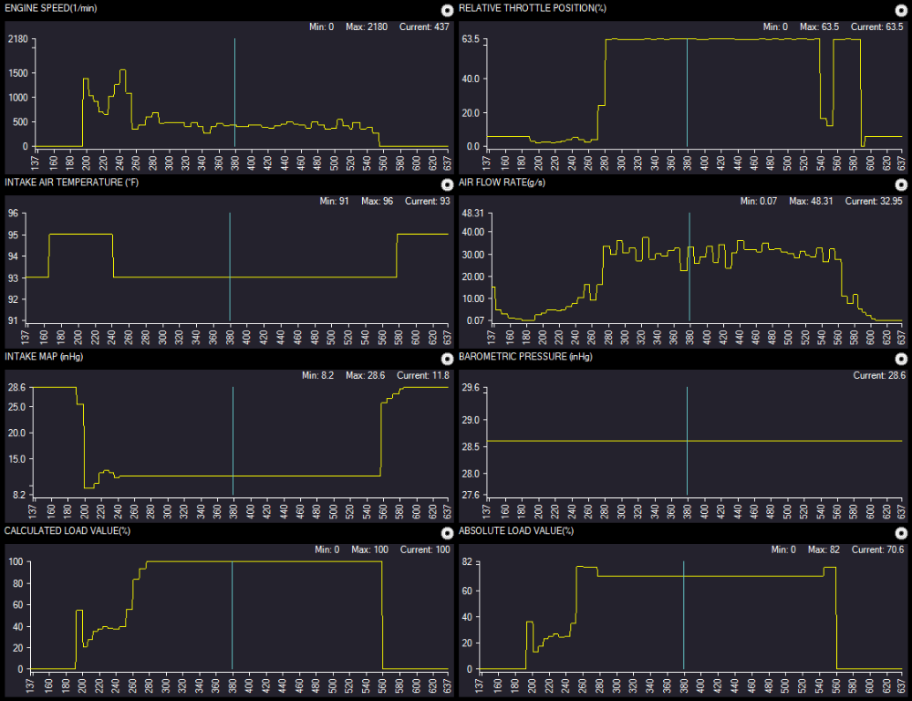

Posting up a truck that threw me for a loop recently. Seems like the Load PIDs kinda let me down... :(
'07 Ford F-150 has a noticeable lack of power from a stop, and at WOT. I took a drive with Global data, and saw these (reduced the PIDs down to the relevant parts):
Calculated Load says everything's good. 100%. But Absolute clearly isn't happy at 54%. I consult the ATG VE Calculator to break the tie:
Tough to argue with that. Calculated Load lied to me. :angry:
After the repair, I recheck the numbers:
Much better. B) Absolute Load = 1, Calculated Load = 0.
Last edit: 7 years 4 months ago by Tyler.
7 years 4 months ago #31240 by Flatrater
Replied by Flatrater on topic Calculated Load vs. Absolute Load
Hi Tyler
I noticed you've used global data. That's good, it means the load pids have very specific definitions.
Calculated load will be 100% at WOT, so if one is looking to use this to evaluate breathing or the MAF, it won't work. It is't meant to be used that way.
Absolute load tells you most of what you need to know. "Most", because it depends on what you're trying to determine.
Can you tell me what using the VE calculator added to your diagnosis?
  • Tyler's Avatar Topic Author
7 years 4 months ago #31241 by Tyler
Replied by Tyler on topic Calculated Load vs. Absolute Load
Flatrater wrote: I noticed you've used global data. That's good, it means the load pids have very specific definitions.
Because of you! :cheer: I started doing that regularly after our discussion earlier in this thread about varying Load calculations on the OE side.
Respectfully, are you sure? :huh: Without digging up specifics, I can recall many known good vehicles that didn't go to 100% Calculated Load at WOT. I'll check out some of my saved captures.
So, in the theoretical case of a dirty MAF sensor, you're saying Calculated Load will not show a low percentage?
Confidence, mostly. Absolute Load was definitely the red flag here, but running the VE calculation made me certain. The issue with this truck was actually installed by another technician, so I needed all the evidence I could get before going to management.

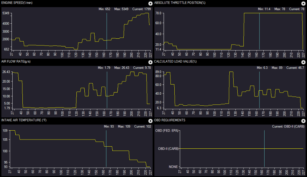

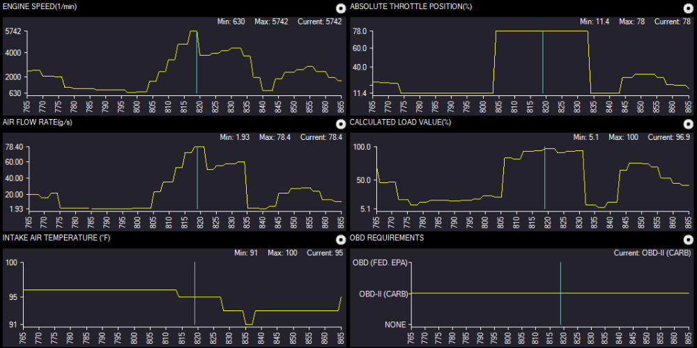

I typically see 99% instead of 100%. This is, of course, assuming there isn't a problem. The PID is essentially giving you cylinder loading which is used for spark and EGR scheduling etc.
I have been buried in other things for some time, so I would be very interested if you would post (or send) captures that illustrate what you are seeing.
Here is a capture of calculated load using a generic scan tool, but it is a 2006 Envoy. It doesn't follow the later rules. It does peak at 99%, but it is way high with far less throttle.
This was made with an AE scan tool interface and their phone app (Gioto).
www.scanshare.io/share/k7NNFC7RGEGLcnOte6_byg#0,1,4,5

First is an '04 Scion xA. I wanted to use this one because it was produced BEFORE Generic data definitions were changed. Known good:
A healthy 96%, but it doesn't flat line at 100% like newer vehicles. MAF only. Then I stuff a piece of cardboard in the air filter box:
Calc Load can't do better than 60%. I feel like this example of Load is a good reflection of a breathing issue.
Onto an '09 Ford Escape 2.5L. This one has Calc and Absolute Load, as well as a MAP. Known good:
Calc Load pretty much flat lines at 100%, and Absolute is telling the real story. Some more cardboard and another run:
Calc Load still says 100%, which agrees with your statement (and my F-150 with a real intake restriction) that it shouldn't be used for VE/diagnostic purposes.
So, I'd argue that Calculated Load can be useful for diagnostic purposes... depending on the year. :silly: Or more specifically, what standard of Global OBD is at work. Because probably 50% of the cars I work on are 10 years old or older, this is a worthwhile distinction for me.
