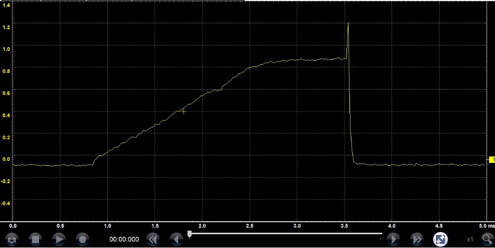

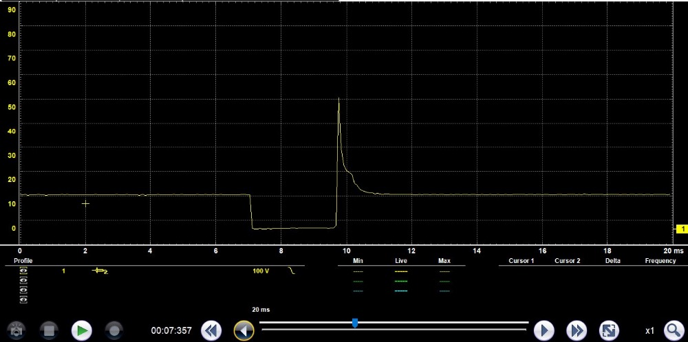

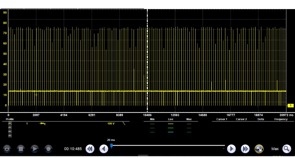

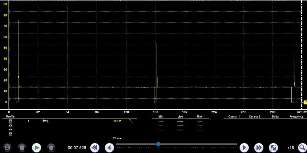

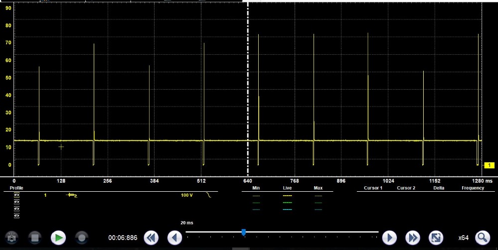

Greetings! I wasn’t sure if I should put this in repair or diagnostic forum because my primary question is concerning what I’m seeing on the waveforms. SO I went with diagnostic forum. Hope that’s okay? I would appreciate help viewing the screenshots attached to let me know if it is normal or if there is a problem. I tried searching online at waveforms and watching videos...found a lot...but I couldn’t locate anything that would definitively let me know if the spikes and drops I show on a fuel injector are just normal anomalies or not.
This is a 2011 Nissan Sentra S with a L4-2.0L (MR20DE) engine. The complaint is the there is a P0304 (or was…owner cleared it) and he can notice a misfire. I did a power balance test with only the #4 cylinder because you have to remove the intake to get to the rest. Engine RPM did slightly change when coil was disconnected. Owner has replaced spark plugs trying to resolve the problem with no success.
It was raining and I was in a rush in a parking lot doing this (didn’t want my tool to get wet :) ). So I haven’t done anything past the quick scoping you see here. My images are on the #4 fuel injector control wire. Backprobed at connecter for the injector firings & low amp probe on the control wire for the current ramp test. As you can see there are random drops in voltage on the injector firings (note: I’m only connected to the #4 injector). There are random glitches at the end of some of the current ramps.
The images are from a max zoom view and a 1x view they are labeled in the filename. I have both in the movie format also if someone wants to see that. My next step is to do a compression test, but before I did that I just need to learn if these random glitches and drops are normal or they indicate a problem with the injector or circuit? Thanks Folks!

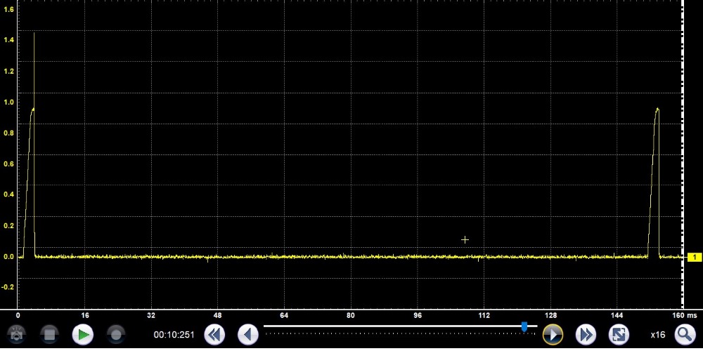

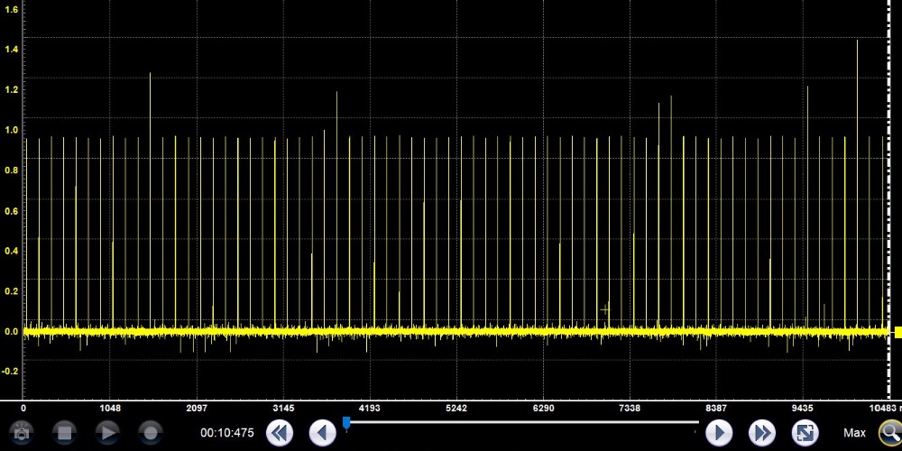

Here are ramps (#4 fuel injector control wire)...
8 years 5 months ago - 8 years 5 months ago #19455 by Chad
Replied by Chad on topic Fuel Injector Waveform Questions
The spike on the current ramp doesn't seem right, to me. Do you have two channels? I'd like to see the voltage wave and the current wave, together.

Unfortunately I don't have it in two channels. I couldn't fit the T-pin and gator along with the low amp clamp into the same area. It was very tight under the intake and it was raining and I was really rushing. If I'd had it in my garage I could have taken more time and had more lead choices.

I found a good article which states: "The flyback voltage is set for the electromagnetic coupling of the injector and the mechanical spring rate. The magnetic field around the injector winding is stored energy which is used to control the speed that the pintle is closing with."
Would the spike that some of the current ramps are showing indicate that the injector pintle is closing faster or slower than engineered? Not sure which it would be, but if it is randomly closing faster would the ramp spike indicate that the ECM zener diode still had some current control left, but the injector closed too fast the rest of the energy was dumped with no resistance...causing the random spikes? I'm completely spit-balling here and barely understand what I'm talking about. :blink:
The other question is, if my statement above is close to on target, how would I determine if it was the injector or circuit/ECM issue?

Did you have peak detect turned on for your current ramp capture? I ask because I see that it wasn't on for the voltage capture, and you can see the result in the inconsistent peak voltages. Not saying you were wrong to have it off, just trying to account for the peaks you're seeing.
Doing some spit-balling of my own, but I wonder when the ignition coil fires on #4? It could be that the coil is firing at the same time as the injector ramp is ending, and you're seeing RFI in the current waveform.
As for the misfire, I'm happy enough with the voltage waveform for now. You can see the pintle hump, so movement is happening. Could be a clogged injector, but I feel like that's further down the testing line. If it's a cold misfire, I'd dig into the intake gaskets or a leaking head gasket.

Tyler, peak detect was off for the current ramp also. I just took a look at the movie. I used the presets on the Vantage Pro.
I'm going to just have to tell the owner I need his car so I can take my time in my garage where I have all the tools also. Who knows...maybe this will be my first diagnostic customer. :) Then I will change my handle to "THE Technician". B) (Yeah...riiiight...got a hell of a ways to go to get promoted from Weekend Warrior) :)
