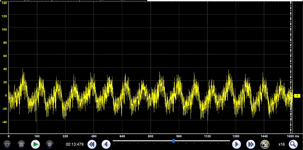

I do have Shopstream on my puter. I did have the relative compression original file on my Verus so I've attached a screenshot. I can also email the movie to you guys if you want to see it. Please let me know what you see that I did not. Don't be apprehensive about being critical please. Regretfully I did not use a second channel to identify one of the cylinders.

rockp2 wrote: I do have Shopstream on my puter. I did have the relative compression original file on my Verus so I've attached a screenshot. I can also email the movie to you guys if you want to see it. Please let me know what you see that I did not. Don't be apprehensive about being critical please. Regretfully I did not use a second channel to identify one of the cylinders.
I see it? But I also know there's an issue to see. :silly: It's very slight - I'm not sure if I'd have picked that out at first glance. Or, even if I did see it, I may not have pursued it in favor of other diagnostic directions.
Do you recall the settings you used for that capture? Mostly wondering if using the Filter option might have made the peaks less noisy. I dunno if that'd help for sure, just thinking out loud.

Yes pretty noticeable the red is the cylinder that is always higher after a low compression stroke the blue is your low compression it's easier to identify when you look at a pack of every fourth (for 4 cylinder)

I would have definitely went for a compression test based on that capture ( that is a what a low compression cylinder looks like).
Its obviously not dead which will be much lower but anytime there's a noticeable low fairly consistently and especially when followed by a higher cylinder in a consistent pattern like that it's time to do a compression test. Also like Tyler mentioned a filter would have helped some on making it more readable

Ben, thank you very much for taking the time to mark up my screen shot. That help's me immensely! I was looking for a much more pronounced drop.
I don't remember the settings I used. This was my first time doing a relative compression test with my brand new High Amp Probe. But I'm going to be doing some practicing to get it right.

rockp2 wrote: I don't remember the settings I used. This was my first time doing a relative compression test with my brand new High Amp Probe. But I'm going to be doing some practicing to get it right.
Ahhhhhhh, I was wondering why the trace was so noisy! Was it one of these?

No, it wasn't that one. It was the CA-600 from AES Wave with "custom" banana jack leads for a Verus.
