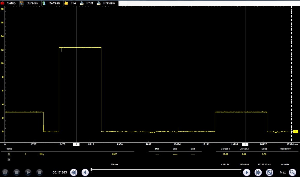

Guys, working on this car still. When I gave the car back the owner stated it ran better for a couple days and then went to crap again. Today I again did a power balance test. This time when I shut off fuel injector #4 (via my Maxisys) instead of bogging down the engine actually picked up a few hundred rpm?? It didn't do that last week. I disconnected the fuel injector and with KOEO I got B(+) on feed wire (other lead connected to B(-)) Good. But then when I connected to control wire (ground side switched) I got 2.9V??? Leaving lead on feed wire, key off, I disconnected. ECM and touched every harness side connector to see if I got continuity on a harness side pin I shouldn't have. Got none. Am I looking at an ECM or is there another way I can test for short to power in harness leaving ECM connected and KOEO. Begging for help!
  • rockp2
  • rockp2's Avatar Topic Author
8 years 6 months ago - 8 years 6 months ago #19961 by rockp2
Replied by rockp2 on topic Fuel Injector-See last two posts please.
Further info. I pulled the injector fuse at the relay box. When I did this (with injector disconnected) KOEO I got the same 2.9V on the feed (B+) wire that I got on the control wire (other lead connected to B(-). I checked another injector (#1) and got what I expected 0V. But to further confuse me all the injectors feed wires come off the same circuit. I would think that though I shouldn't have got the 2.9V, that still it would show on injector #1 also. Note that when I plugged the fuse back in I would get B(+) on the feed wire on both injectors.

8 years 6 months ago #20035 by Tyler
Replied by Tyler on topic Fuel Injector-See last two posts please.
Nah, you're good! Didn't want to leave this one hanging. Finding time to get on early in the week is tough. :angry:
So, I gotta clarify a bit. KOEO, #4 injector unplugged, you saw B+ on the common injector power feed. But on the PCM control wire, you saw 2.9V? Then later, with the injector power feed fuse out, you saw the same 2.9V on the power feed? :huh:
I went over all the available diagrams a couple times, and couldn't find anything that ties into the same circuit that fuse #55 feeds (for the injectors). :unsure: Unless that 2.9V is coming from the PCM, I can't see where it'd be coming from.
Was it misfiring when you ran that power balance test?

8 years 6 months ago #20038 by rockp2
Yep, you got it correct. And yes it was misfiring as it has been. The owner was ready to pull the trigger on a fuel pump, but thankfully this time he listened to me. I had to go to the junkyard and scavenge some parts off a Nissan to make a fuel pressure adapter since my kit didn't have the right one. Hooked up the tester and the fuel pressure was bang on spec.
I was getting ready to pull the intake to test the pressure while activating each injector with my injector tool when I decided to see if the Maxisys would do it so I wouldn't have to pull the intake. "Module not supported" (of course).
For no particular reason I fired up the car and started a power balance test. Injectors 1, 2, & 3 made the RPM drop as expected as I shut off each injector. But when I commanded #4 off, the RPM picked up to about 1100 instead of dropping and the car seemed to even smooth out.
It's got me completely thrown. Getting it again tomorrow.

Tyler (or anyone), I notice on the wiring diagram that the BRN/YEL wire that feeds all the injectors (from fuse #55) has a dotted line on part of it. I know this means that there are other circuits or wires connected at the dotted location, but I can't figure out how to locate on the wiring diagram what those other circuits or wires could be? Any ideas?
  • rockp2
8 years 6 months ago #20061 by rockp2
Replied by rockp2 on topic Re:Fuel Injector Waveform Questions
Working on car now. Took intake off. Disconnected all fuel injectors. KOEO; DVOM black lead connected to B(-); every injector connector measures 2.96V on control wire (ground side switched). Obviously 2.96x4 injectors = B(+). Am I looking at a short to power? Could it be a bias voltage (hope not, don't understand bias well.

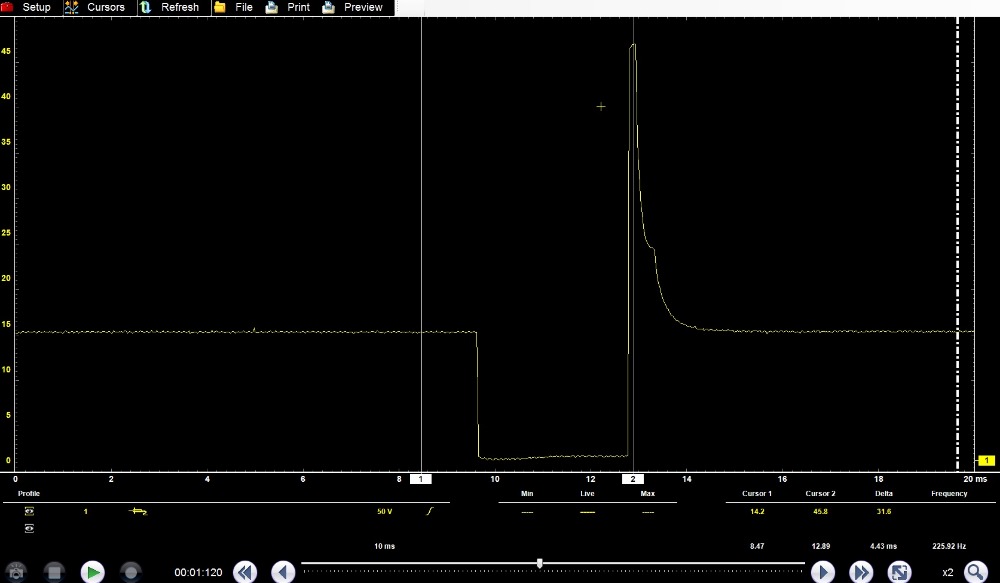

8 years 6 months ago #20085 by Tyler
Replied by Tyler on topic Re:Fuel Injector Waveform Questions
rockp2 wrote: What are your thoughts on the voltage on the control wires?
I didn't know what to think at first. :silly: So I decided to have a look at a Nissan we had at the shop, see if it's the same way. It's an '08 Altima 2.5L, so not the same year/model/engine/anything. But I figured if that 2.9V is a common Nissan thing, this one might use it, too?
Grabbed an injector waveform for reference:
With the injector disconnected, I got 12V on the feed wire, and 2.9V on the control wire. :blink:
This Altima has no engine performance issues that I know of, so I think you're definitely looking at a bias voltage on the injector control wire. :cheer:
It's interesting that Nissan O2 sensors also use a 2.9V bias on their O2 sensor signal circuits. Maybe it all comes from the same place?
