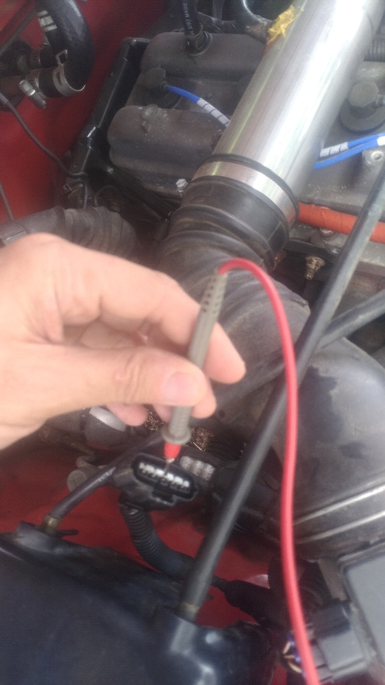

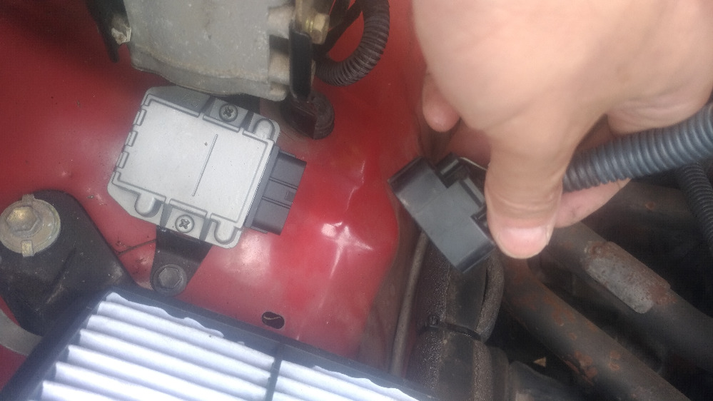

7 years 6 months ago #28578 by guafa
Please post a pic of ignitor and point where you are getting 11.8v
  • brianzero
  • brianzero's Avatar Topic Author
7 years 6 months ago #28579 by brianzero
I have a voltage drop from 11.8v to 10v while cranking. This value was taken from the IG+ ignitor coil plug.
Is this value significant?
And yes, i tested the spark test method with a spark plug touching the valve cover. No spark seen while cranking.
7 years 6 months ago #28580 by guafa
I'm afraid that voltage drop, is due to starter current demand.
  • brianzero
7 years 6 months ago #28581 by brianzero
Check this out, photo where im getting the 11.8v from:
  • brianzero
7 years 6 months ago #28582 by brianzero
Heres the ignitor:
  • brianzero
7 years 6 months ago #28583 by brianzero
That makes sense.

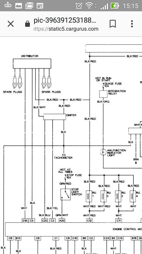

7 years 6 months ago #28584 by guafa
I think you are gonna need ignition wiring diagram. Make sure that match with your car.
This is what i've found in a quick search
