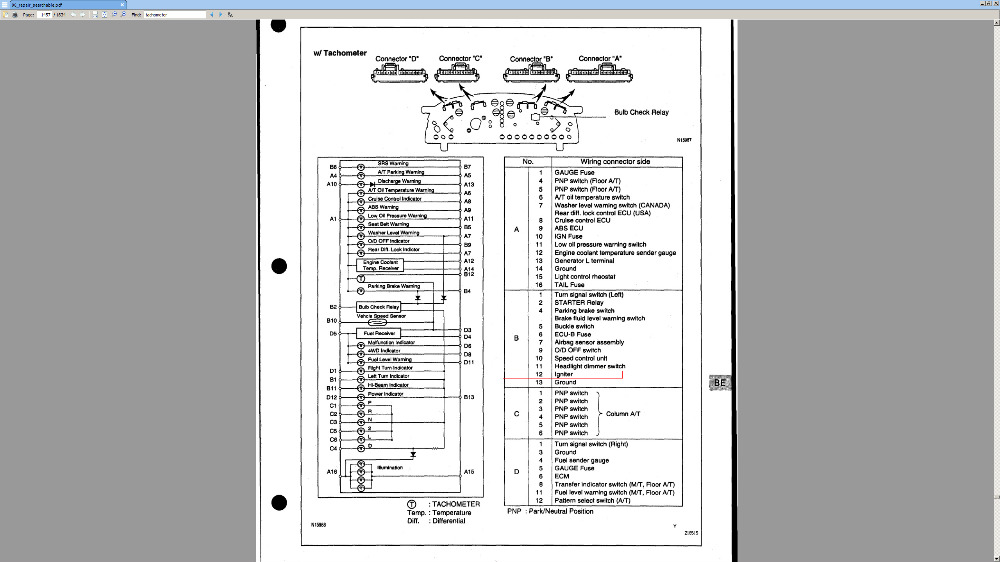

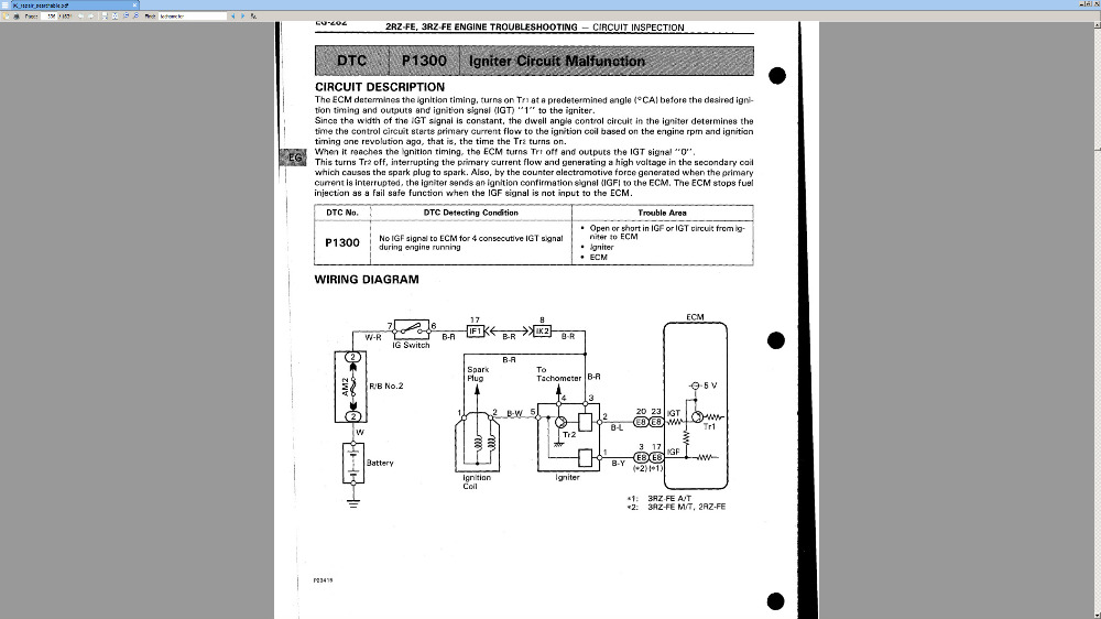

I cant get the coil to spark using the t pin and test light method. So, what do you mean by eliminate the black wire from the coil? Do you mean the wire from the tach to the coil? Is there a ohms range to test on that wire?
Is that the B-R wire according to the wiring diagram attached? Its a little confusing, because on the diagram is just an arrow pointing to 'tachometer' with no wire color.

I disconnected the black wire to the ignitor (tachometer to ignitor) and no change. That black wire has 12v at the tachometer (ignition in the ON position) and is communicating with the ignitor.
Now, whats interesting is that I connected my multimeter to B12 at the tachometer wiring connector (see diagram) and ground. I have OHMs resistance when doing this test. Does that mean that black tachometer wire is grounded somewhere? Maybe at the ignitor?
