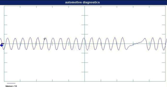

7 years 6 months ago - 7 years 6 months ago #28666 by juergen.scholl
You should be able to see an AC-voltage with your multimeter..... If you don't see nothing check for a signal directly at the sensor. If you have a signal there then check the wire for continuity/integrety to the pcm.
With a sound battery you should get at least 500mV from the ckp while cranking, I'll attach a screen shot from a good sensor, same year, same engine. Engine is running, so the voltage is higher.
DO YOU HAVE THE CORRECT WIRING DIAGRAM?
Last edit: 7 years 6 months ago by juergen.scholl.
