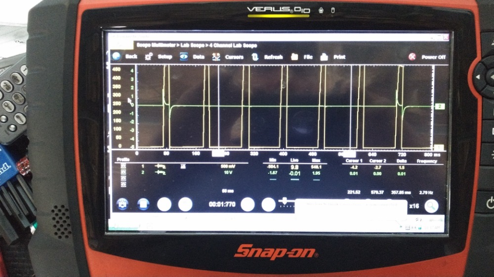

could you help me with the best setting for low amp clamp?
7 years 3 months ago #31535 by jreardon
Replied by jreardon on topic 2001 ACURA CL 3.2 CRANKS/ NO START
What settings was it at? I'm going to guess you had it at 100mV / 1 amp mode
so the 500mV in the graph means it was hitting around 5 amps.
The following user(s) said Thank You: tim.smith1
7 years 3 months ago - 7 years 3 months ago #31536 by jreardon
The peaks of those current ramp were getting cut off by the icm so i think the amperage is sufficient for the icm. Whether or not there's spark occurring inside the cylinder I don't know. We can assume some things from the current ramp like I doubt all 6 coils are shorted, and you changed the plugs so the gaps should be fine (no tail at the end of the ramps).

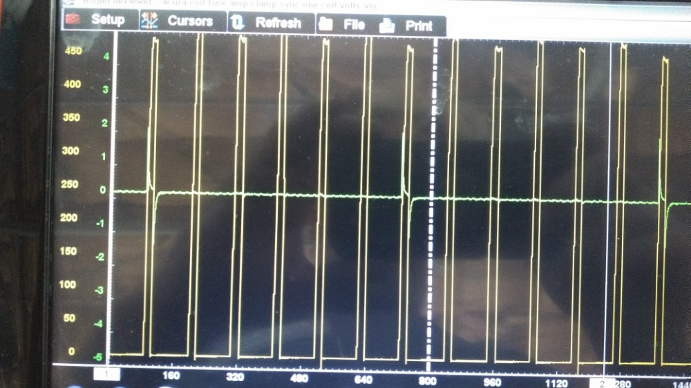

7 years 3 months ago - 7 years 3 months ago #31538 by jreardon
IGT is the low voltage control signal to ICM in each COP. I highlighted them in yellow. No need for attenuator. Pick any and backprobe one for sync and retake primary current please

7 years 3 months ago #31540 by tim.smith1
Replied by tim.smith1 on topic 2001 ACURA CL 3.2 CRANKS/ NO START

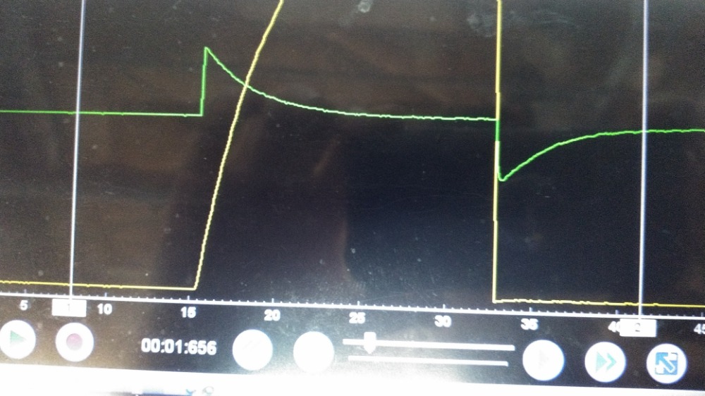

So scope is loosing internet took picks with phone amp clamp on 1mv/10ma should see green trace on scope for settings
The following user(s) said Thank You: Matts Auto
7 years 3 months ago #31542 by jreardon
Okay, first, no turn on oscillations, not sure if that's significant. Is that because not all coils have that, or because the secondary is shorted because the spark current is finding a path through the soaking wet plug, to ground? Second, what the heck is that green channel on? Where is that second channel hooked up to?

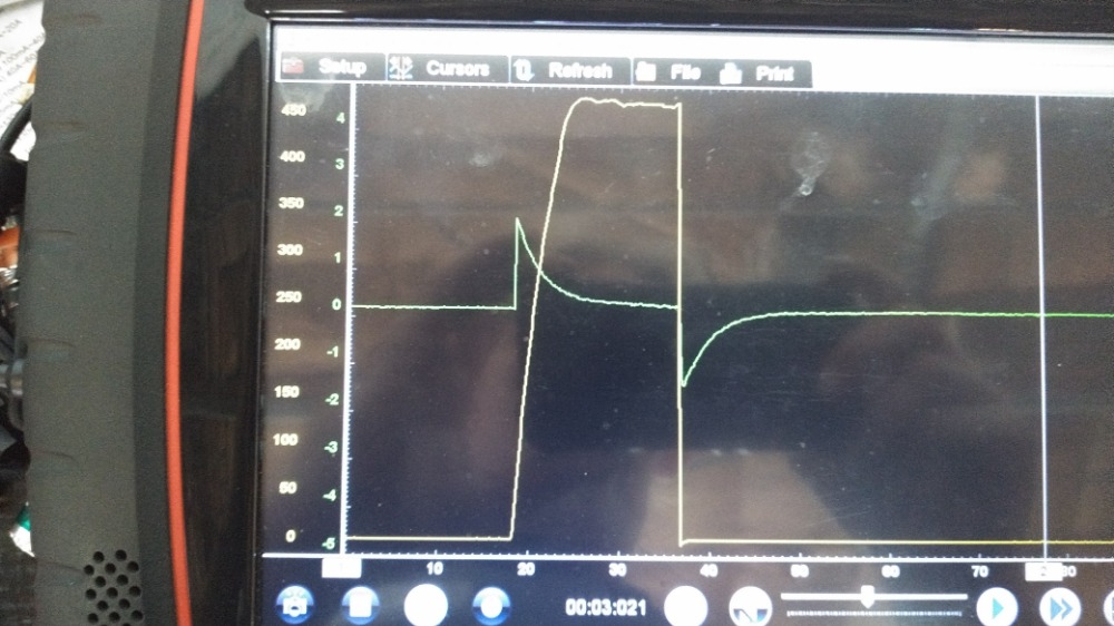

  • tim.smith1
  • tim.smith1's Avatar Topic Author

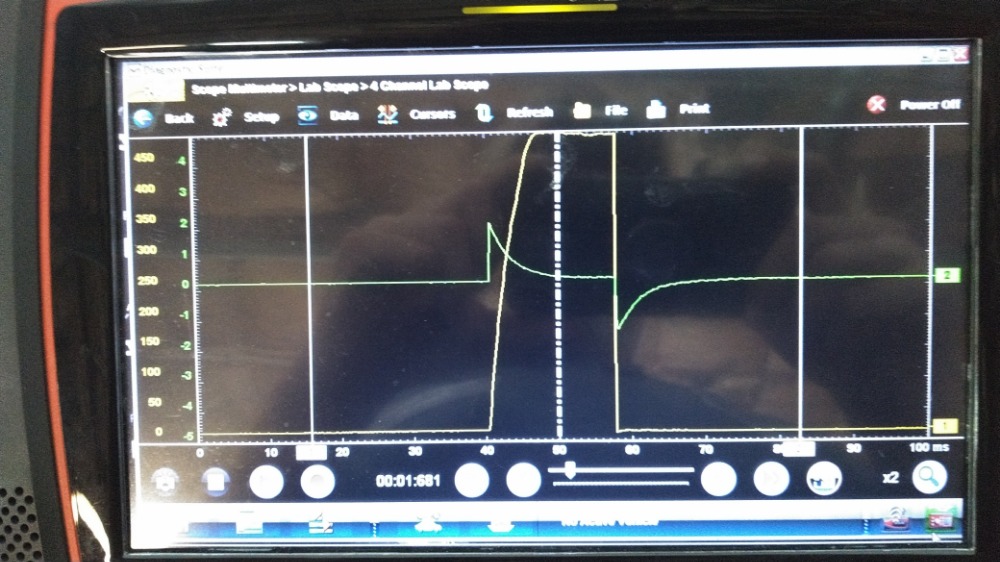

7 years 3 months ago #31543 by tim.smith1
2nd channel is on number 4 coil Control wire Brown in color. Most likely the plugs are wet. When I check fire on coils they are firing bright blue.

@jreardon this should be what you are looking for I will take them again at different zooms
7 years 3 months ago #31545 by jreardon
tim.smith1 wrote: 2nd channel is on number 4 coil Control wire Brown in color. Most likely the plugs are wet. When I check fire on coils they are firing bright blue.
Hold a plug up, with an air gap to ground, and take a current ramp on just that one coil. I want to know if the turn on oscillations are supposed to be present on these coils. I'm genuinely curious now.

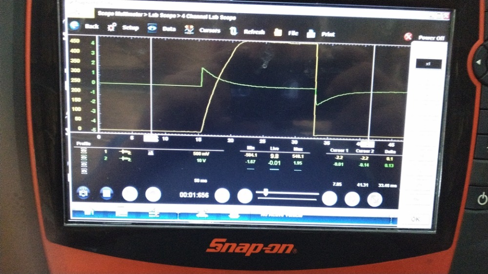

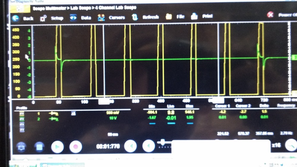

7 years 3 months ago - 7 years 3 months ago #31551 by jreardon
tim.smith1 wrote: So scope is loosing internet took picks with phone amp clamp on 1mv/10ma should see green trace on scope for settings
Did you type that correctly? 1mv /10ma ?
Can you test that brown wire again, plugged in and unplugged? That signal did not look right, although it did trigger the coil.

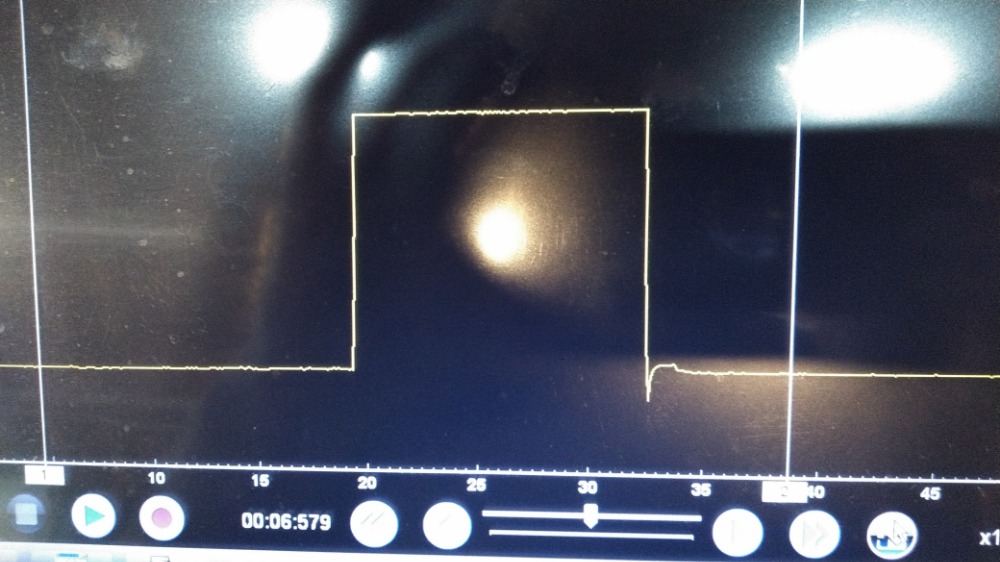

  • tim.smith1

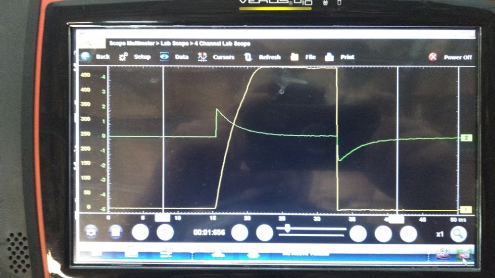

7 years 3 months ago #31553 by tim.smith1
This pick is a volt plug off of brown control wire off of coil not using amp clamp here just back probing the wire

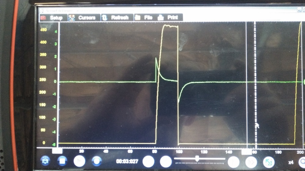

7 years 3 months ago #31554 by tim.smith1
This is checking a three wire coil that has the icm built into the coil I don't think we will see what you guys are looking for right?

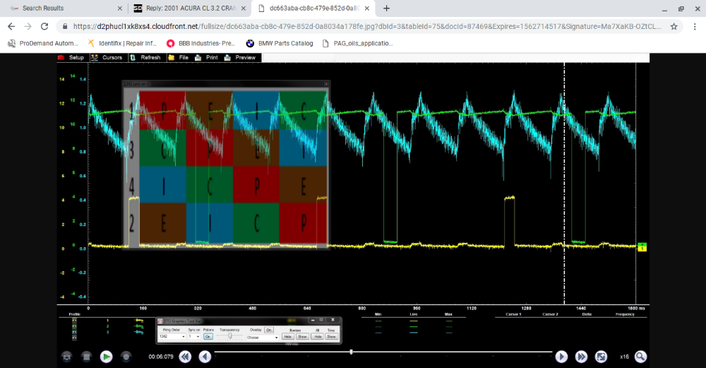

7 years 3 months ago #31556 by jreardon

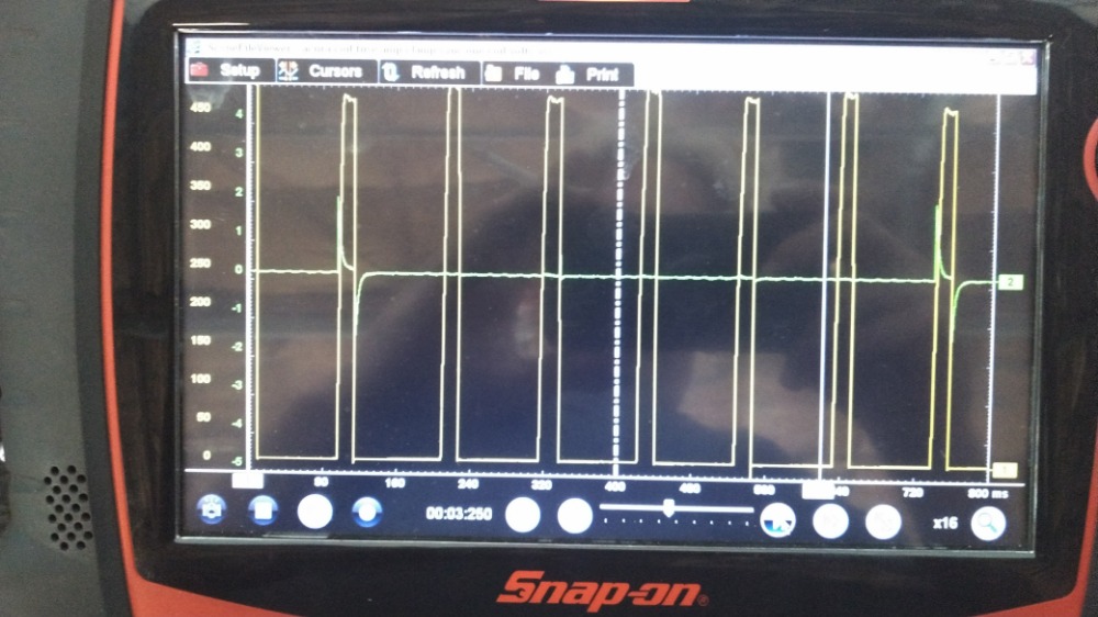

tim.smith1 wrote: this is a amp off battery and injector an coil off number 3 cylinder i hope it shows up. if i can improve image somehow please let me know
Someone please correct me if I'm wrong but shouldn't injection be taking place during intake stroke? Why is injection taking place within spark dwell time, which would be around compression stroke?

7 years 3 months ago #31557 by tim.smith1
Pretty sure injection and coils fire around compression stroke I do think that an injector will fire milliseconds before the coil but not enough to truly see don't think I am wrong but if I am then explain it better.,...........where is scanner danner when you need him lol

7 years 3 months ago #31559 by jreardon
When you took that picture, it was coil and injector on the same cylinder?
