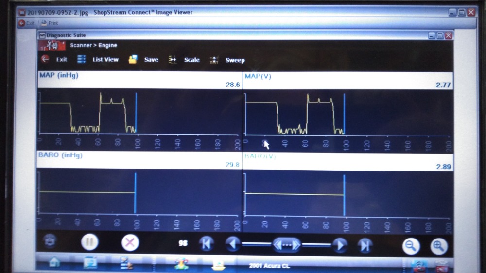

7 years 3 months ago - 7 years 3 months ago #31590 by tim.smith1
Replied by tim.smith1 on topic 2001 ACURA CL 3.2 CRANKS/ NO START
This is data stream graphing map and baro while not cracking then cracking then not then cracking again

7 years 3 months ago #31638 by guafa
Replied by guafa on topic 2001 ACURA CL 3.2 CRANKS/ NO START
Today I unplugged the ECT just sis everyone knows it dropped to -40 on data stream then I found some resistors and managed to get temp to read 192 on the data stream took the plugs out dried them off and reinstalled them tried to start it and no luck.
It makes sense the engine did not start. The point here is after you tried to start engine, were the plugs wet again? i mean, wet like with no resistors?
did you noticed different injector pulse width with and without resistors?
A few things I thought of today is as soon as I unplugged the ECT a code for it came up the one thing I have never seen is a code for the coils and I don't think I have seen for injectors I know I have had the key on with the coils unplugged and also I think with injectors unplugged I also don't recall seeing any codes for the map or the tps and I have cranked the engine over with those unplugged. Is this car that slow on codes with a sensor or component unplugged or should that bother me and lean me more towards ecm?
We don“t know yet if pcm is bad. I think at least is sending injection and ignition pulse, which should start the engine.
The fact that you have spark, air (confirmed by MAP drop), compression (180 psi) and fuel makes me think you have a fuel control issue. Again, were the plugs wet again?

7 years 3 months ago #31640 by guafa
What if spark plugs are wet?
my next move would be get a potenciometer and precissely change ECT voltage. I know is not the root cause of what you are facing, but this drives me to a fuel control (pcm sensor) issue.
In fact, you mentioned you started this engine with brake cleaner, which makes me think there is not a mechanical issue.
