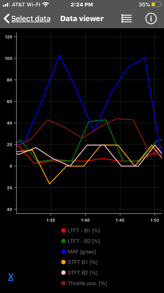

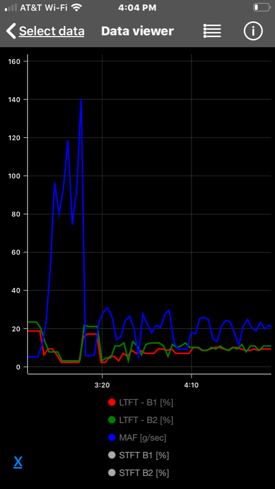

This 2003 Toyota Sienna runs a few days then Cel code P0171 and p0174 Running lean banks 1and 2. Cleaned Pcv, new maf, new o2s, can’t find a vacuum leak. Cleaned throttle an IAC. Starts and idles well. Slight hesitation on acceleration. Does this fuel trim chart look normal? Any thoughts?

FT at Idle STFT1 = +5, STFT2= -8 , LTFT1 +20, LTFT2 +19
LT Fuel trims do get better when I Increase RPM.
AT 1200 RPM Long Term is 22
AT 2000 RPM Long Term is 10
Short term jumped around a lot , I did not see a noticeable change.
Oddly the start up Idle was at 2000, unusually high today.
Cold Idle @1200 RPM Maf was 5.7
After a few minutes @ 800 RPM MAF was 2.65. Engine is a 3.0L
I'm not sure what PID values are. Is that the voltages, or just the numbers reported? My OBD2 is WIFI read by my phone.

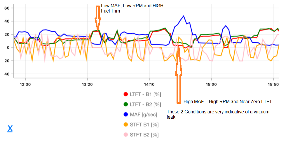

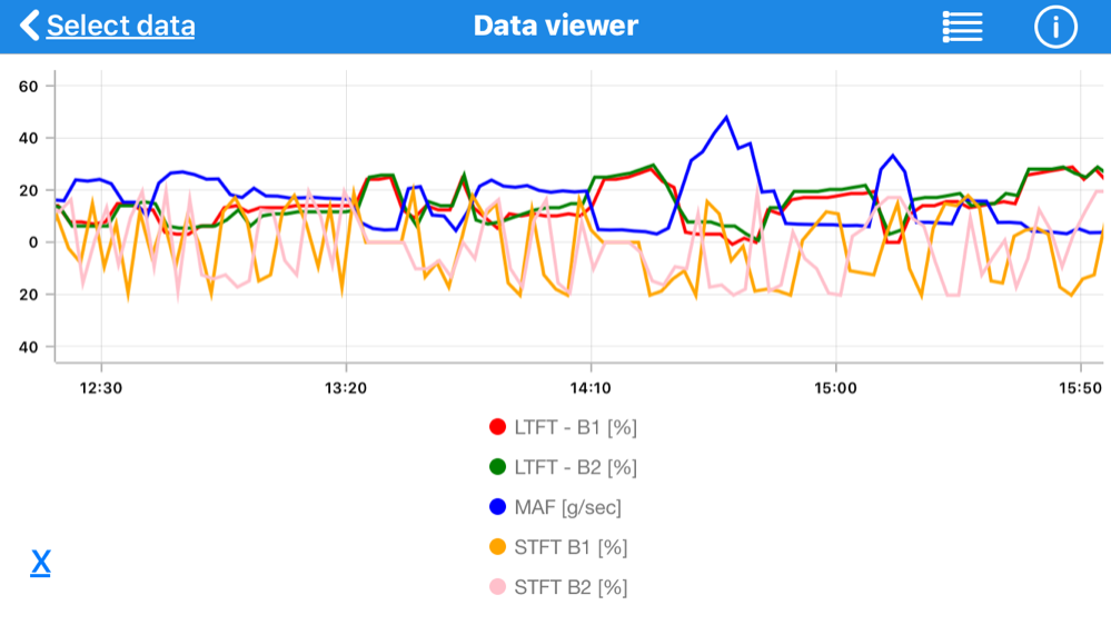

Very cool. Your edit comments to graph. I’m just stumped. On were the leak is

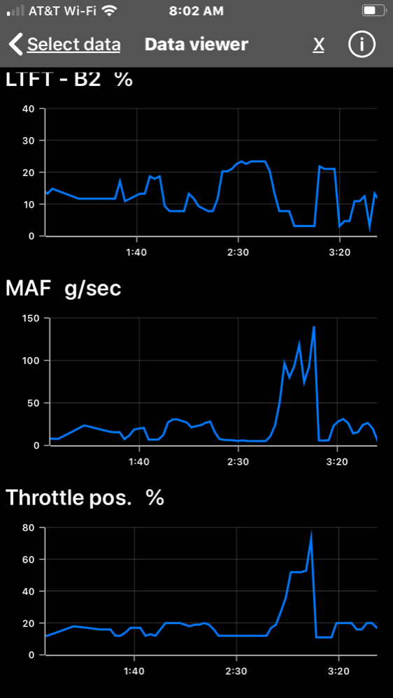

Just went booking to the store. The first maf peak is me hammering the pedal. To 6000 rpm. Then 8 mile drive to store going easy.

For checking fuel delivery I find it helpful to graph the TPS and both upstream O2's at the same time. Then you can correlate your wide open throttle event with the O2 sensor data. On Toyota you need to be careful, though, as many use air/fuel ratio sensors which work different than a traditional narrow band O2 sensor. When you mash the accelerator, your O2 sensors should go full rich, or around 800mV and stay there the duration of the wide open throttle. If the drop lean then you could have a MAF or fuel deliver issue. You don't need to overrev the engine but just give it 3-5 seconds of wide open throttle.

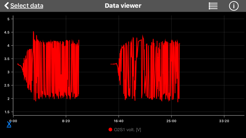

Alright! I have propane torch someplace and will give it go on hoses and things

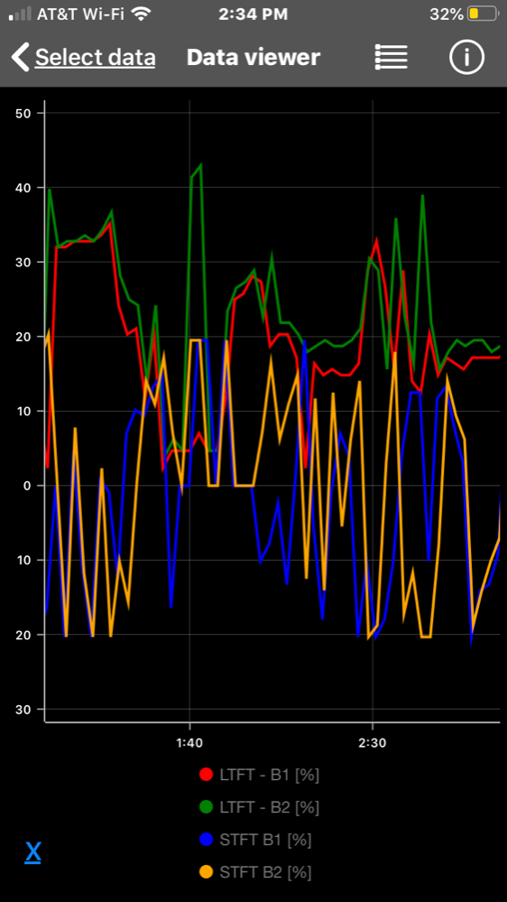

I found a way to post o2 volts and will do that today
Below is a throttle position and o2 chart
6 years 5 months ago #40180 by John Clark
Replied by John Clark on topic Lean codes bank 1 and 2. 2003 Sienna
The idea is to have the TPS and O2 sensor graphs running as the same time so you can see your WOT run and your sensor voltage. I see a short duration of full rich in your O2 graph but no way to compare it with the TPS at the same time. The O2 should stay rich the whole time the TPS is maxed out.

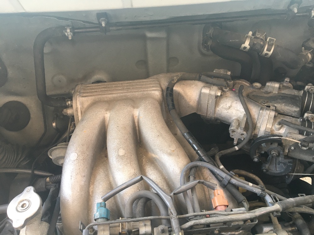

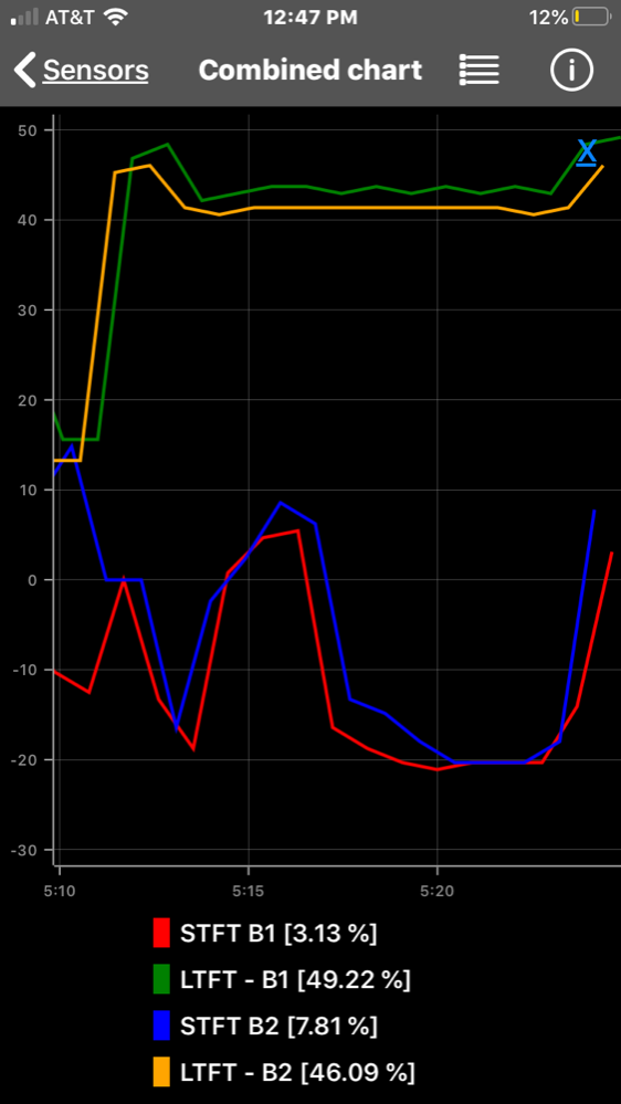

I bought a propane tank and poked around all the fittings etc. no change. I start wiggling the brake booster lines and now LTFT. Is at 40%. I unplug the vac line to the intake manifold. Plug hole with my finger, It stays at 40%. Had to remove wiper cowling to get to that part of engine. I don’t have a manifold pressure reader at this moment
6 years 5 months ago #40187 by Cheryl
Replied by Cheryl on topic Lean codes bank 1 and 2. 2003 Sienna
What’s the oxygen and air fuel fuel ratio sensors reading when the fuel trims are that bad??? Can you post fuel trims in one pic. And oxygen sensors in the other with rpm

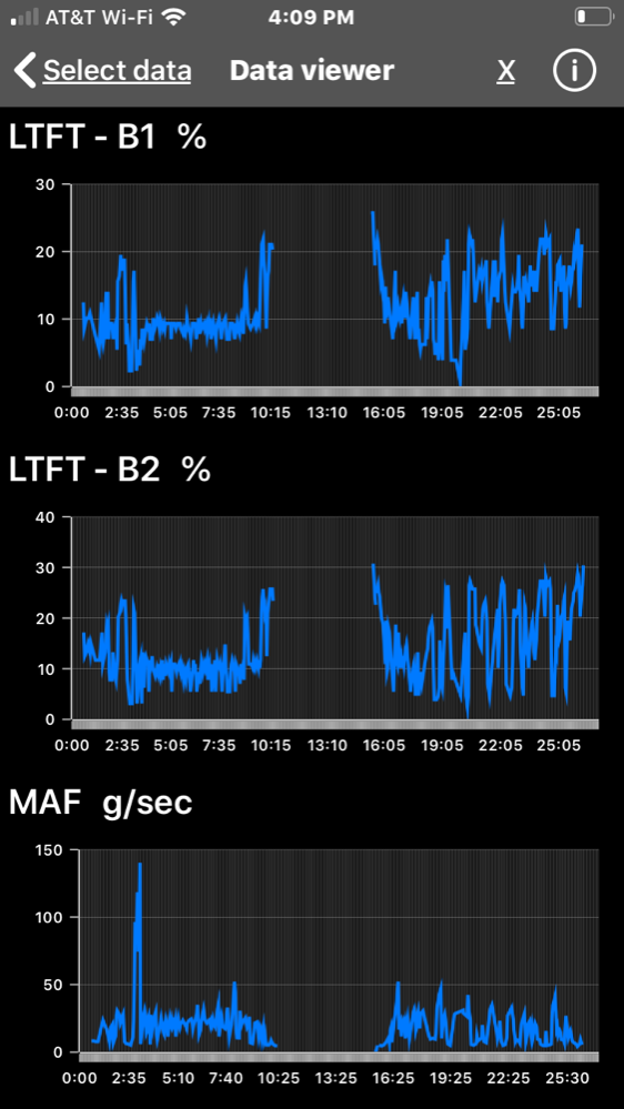

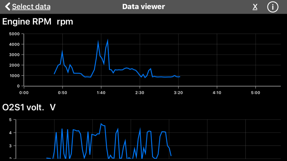

6 years 5 months ago - 6 years 5 months ago #40188 by Flykol6
Replied by Flykol6 on topic Lean codes bank 1 and 2. 2003 Sienna
Here is pic with me running the wot. Just 5 minutes ago. I’m tromping on the gas pedal .
From the looks of things I should have bullet holes in the intake.

Cheryl, I don’t have many o2 volts to show. Here are trims. And rpm and some o2 volts

One find from the brake booster line check was that the vacuum lines are stiff and not flexible, I can move them with the clamps on. They may leak a little but the propane and other spray tests did not indicate any audible or graph stumble.
6 years 5 months ago #40208 by Cheryl
If your worried about the brake booster and hose. Just unhook it’s from the intake and plug the port off.
