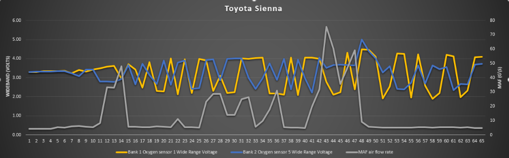

Waycraze. The propane was entered between the maf and the throttle body. For some reason Stft are positive today. When the propane. Finally hit the o2. The stft went down. The graph looks funny. To me.
I think I posted something from yesturday. if you wonder were that previous post is from. I have not mastered this web forem yet
6 years 5 months ago - 6 years 5 months ago #40305 by Paul P.
Replied by Paul P. on topic Lean codes bank 1 and 2. 2003 Sienna
Your LTFT are high at idle, Correct?
With the introduction of excess fuel source, the propane, the immediate response of the STFT would be to go NEG if the O2's are telling the truth. As time passes the LTFT should slowly start trending NEG back to zero.
So if your STFT did indeed start to go neg, That tells me the Wideband is responding to AIR FUEL MIXTURE (AFR) changes. SO, when you are at idle and you need to add excess fuel to correct a fuel trim, there is unmetered air entering the system, ie vacuum leak.

I sent a message to the scanner app developer. He said sensor 1 and 5 are the O2.

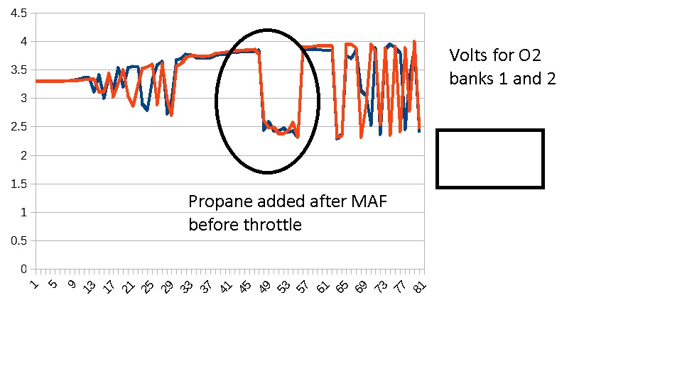

I figured out how to order the data. this chart is the O2 volts Banks 1 and 2 with the Propane added.
I got fancy in MS paint and added comments
Is it Odd the voltage variation high low swings was higher after the propane was added?
Oxygen sensor 1 Wide Range Voltage
Oxygen sensor 5 Wide Range Voltage

6 years 5 months ago #40309 by Paul P.
The chart you just posted is exactly what John wanted to see, both wideband went RICH will propane enrichment. This solidifies that unmetered air is entering the system.
As far as the oddity, I wouldn't make a conclusive statement from that amount of data.
Please check the air tract after the MAF very, very carefully especially for cracking, brittleness.

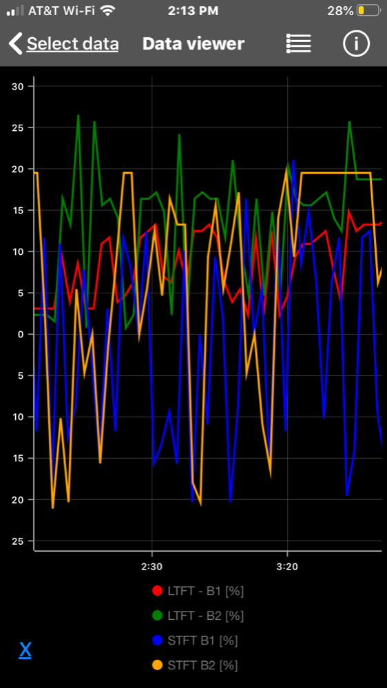

Here is a the scanner latest file! Mike
6 years 5 months ago - 6 years 5 months ago #40314 by Paul P.
Your getting there, add the STFT's and the LTFT, and MAP and BARO.
At a quick glance, this data set is not indicative of a vacuum leak, but MAF readings seem on the low side actually.
According to this Bank 1 is dropping out when it should be going RICH like Bank 2. This would suggest a bank-specific fueling issue.
If possible try and be consistent in collecting data, eg if it's just FT's required at idle then up to high rpm, a simple brake torque will do. When you want to check a fuel pump delivery on a WOT run, low gear, in a safe area, full throttle.

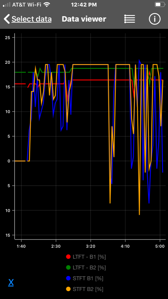

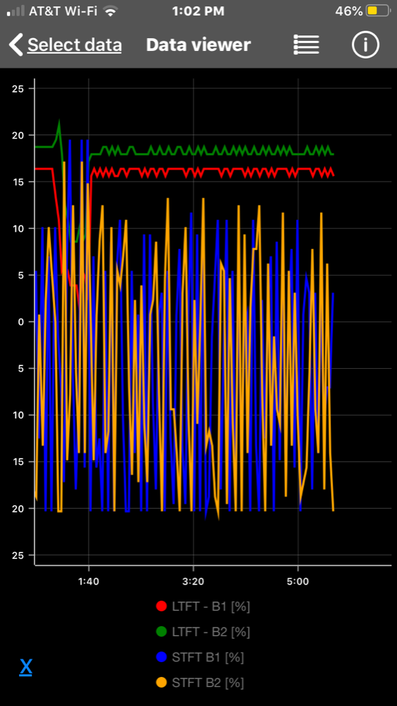

Update: Read about using soapy water in a spray bottle. Found a leak. Can you believe it ? It’s a vacuum actuator under the throttle cable cam. Not sure what it does. Increase idle or something. Stuck a stick in the hose to plug it off. The long term trim chart changed Alot. Now it Is saw tooth looking
6 years 5 months ago #40322 by John Clark
Replied by John Clark on topic Lean codes bank 1 and 2. 2003 Sienna
It's so difficult to make heads or tails of all these graphs. What's the engine doing during this time? Idle? Driving? It does look improved, though, as I'm not seeing any +50% on the fuel trims.

Seal up that leak with something better than a stick. Then, plug in your scan tool, with the engine running at idle. What are the long term and short term fuel trim numbers for each bank sitting at... on average...No graphs or big charts full of numbers. Short term numbers will fluctuate more rapidly than long term, that's normal. Just post where they are sitting most of the time. (i.e. idle B1: LT +20 and ST -3.) Post numbers for idle and then the same thing for 3000 rpm.
Normal is generally less than 10% plus or minus. Usually it takes 20% or so on the long term, either plus or minus, to set a code.

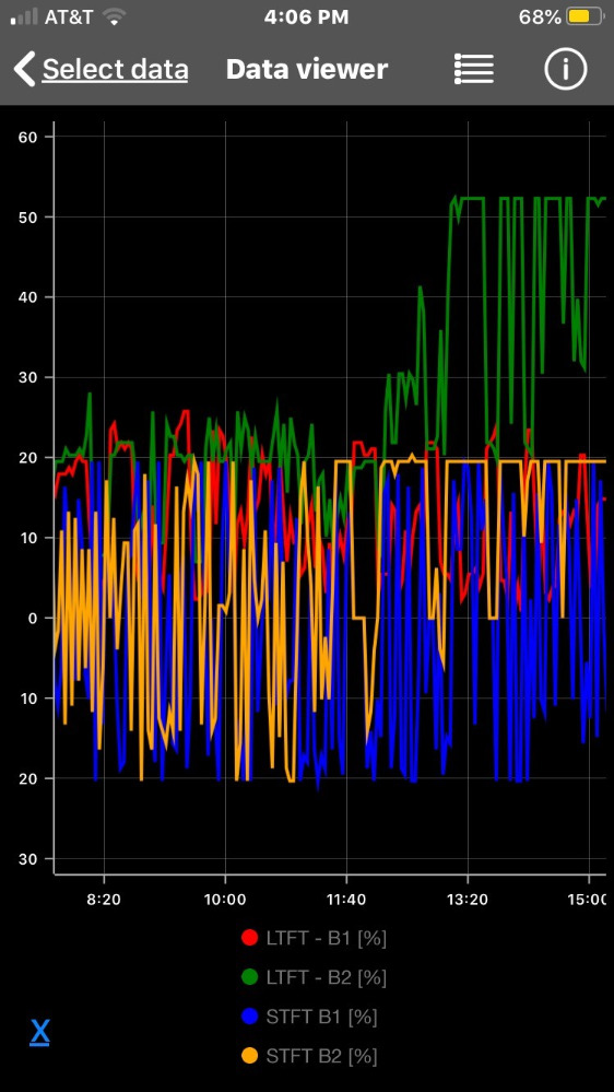

With Leak sealed up. We went to store. 9 miles going 50 mph.
Today everything was going good. Then 5 minutes in the drive. CEl for P0174. The LTFt bank 2 went to 50%. Crazy
the data available is based on what I list in the dashboard screen I create.
I shows PIDs for what I choose in dashboard. There may be Pid's I may be able capture more PIDs by adding items to the dashboard.
Bara and some of the things you ask to see are not in this data file
I have the O2 Volts . LT ST RPM MAP throttle pos
John, I will run the data at Idle and at 3000 after I post this .
