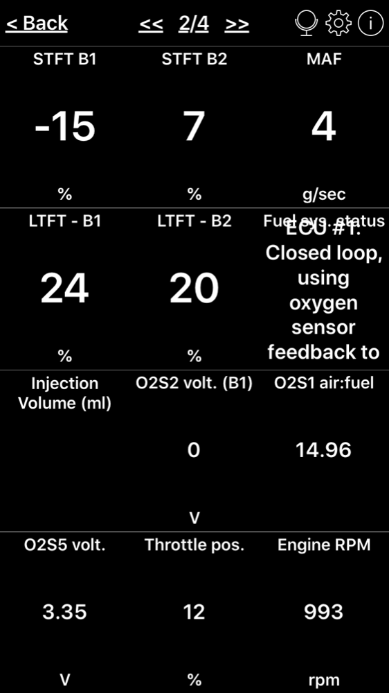

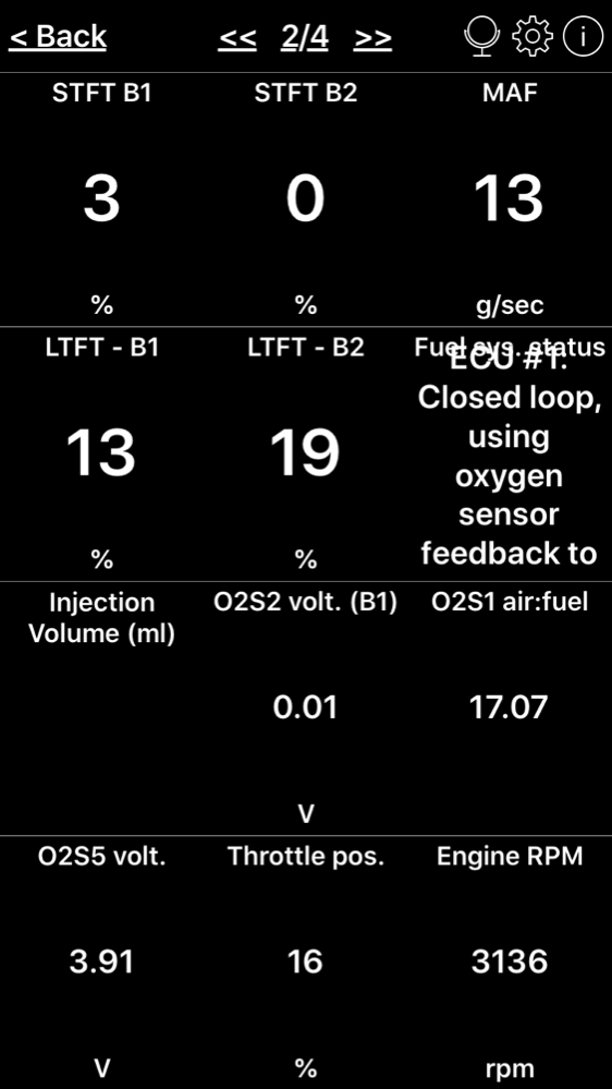

Matt, looks like my idle increase. To 900 with the throttle vac disconnected

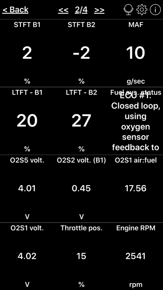

John first pic is at idle. Second at 3000. Bank 2 is no behaving like 1

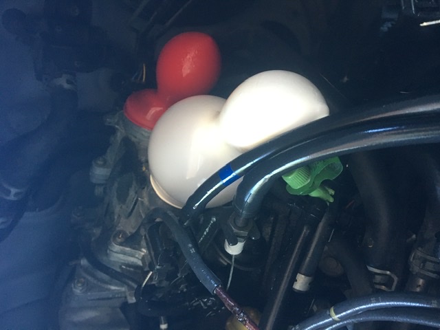

Check my high tech vacuum leak check. Two balloons over intake. Pressurize with bike pump. If I can inflate balloons, seems like I’ve plugged the leaks

The last 2 pics you posted with idle the air fuel ratio is 14.96:1 then at 3136 rpm you go to 17.07:1 so I’m kinda leaning away from vacuum leaks. Have you checked fuel quality?? Also can you give us a volumetric efficiency test?? We need engine rpm maf g/s intake air temp along with baro reading. Do a wide open throttle through first gear and give us those numbers. We want 80% or more. We need peak maf and rpm if your scanner records that

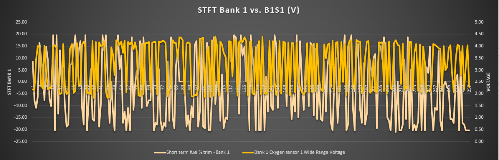

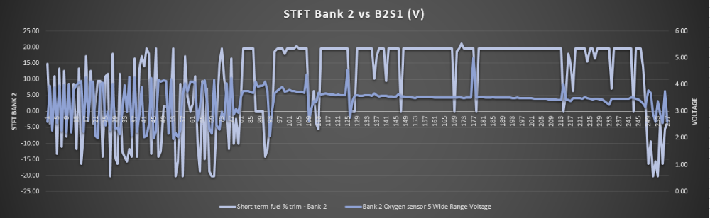

There may be multiple issues here, underreporting MAF combined with a problem with B2S1 wideband. I only made 2 charts of the STFT vs Respective Wideband. Overall per RPM range, the MAF number seems very low.
I haven't seen what is displayed on Bank 2 when a Wideband goes to bias 3.3 Volts, but the PCM puts the STFT through the roof! What a fueling strategy Toyota!!! But Clearly the PCM isn't seeing any activity from the O2 at this point.
You would think there would be sensor signal codes being set. Thanks to all who are helping out!

Yeah, that's what I kind of noticed, too. The bank 2 sensor seemed to sit at just slightly lean and then the fuel trims would skyrocket. I think it has to do with the amount of time it's sitting there. A/F ratio sensors can be tricky to diagnose, at least in my experience.
I really think these off brand replacement sensors, $35 vs $115 for a Denso which is actually the cheapest brand RockAuto even sells, is likely the cause of all of this. I kind of resigned myself from this thread when learning that's what was in this but it's an interesting case study, nonetheless, so I found it hard to not keep checking back.
Get rid of these chinese A/F ratio sensors, replace with Denso, and I'm betting the issues go away. There may still be an issue with the MAF but would be much easier to diagnose, knowing the right sensors are in the car to begin with.

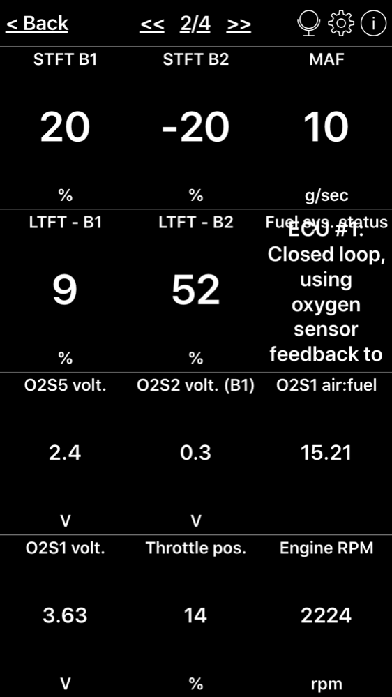

I went to the pull apart. Got o2 sensors From 3.0 v6. Spliced it in and ST did not register but Lt was high like usual. Replaced some vac lines that seemed dried out.
The latest oddity is that bank two. LTFT. Increases with acceleration it goes to 50. Some times.

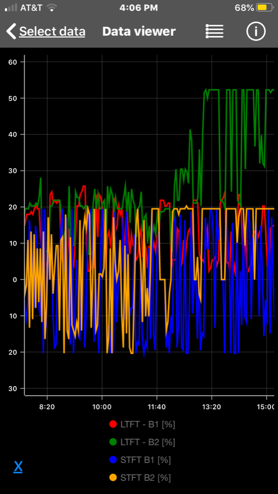

Yes. Time to switch o2 bank 1 with bank 2. Only way to settle if the O2 sensor is funky . I’m trying go on vacation Tuesday and wanted to take the van. I have one more day to fix it. Not sure I posted this latest chart. This shows everything kind of ok for 10 minutes , Then bank 2 goes to hades. Bank 2 o2 is filthy black

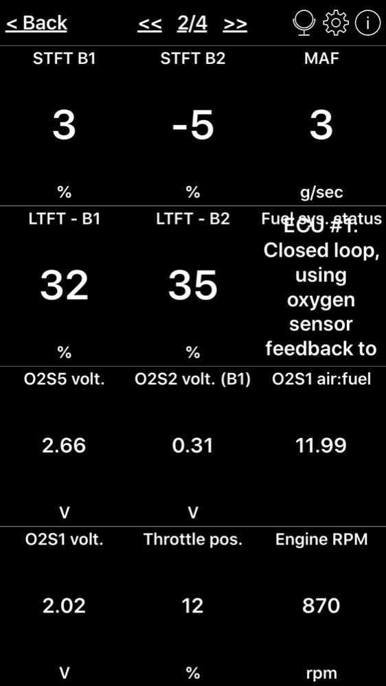

Swapped o2 sensors out. I was hoping to see someThing new. No change. Bank 2 LT is at 30 at idle and 52 at 2000rpm. Cel code P0174. Sigh....

Random stuff. I read to reset Ecu . Unplugged battery for an hour. Restarted no long term fuel trims for 5 minutes. Then driving around. I get 50 ltft bank one. So the switch moved the high LTFT to bank one Drove some more and the trims became balanced. 33 at 2500. 25 at 900
