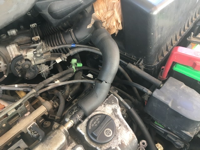

6 years 5 months ago #40228 by Flykol6
Replied by Flykol6 on topic Lean codes bank 1 and 2. 2003 Sienna
Updated, Checked every vacuum hose. Tried propane tank again. I finally read about smoke machine. I used to have a Party fog machine. That I think would have worked. I spent some time in Toyotanation readinG. Some ideas. ECU, My after market AF O2s, One guy wrapped plastic shopping bags around his big air cleaner clamp fittings an found leaks in plastic airbox . Check grounds. Something about coolant temp fauge

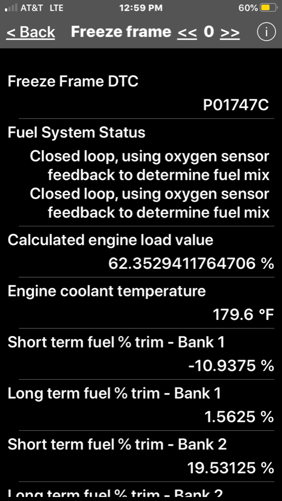

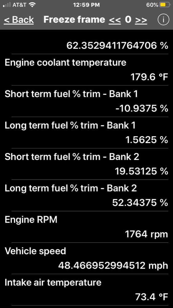

6 years 5 months ago #40252 by Flykol6
Here is today’s cel. Freeze frame. Mike
6 years 5 months ago #40253 by Paul P.
Replied by Paul P. on topic Lean codes bank 1 and 2. 2003 Sienna
This freeze frame data is for the P0174, the P0171 did not return?
This freeze frame data is going to change your diagnostic approach because it is now a bank-specific problem. So MAF, MAP, Fuel PUMP & Pressure can be eliminated as a suspect.
What can be suspect is B2S1 O2 is 'lying', reporting a lean condition when there isn't one.
Air entering the exhaust system ahead of B2S1 02
Internal Vacuum leak on Bank 2 ( there should be no vacuum present in the crankcase when it is isolated from the PCV system)
Or, all three injectors are actually lean on Bank 2.
Please post again your Fuel Trim Data at idle, and at high rpm for both banks.

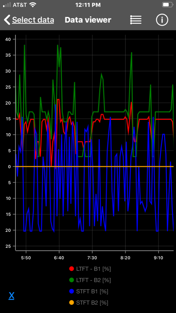

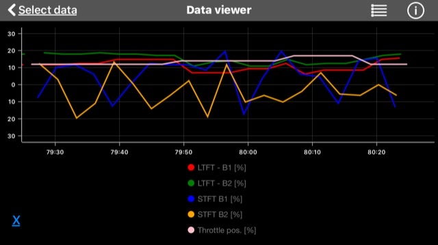

6 years 5 months ago #40258 by Flykol6
P0171 has been the code 95%. Of the time. I have got both codes when I was pulling hoses while checking around. So yes that is different to get p0174. On Pcv pressures. This engine has a 1/2 inch hose going from valve cover to intake snorkel. See picture. Note I wrapped a shopping bag to see if it would vacuum in .
The trim picture is 1000 rpm. Then 2000. Then 2900. The pink line shows the TPS %
Thanks for the new ideas.
6 years 5 months ago #40261 by John Clark
Replied by John Clark on topic Lean codes bank 1 and 2. 2003 Sienna
I'd like to see the air/fuel ratio data for bank 2 and compare it with bank 1 which is OK. The A/F ratio data is given in a voltage often called Lambda with 3.3v being stoichiometric. Anything above 3.3v is lean and anything above 3.3v is rich. Does that voltage vary when you snap the throttle? How does it compare with bank 2 voltage? There is also an equivalence ratio that should be around 1.0 with anything above being lean and anything below being rich.

6 years 5 months ago #40270 by Paul P.
You would check for vacuum in the crankcase at the oil dip tube with the PVC plugged and isolated.
Is it possible to show the data on your phone app as just numbers and no graphing?
These graphs aren't relevant to making a diagnostic decision.
Never stop Learning.

6 years 5 months ago #40299 by Paul P.
Unfortunately, I can't do anything with this data set...did you have the option to export the file as comma delimited?
I can't re-arrange the data set because the times would wrong. Also, the labelling of the Oxygen Sensors can be misleading.
The fuel trims IMPROVE at higher engine rpm both banks, still suggesting a vacuum leak.
If the Wideband O2's are telling the truth, when you add propane into the air tract at idle, the LTFT should start to Improve. IF they do, I would still be leaning towards the vacuum leak.
If the LTFT's don't improve or the wide bands don't respond to the Propane enrichment then clearly there is an 02 issue.

6 years 5 months ago #40303 by Flykol6
