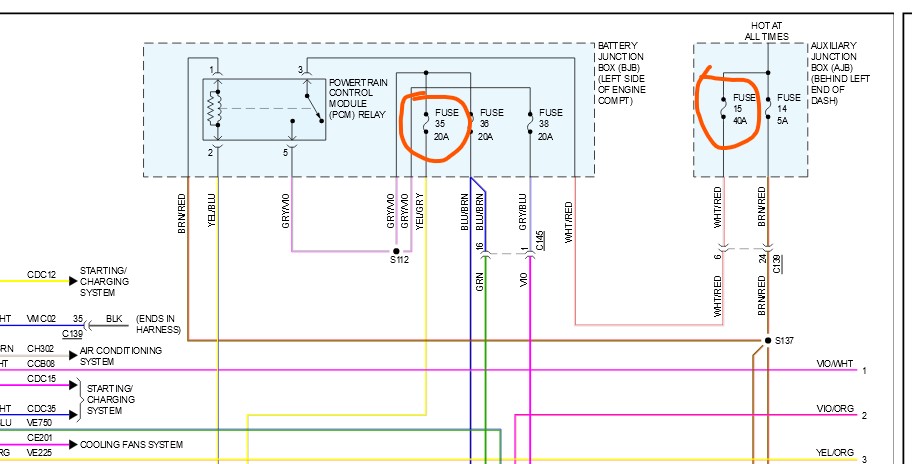

Went out again to check the fuses. I did not know what condition to check the pins in but I checked them with the connector unplugged with the key in the on position.
6 years 1 month ago #43167 by Chad
Replied by Chad on topic 2015 ford transit no crank/no start
Check with all connectors connected.
If you, still, have no power on Pins 67 & 68, then our next stop is the PCM Relay.

Fuse 35 is good and the connectors are clean, I don't have the aux battery system, will I still have the aux battery junction box? Next I will check for power at pin 5 of the PCM relay and get back to you.
Thanks
Bill
6 years 1 month ago #43182 by Chad
Do you get power on Fuse 35, with the key on?
I believe, you will.

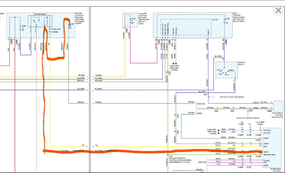

So, you have power on Pins 67, and 68. That's good. Make sure your Grounds on Pins 50, 69, and 70 are good. Do this by swithing your volt meter to milli-volts. Connect your volt meter BLACK lead to Battery (-). With the RED lead, measure the voltage on the GROUNDS at Pins 50, 69, and 70 ...WHILE THE KEY IS ON AND YOU HAVE POWER ON PINS 67 and 68. It is important that the PCM is receiving POWER when you do this. You want to see no more than 100mV, or so. The closer to zero, the better. Anything over 200mV is a concern.
If all that checks out, and you are getting POWER on Pin 16, when the Key is in the START position, but no Power comes out of the PCM on Pin 37, it's not looking good for the PCM.
Can you start the engine by turning the ignition to the RUN position and cranking the starter by applying POWER to the Gray/Orange wire on the starter Solenoid?

Bk/gn 69 mv, Bk/yel .9 mv, Power on pin 16, no power on pin 37 key in start position. Are there any controls that could be getting to us? EG neutral safety, ect.
Keep in mind that the problem started intermitently and progressed to a no start condition.
  • surplus238
  • surplus238's Avatar Topic Author
6 years 1 month ago #43200 by surplus238
Replied by surplus238 on topic 2015 ford transit no crank/no start
Back again, I have looked at the diagram and it looks to me like I am looking at it backwards, should the power be coming in to pin 3 on the PCM relay and going out to the #29 fuse? If that is the case I have no power on the relay pin 3. That would be a problem in the aux junction box?

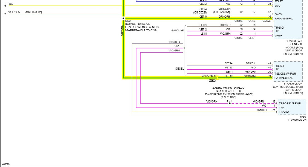

6 years 1 month ago - 6 years 1 month ago #43201 by Chad
The highlighted circuit is the Park/Neutral circuit. I'm not sure what voltage should be on this circuit. I would, simply, look for a "Change" from High to Low, or Low to High, while shifting from PRNDL Make sure the "change" is the same at all 3 point.

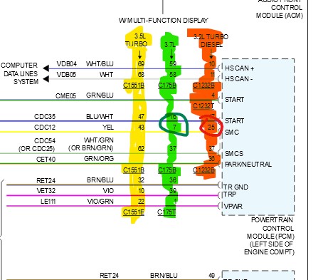

Monde wrote: My question is: shouldn't we check for power on pin 7 and ground on pin 37?
You are correct. That is what we did in the second post of this thread.
Chad wrote: Do you have power on Fuse 29 when attempting to crank? If so, the PCM is sending power to the Starter Relay. If not, do you have power at Pin 37 of the PCM? If you have power at Pin 37 and Fuse 29, then that is good. The relay is getting control POWER (barring any problems with the relay socket). The Yellow wire should receive a control GROUND from the PCM on Pin 25. If you have power on Pin 25, while cranking, then the PCM is not providing a control GROUND.
By checking for power on Fuse 29, we are checking Pin 37, as Fuse 29 is powered by Pin 37.
Do to this diagram covering multiple engines, with a few differences, I mis-quoted the Yellow wire as being on Pin 25, instead of Pin 7.
Last edit: 6 years 1 month ago by Chad.
6 years 1 month ago - 6 years 1 month ago #43210 by Chad
Monde wrote: My question is: shouldn't we check for power on pin 7 and ground on pin 37? Usually, in a relay, you always have both powers at the top and grounds at the bottom.
Re-reading your question, I see that you asking if Pin 7 is POWER, and Pin 37 is GROUND. Pin 37 CANNOT be a GROUND. If Pin 37 was Grounded, Fuse 29 would blow.
I'm not saying it isn't done but, I have never seen a fuse on the ground side of a circuit.

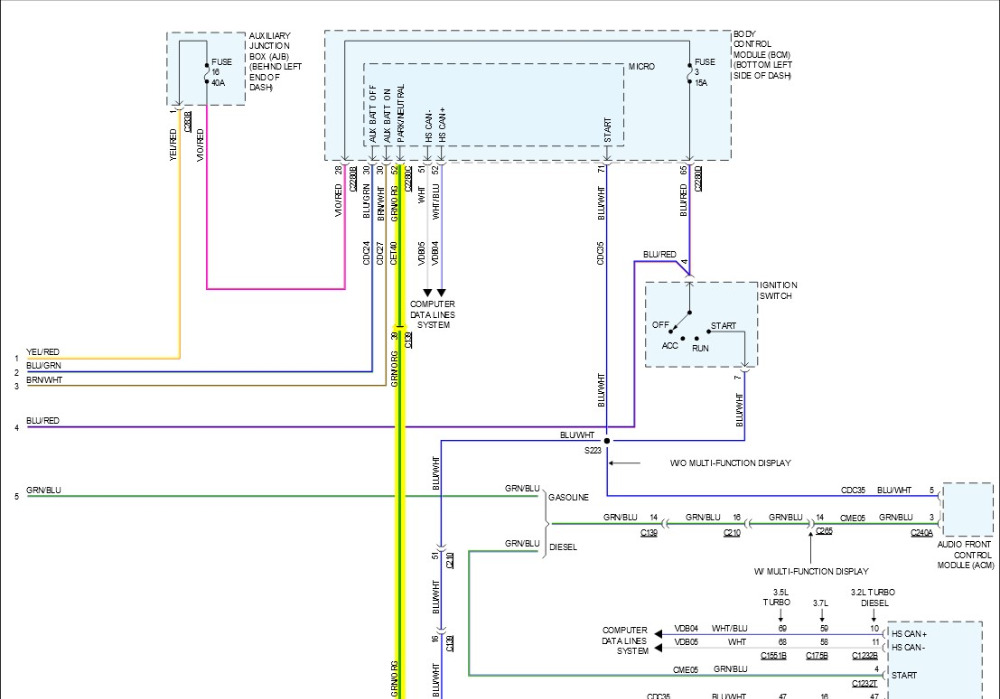

6 years 1 month ago #43212 by Matt T
Replied by Matt T on topic 2015 ford transit no crank/no start
That fuses function certainly isn't obvious. Might be there to configure the vehicle for engine and/or audio front control options rather than provide overcurrent protection??? Wouldn't be the first time an OEM used a fuse to turn something on or off....
Either way that same diagram shows start signals landing on the BCM and the audio front control module. Time to step away from the DMM and start checking PIDs IMO.
