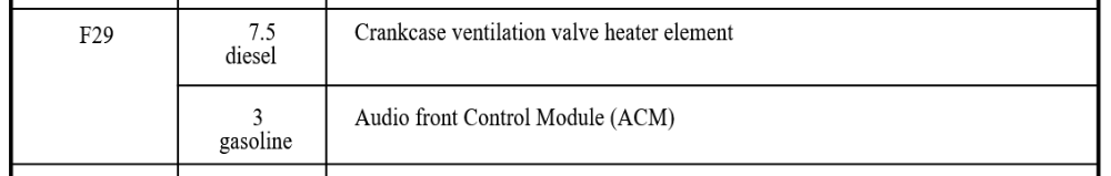

surplus238 wrote: Hi guys, I notice that the audio mod is somehow involved in the starting system, has anyone had a problem with that?
One other symptom I had not thought about. when I turn the key on the radio comes on, I turn the radio off but the next time I turn the key on the radio comes on again
I believe that the ACM receives power, from Fuse 29, (which receives its power from Pin 37), when the key is turned to the "ON" position. The way Service Information labels Fuse 29 backs this theory up.

I do not have power at fuse 29 and have not had any there through this whole thing. I would really like to know which pins on the starter relay socket should have power and when.

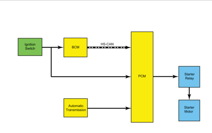

6 years 1 month ago #43230 by Chad
Replied by Chad on topic 2015 ford transit no crank/no start
surplus238 wrote: . I would really like to know which pins on the starter relay socket should have power and when.
The pin with the White/Green wire (2) gets power from Pin 37 of the PCM when the key is in the ACC or RUN position.
The pin with the Yellow wire (1) gets a Ground from Pin 7 of the PCM when the key is in the START position.
6 years 1 month ago - 6 years 1 month ago #43231 by Chad
Copy and Past:
Powertrain Control Module (PCM)
The PCM provides power and ground to the starter relay to initiate cranking of the engine.
Starting System
The starting system controls the cranking of the engine. Under normal operation, when the ignition is turned to START, the PCM receives the following inputs:
Request to crank engine message from the BCM
PATS enable message from the BCM
Correct transmission park or neutral input from the automatic transmission
When the PCM receives the correct inputs, voltage and ground is supplied to the starter relay coil. When the starter relay coil is energized, it provides voltage to the starter solenoid, allowing the starter motor to crank the engine.
The PCM disengages the starter once an engine Revolutions Per Minute (RPM) threshold is reached, a set crank time is exceeded or the ignition is turned OFF.
Passive Anti-theft System (PATS)
This vehicle may be equipped with PATS . PATS disables the engine from starting if an unprogrammed PATS key is used or an invalid PCM ID is received. The PATS is controlled by the BCM . If there is a PATS concern that disables the engine, the IPC displays a corresponding message in the message center.

Ok guys, an update, in the ford tsb's I found a tsb on the BCM, if it is replace it is possible that the new unit will not accept a flash, Ford is still working on the problem but I have bypassed the start wiring at the BCM and the van now starts and runs. The # 29 fuse only activates the ACM and is only powered when the key is in the start position, it has nothing to do with starting. I am not going to buy another BCM unless Ford finds a fix foe the problem. The van works fine this way.
