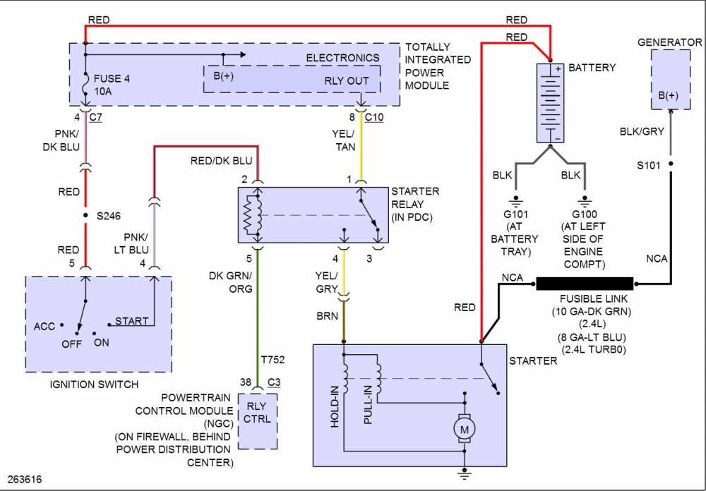

Hi,
Thanks in advance to Scanner Danner for allowing me to post my question here. I appreciate it.
I have a 2009 PT Cruiser that will not start. Only starts during bypassing of ignition system.
Well I did the same testlight diagnoses from the video, "How to troubleshoot a starting system (bad ignition switch) - Dodge Neon" on youtube for my mom's PT Cruiser and found that my test light did not light on any of the starter relay ports. Only when I cranked the engine did one port light up - which was the hot wire side. Which is strange. It should be lit all the time even with the engine off.
The ignition swtich wire going in was lit with engine off and during crank the wire going out of ignition switch was lit. So it seems ignition switch is functioning, yet the starter relay port connected to the ignition switch didn't light during crank (I think the wires in-between splice and something is messed up).
Is this a case of a bad TIPM or ground in TIPM or is it the starter relay port issue?
Feedback appreciated. Thanks.

im kinda confused? pin 2 on the relay is supposed to only be hot with the key in start position. those Chryslers are bad for the lock actuator for breaking in the column.
9 years 8 months ago #5738 by Chad
Replied by Chad on topic Bad TIPM or Starter relay port on PT 09
Hot in crank/start looks to be normal.
9 years 8 months ago #5752 by Tyler
Replied by Tyler on topic Bad TIPM or Starter relay port on PT 09
Thanks for the diagram, pole71! B)
So, just to be clear, you only have one power feed at the relay with the key in the crank position, correct? By hot wire, are you referring to the load side of the relay (pin 1), or the control side (pin 2)? Just want to be sure about what diagnostic direction to send you in!
Also, did you happen to try connecting your test light to B- and look for grounds at the relay? In the crank position, there should be two - one from the PCM for relay control, and one through the starter solenoid winding (if the winding is intact).

Yes the load side does not light with a test light (grounded) when engine is off but does light when engine is cranked. Something wrong there.
If that is the case it points back to the TIPM. Possible bad ground for TIPM?
The picture is showing a no crank position using a test light:
Tyler wrote: Also, did you happen to try connecting your test light to B- and look for grounds at the relay? In the crank position, there should be two - one from the PCM for relay control, and one through the starter solenoid winding (if the winding is intact).
The "B-" terminal as in from the starter motor? Should I be testing voltage drop from there to the relay grounds? I am going to check all grounds today.

I've checked the actuator. It is still intact inside ignition.
The starter runs.
Battery is good.
Alternator seems to be fine.
Cables are good.
All the grounds Iv'e checked are good. Still have to look at more hidden grounds though way in the back of the car.
Ignition switch seems good. Power goes in and out the wires.
Starter relay clicks and has continuity.
I can bypass ignition system by taking a screwdriver and touching B terminal and S terminal of starter while key is turned to start car -
or I can use Power Probe to power yellow/grey wire of starter relay port (in diagram I provided) with key turned to start the engine.
I think it's a bad ground with TIPM or Starter Relay port. Still gotta find all grounds.

It's strange that pin 1 of starter port is not lighting with test light with engine off. It should be always light. So the problem goes back to the TIPM. Possibly a bad ground.
Measuring voltage drop from ( - ) battery terminal to pin 1 starts with:
0.13 v no crank
12.07 v with crank.
Yet there is the TIPM and ignition switch that also share voltage with the starter relay, so how could pin 1 get almost all the voltage from the battery during crank? It should have less volts. I also got about same volts measuring from the ( - ) battery terminal to the fuse inside TIPM during crank. Since the voltage from the ( - ) battery terminal to fuse is almost equal to voltage drop from ( - ) battery terminal to starter relay, that means I got a bad ground somewhere.
And those are not fuel lines over my hands in the pic are they? I think someone just told me they are AC lines. :huh:
I am a noob.
Do you know how to get to the Instrument Panel and the Cowl Panels? Could you tell me what these things would generally be?
Thanks.

c0astl|ght wrote: Yes the load side does not light with a test light (grounded) when engine is off but does light when engine is cranked. Something wrong there.
No, that's good! That means the TIPM is supplying power to the load side of the starter relay when desired (during cranking). That B+ output is controlled by the TIPM itself, and is NOT a constant feed.
Cheryl is on the right track with the relay testing. I see you found a ground at pin 5 (from the PCM), sweet! If you also have a power on pin 2 with the key in crank, then the relay has everything it needs to work.

Tyler wrote: No, that's good! That means the TIPM is supplying power to the load side of the starter relay when desired (during cranking). That B+ output is controlled by the TIPM itself, and is NOT a constant feed.
That sounds good but I saw the video from ScannerDanner on troubleshooting the ignition system on the Dodge Neon and he mentioned that the hot wire has to light the test light at all times.
But if it's a different case for the Chrysler TIPM that would be great! I don't have to worry about a starter relay port defect.
Tyler wrote: Cheryl is on the right track with the relay testing. I see you found a ground at pin 5 (from the PCM), sweet! If you also have a power on pin 2 with the key in crank, then the relay has everything it needs to work.
The thing though is during crank I have no power going to pin 2 during crank. Yet the ignition swtich is lighting for power coming in and out of switch. So I checked the grounds for the ignition switch and it led me to G105 (the one with the corroded eyelet with the picture showing) that seems to be the problem for the start failures.

Ah yeah, I see why that's confusing! Yeah, the TIPM works differently - it's on the CAN network, and uses a high side driver for the starter relay when it gets the right message over the network.
c0ast|ght wrote: The thing though is during crank I have no power going to pin 2 during crank. Yet the ignition swtich is lighting for power coming in and out of switch. So I checked the grounds for the ignition switch and it led me to G105 (the one with the corroded eyelet with the picture showing) that seems to be the problem for the start failures.
OK, getting somewhere! :cheer: No power at pin 2, but you DO have power at pin 4, pink/light blue wire, at the ignition switch in crank? If that's true, then you're looking at an open wire between the ignition switch and the starter relay.
Any remote start, or other wiring messed with in the steering column? If not, then you're down to tracing that circuit 'till you find the open. The OE diagram shows C104 in between the ignition switch and the relay, I'll see if I can locate that tomorrow. If you could get to that connector easily, you could probe it and tell which direction to look for the wiring problem.

I only have power going to pin 1 during crank. When the engine is off all pins are not showing power.
But when I put power to pin 3/4 with the Power Probe the car starts up again. So I guess from the end-side control of starter relay to the starter motor is good. It's just the stuff before pin 3/4 to the fuse that is off at the moment. I even have weird voltage drop(during crank) between fuse and starter relay.

OK, so we need to pursue the ignition switch (or the wiring), then. There should absolutely be power at pin 2 at the starter relay during cranking, and there isn't.
Earlier you mentioned checking the ignition switch - are you positive you had power at the pink/light blue wire?
If you wanted to prove that missing power at pin 2 of the starter relay is the problem, you could plug the starter relay partially into it's socket in the TIPM and touch pin 2 with a test light connected to B+ with the key in the crank position. This will simulate the power feed from the ignition switch, and the engine should crank.

Yes. I checked that pin like 10 times. Every time the pink/blue wire lit during crank. Since no power gets to pin 2 I believe it is a wiring problem with the ignition switch as even the wires leading to ground for the ignition switch were corroded (in the picture I provided earlier. They are all blue).
Tyler wrote: If you wanted to prove that missing power at pin 2 of the starter relay is the problem, you could plug the starter relay partially into it's socket in the TIPM and touch pin 2 with a test light connected to B+ with the key in the crank position. This will simulate the power feed from the ignition switch, and the engine should crank.
Definitely I will do this wire jump as well if it doesn't start tomorrow.
I just soldered on new wires into a new eyelet:
Tomorrow I will put everything back together and see if it starts normally. The new wires are much cleaner than before. This has to work.
