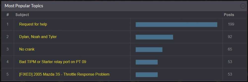

Also, I had a glance at the forum statistics just now, check it out!
I love seeing long threads like this. B)

Woah. My problem made it to #4! B)
Damn! I hope this helps lots of other people out there. It's thanks to Tyler! that's why folks! Gotta give respect where it is due.
Well. Saved alot of money for sure. $700 in parts and tools (mostly tools) and fixed something that could have been 1 grand plus easy; and no tools left over to use again. It was a good investment.
Distanced myself from the dealer for another 2 years plus. B)
