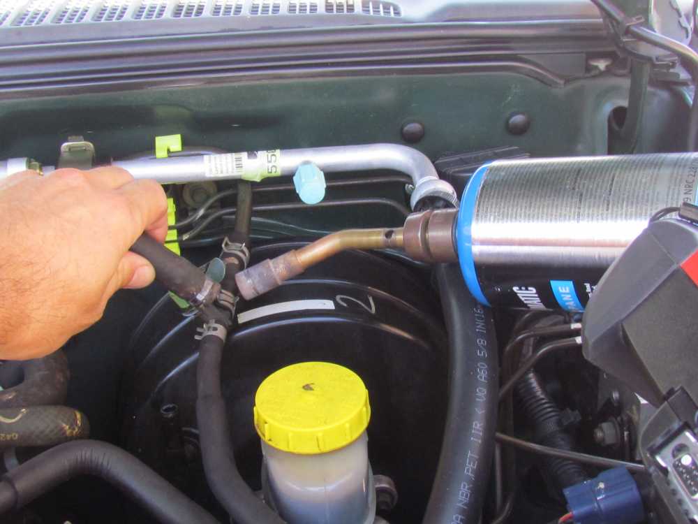

Generally, I use the brake booster vacuum line to test my AFS/O2 sensors since it is usually easy to get to and it is large. When you disconnect yours, make sure there isn't a check valve between you and the intake manifold.
I put propane right into the brake booster vacuum line that goes into the intake. Your AFS/O2 sensors should quickly go rich. Once they do, I remove propane and cover hose with thumb and let the engine go back to 'normal'. I then remove my thumb allowing atmospheric air into the intake via the brake booster hose. Your AFS/O2 sensors should go lean.
I think you said you have a simple scanner and DVOM. When I do this test on a scanner, I prefer a graph display to view the sensor's response time, be sure to reduce the number of PIDs displayed, allowing a better data refresh rate. But, the best way to determine response time is via an o-scope. But, I think you said you don't have that.
If you look at the attached picture, you'll see me directing propane right into the brake booster vacuum hose. Don't let the picture fool you since there is an EVAP hose right underneath my hands. ScannerDanner videos will go into way more detail.
Best of luck. Your persistence will pay off.

I'm kind of afraid using carb cleaner onto the brake booster vacuum hose will damage the electronic throttle body, should I be concerned? Can't think of any entry point after the throttle body tough... thanks for the picture and the encouragement!

hi again firstly you have nothing to worry about regarding adding carb clean to richen the mixture and prove or disprove that your 0/2 sensor is functional when pegged at 0 ,you will not hurt or damage anything as I mentioned before its only air mass meters that we avoid contact with
If when added the front 0/2 goes full rich you should at this moment move away from the worry that you have a wiring issue !

Hi again ,well first before I forget i made a mistake ! I remembered that some scan tools include atmospheric presure in readings ! So we all live at 1 bar 14ish psi so on your tool we need to take that away ,it was a passing comment from an instructor on a training day at it just hit me sorry sorry about that my tool shows map in kpa or I use a gauge and you want to see 20 ingh on a good engine ,so guessing that's 7 psi on yours is about 14inhg of vacuume so a bit low .. do you have a vacuume gauge ?
So a couple of things just to be sure when you next take a capture/ screen shot can you include the loop status . ,so my thought is for sure that when the trim gets really high it drops out of closed loop (which is when the ecm is using the o/2 signals for fuel trim )
When you added fuel to the booster hose as soon as you pull it off you create a vacuume leak so do remember to squirt in the fuel and close the pipe with your thumb or reconnect imidiatly ,any chance you could repeat the fuel test give it good 2 seconds worth of a squirt and if you can do it at the manifold so it doesn't have to travel all the way down the pipe ,just want to be sure the test you have done is valid and we can move on just a bit unsure as you had reservations on using fuel that you gave it enough !

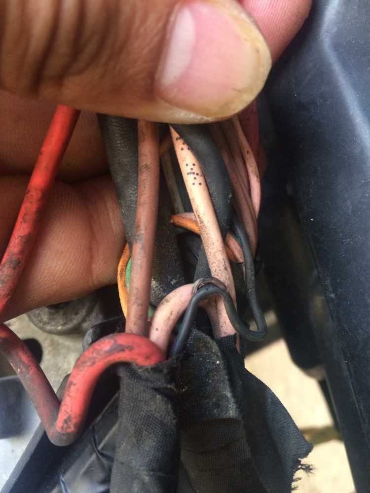

I've been studying wiring diagrams focusing on earth locations and how do they interconnect with each other. It kind of makes more sense now on how they could be related (I wondered how an earth not directly connected to the ECU could affect signals, but as they all interconnect to the Protection Switching Unit, that would kind of make sense).
I saw the ones you mentioned in front of the battery and.. this looks suspicious, right?
I'll take my time to clean most earths I can access, and check on proper cleaning/repairing procedures.
I'm hoping this is it!
PS: ECU has a bolt missing on the body, will look for a replacement nut as well.

I was in the same place trying to work out why the heated rear screen and blower motor effected my 0/2 .as far as I understand if a item say motor has a bad ground it will load the ground with voltage ,as all grounds are connected it will / can effect anything connected ,have a look at danner video on bad block ground I think the engine was charged with 9 volts worth a watch .
The wires you show defiantly look bad ,is there melting on some ?
when you clean them just unbolt use some sandpaper or Emory cloth and make them bright and bolt back up ,don't forget what I mentioned about using the jump lead as a temporary ground from battery neg post to the engine block see if it prevents the problem and then repeat with it attached to the Ecu ground to bat neg
