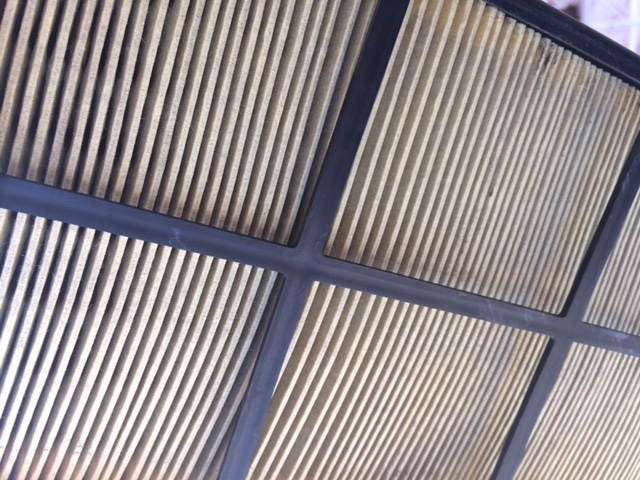

When trying to add carb clean, I expected a lean response in both O2s as soon as I disconnected the hose. Instead, I noticed like the car was able to breath better (no hissing on the hose disconnected). Revs and Intake PSI seemed to be more consistent with the hose off. That made me question the air filter condition, so I opened the box, took filter out, and, although it seems to be OK, the fit seems to be too tight once I try to close the box. Can that be restricting air intake?

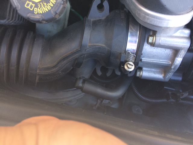

Air filter state and the hose I've been using to add carb clean / inducing vacuum leak:

9 years 7 months ago #7982 by ChrisG
Just looking through all the info at the moment so much better thanks just a quick question will reply on rest when I get home but this hose looks like a crank case breather hose? And that's before the throttle body ? Sorry can't see the hole Inlet , did the hose have suction and did you spray in small hose or the big inlet ?

I did spray in the small hose. To be honest I'm not sure what is that hose for, it has very little suction, and goes from the air intake hose (the one that connects air filter box to throttle body) to the back of the intake manifold (plenum?).
That's the hose I've found that bypassed the throttle body due to my (absurd?) fear of spraying carb clean through the throttle.
Let me know if i should find a different entry way for carb clean. Maybe through the air filter box? Throttle body hose is almost impossible to disconnect without removing the air filter box anyway.

9 years 7 months ago #7986 by ChrisG
Couple of quick questions
When you said in one section you left the hose disconected for a little while was this the small hose?

9 years 7 months ago #7988 by albertdrake
Replied by albertdrake on topic Renault Clio III 2007 1.6L 16V no O2 sensor signal
Yup, that was that small hose...
