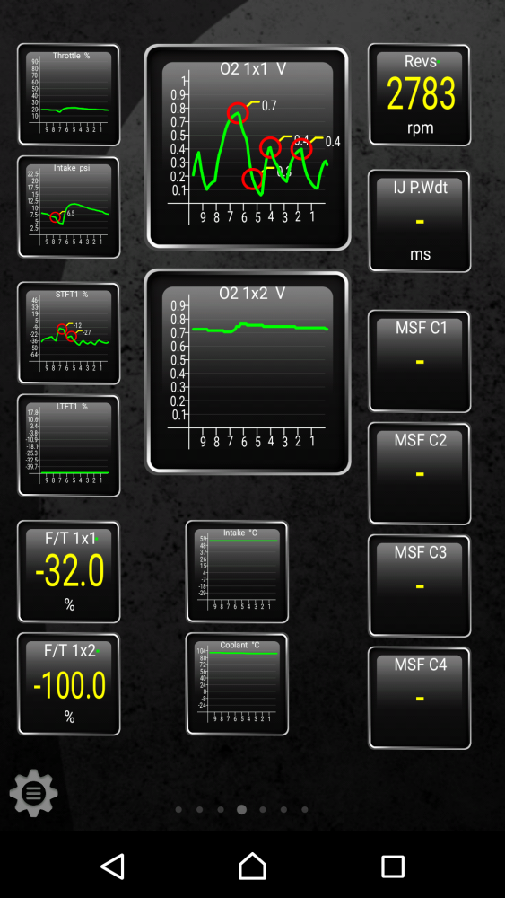

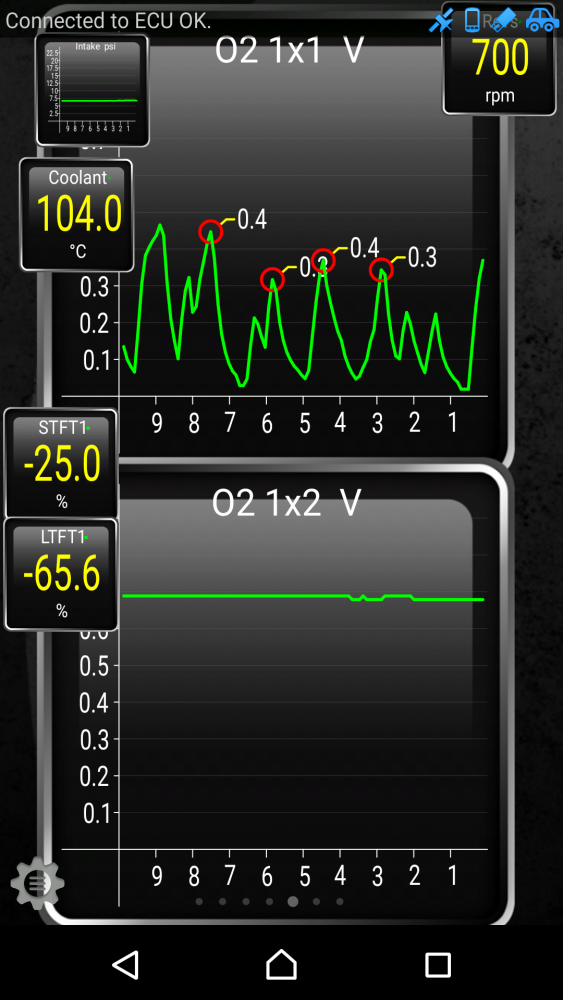

Now I'm struggling with a fuel trim related issue: apparently if I leave the car idling, the LTFT goes slowly negative until it reaches about -60% and this in turn makes the car sluggish if I use throttle above "average".
Once it gets this low, the car starts misfiring (P0300).
There is a PID indicating that the fuel trim associated with the rear o2 is -100%, I was thinking the voltage of 700mv of the downstream sensor is being taken as RICH, thus the PCM trying to remove fuel?
This was the issue I had before the whole distribution mess started.
I already fitted new "calibrated to spec" spark plugs, o2s are new.
I'm hoping this to be more of a basic issue...? Should I open a new thread for this...?

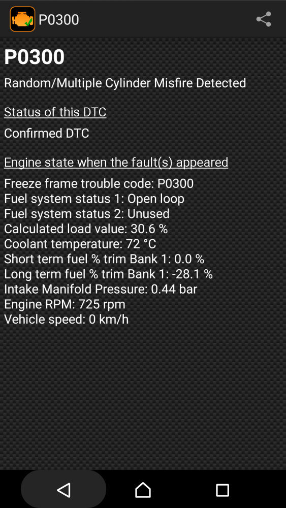

Replied by albertdrake on topic Renault Clio III 2007 1.6L 16V no O2 sensor signal
Freeze frame for the P0300:
9 years 7 months ago #7854 by ChrisG
Oh no you have the same problem ! Nothing has changed
I thing my rear 0/2 pid also says -100% I think this is normal as ours runs good
There is no doubt that the car is pulling fuel away which creates your misfire code ,clearly in your last shot both o/2s are not agreeing !
I can't tell from your screen shot how long a time it covers but to be pulling away that amount of fuel when your front is showing lean is crazy how long a time does your pic/ screen shot cover ?
Is there any way your wiring harness could be plugged in the wrong way round ? Front in rear and rear in front ?conector

9 years 7 months ago #7855 by albertdrake
Don't think it's about the harness connected backwards, the rear o2 connector is waaaay longer to reach the sensor.
I'd say the time span of the screenshot is about 30s.
Yeah, feel the same way: all the heater issue seems to be a useless (well, lets say learning) detour.
Only thing I know is that sensors not agreeing with each other could cause an issue on Renault's thanks to the "double loop" feature.
Will try to do a better data capture tonight to see if other ideas come up!
9 years 7 months ago #7856 by ChrisG
Yeah sorry it wouldn't have given what you have
Can you delete the fuel data with your scan tool so your ltft goes to 0 sorry may have asked before ?
Well let's just say the double loop thing is causing your problem because the rear 0/2 is staying Rich ,if you short the rear signal wire to ground (while all plugged in using a jumper lead or test light with car running )pulling on your scan tool rear sensor to 0v ,you should see the fuel trims reduce in negative numbers as its seeing lean now and then go into positive fuel trims

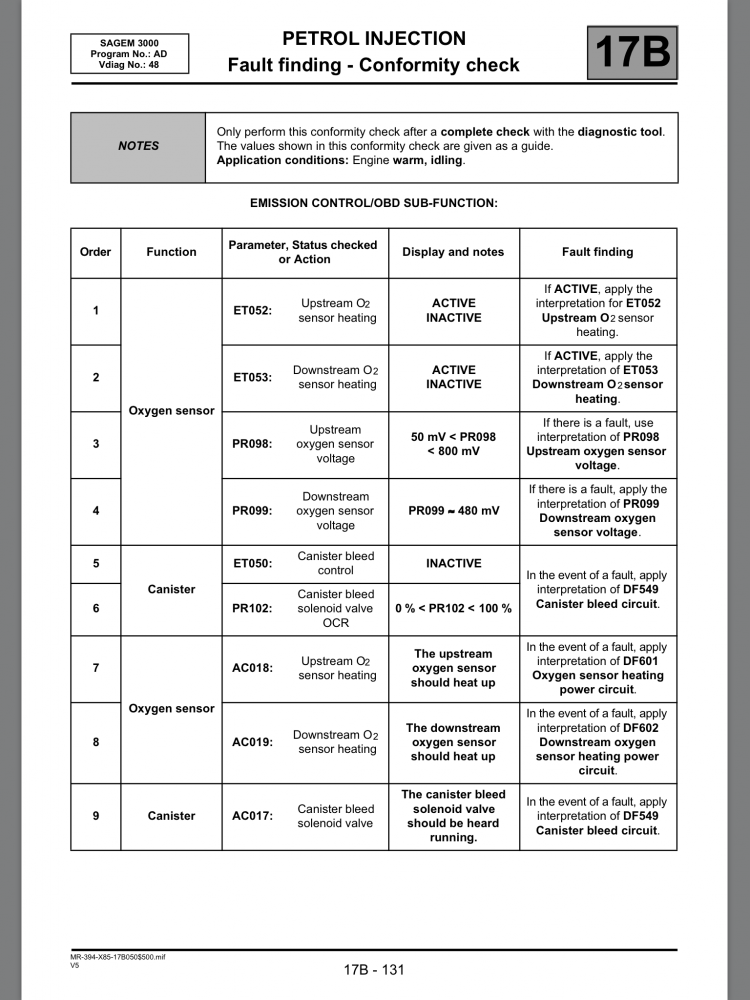

Any resources on what's a normal reading of a rear o2 with a good catalytic activity?
I've been told by another technician that he thinks I have a plugged cat judging from the amount of air getting out from the tail exhaust. Could be...?

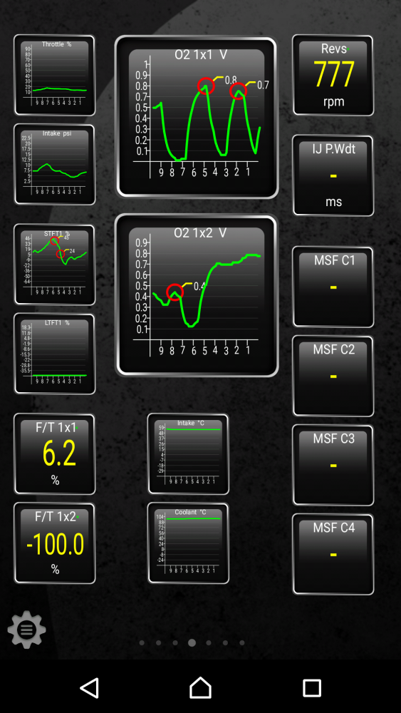

9 years 7 months ago #7863 by ChrisG
If your cat was plugged I would exspect from a map sensed engine ,negative fuel trim numbers which you do have ,as the volume of air it calculates for is incorrect becouse if there's less getting out there is less getting in ,but the fueling stays the same ,hence rich condition but I would have exspected your rear sensor to have been lean ? Maybe I'm wrong on the rear sensor if the rest of the exhaust is blocked ?You could do a back presure test by removing the sensor and putting a presure gauge in the hole it should be less than 1 psi really .
Re your question On your rear 0/2 signal I would exspect around 650mv but we have to be mindful that yours is only slightly higher at 700mv BUT the car had -60 %on the fuel trims
9 years 7 months ago #7865 by ChrisG
Also with a plugged cat your intake vacuume would be low ,if you can borrow the scan tool check from the tec ,as if you remember we questioned the reading from the intake pressure before saying it was to high/ not enough vacuume but then discarded as we think your tool is including atmospheric pressure in its reading ,worth putting a vacuume gauge on the engine for sure if you have one 20 ingh is what we want to see on good engine

9 years 7 months ago #7868 by albertdrake
Had written an update but something went wrong while posting.
Here it is again: from the last test drive.
File Attachment:
File Name: Screenshot...4-21.png
File Size:0 KB
File Attachment:
File Name: Screenshot...5-01.png
File Size:0 KB
My thinking was almost like yours, except for the part where you expected lean at the rear o2.
With a plugged/degraded cat, it doesn't convert well, rear o2 reads high voltage (thinking its rich), PCM reads that and tries to reduce fuel gradually until the point where it's outside spec, creates the misfire due to lean mixture?
Also I noticed that the throttle body is back to a max of 60%, it was corrected with the better scan tool to have a max of 89%. Maybe it's some kind of failure mode?
Will go with the tech to get better scan data and do my best to confirm cat/exhaust issues. I might have to go to an exhaust shop to see if there is back pressure.
That MAP seems suspicious too, but I did some graphing and it seems to correlate with throttle position. Tech used carb cleaner around intake manifold and didn't seem to find a vaacum leak.
Oh well...

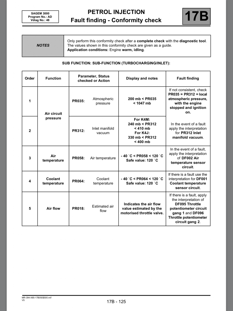

Update: just saw this on expected rear o2 voltage at idling is 480mv.
I guess that means rear o2 is reporting rich?
And MAP reading at idle is expected between 240mb - 410mb.
Freeze frame at idle reported .44bar (440mb). Slightly above the upper limit. Exhaust restriction? Low compression?
I guess I have to figure out how to do a back pressure test. Either I find a gauge or find an alternative method.

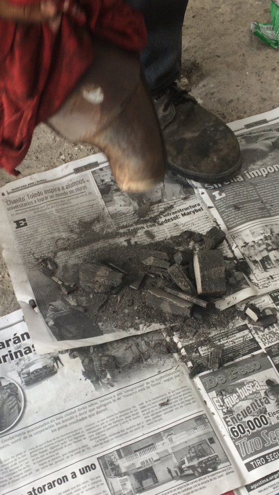

Went to techs shop to see codes in memory. DF436 was there, deleted them. Told him about my theory of plugged cat. He suggested I take the car to an exhaust shop. Took it there.
The guy there checked and said he didn't see anything that suggested plugged cat from underneath. I asked if there was any way I could check from the inside, so he offered to take the cat down to see. Once down, we saw there are two honeycombs. The one on the front side was darker than the one behind. He then suggested he could take only the first one to see if that improved the situation.
On a desperate call (again), I took his suggestion. One hour later, no change at all. Even got codes for both o2s circuits. Deleted them and haven't reappeared yet, but vacuum and rear o2 sensors didn't improve. I'd even say rear o2 reading got slightly worse.
Fuel trims are still stuck negative.
Got back to scan tool tech and told him about that. He then suggested we do some test on Monday (compression test, adding pressure to coolant circuit) to rule out things like blown head gasket or possibly a engine valve damage or even slight timing offset.
Thoughts? Hate myself right now for the bad call on the cat.
Here's a pic of what the guy took off from the cat.
